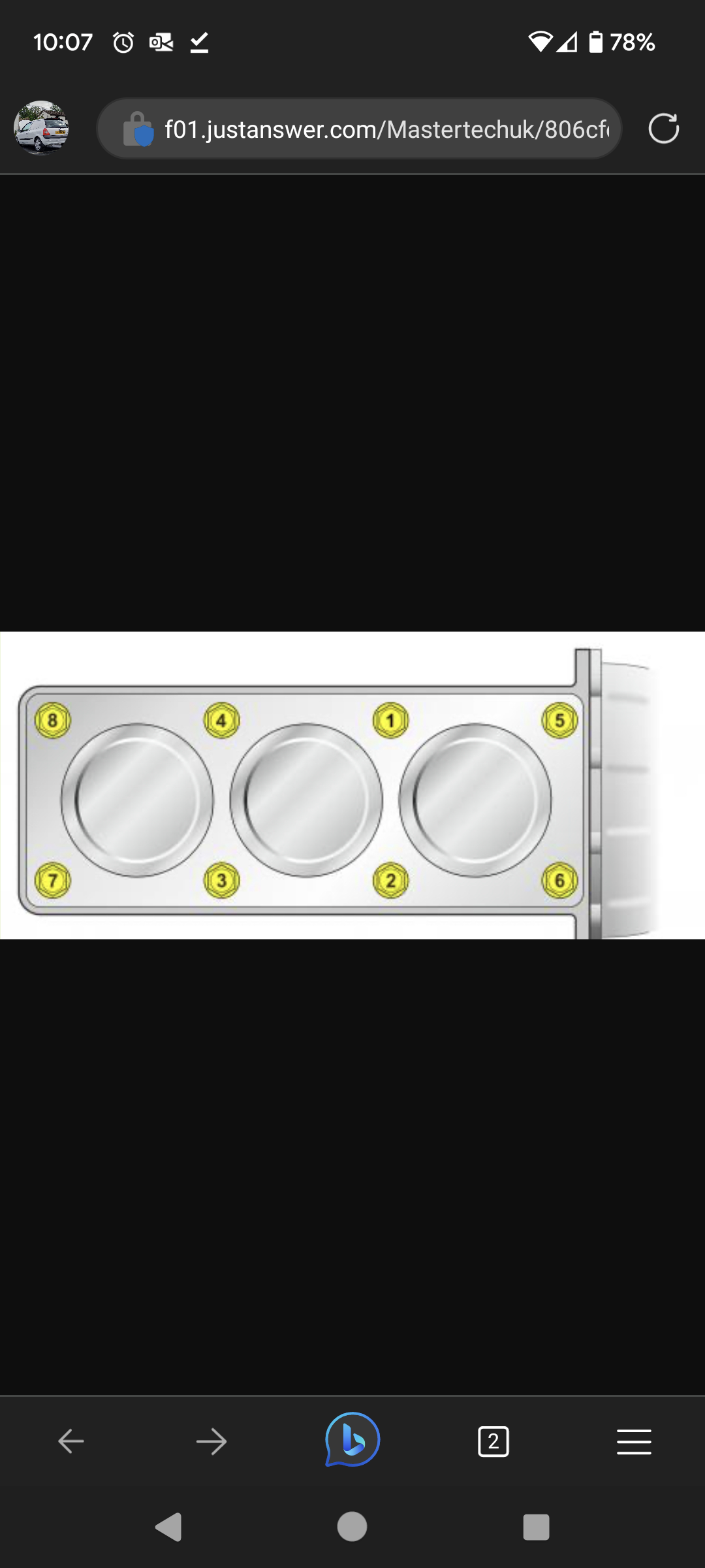

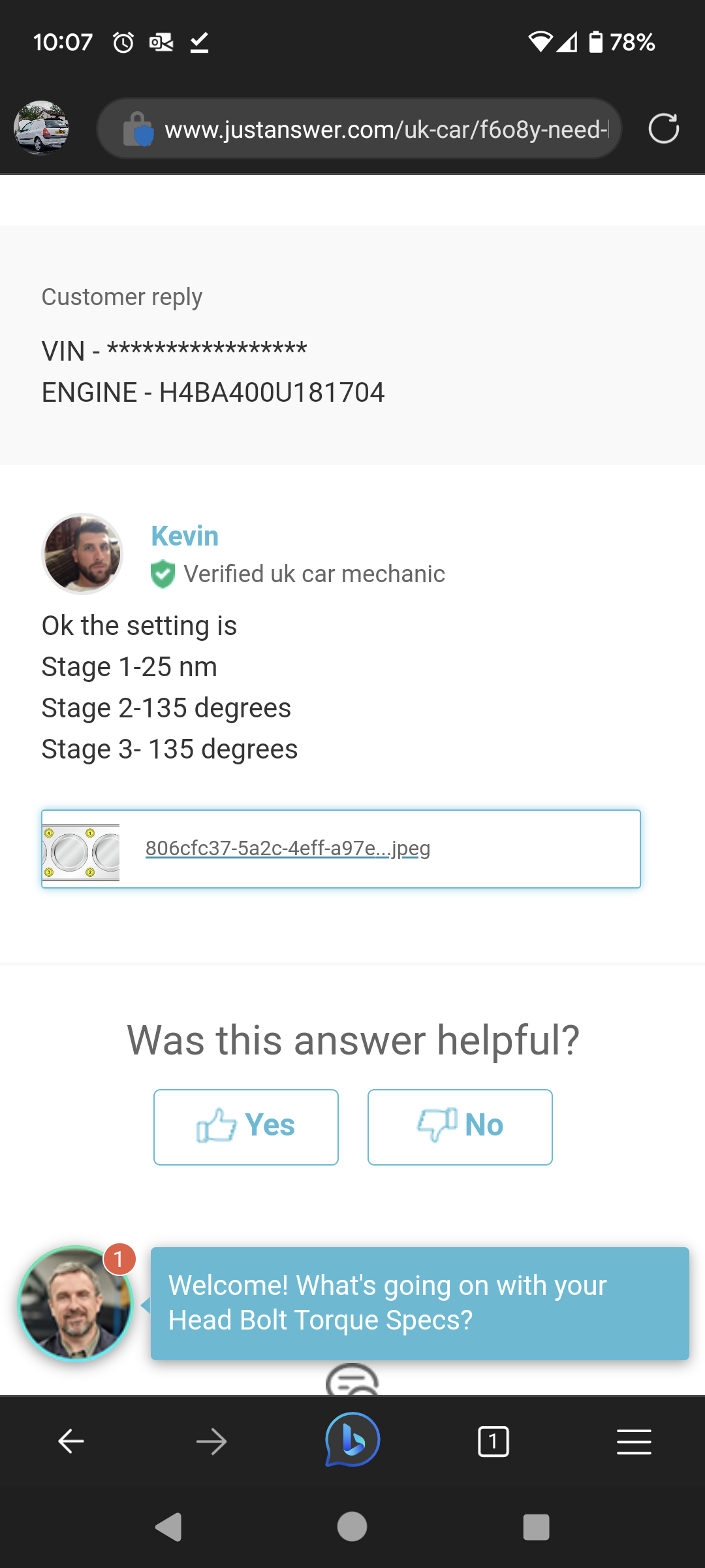

I am looking for the head bolt torque settings for the Renault Clio 4 900cc 3 cylinder. I blew the head gasket and have fitted a new gasket but am battling to find the correct torque settings.
The very first search result in Google gives this...
