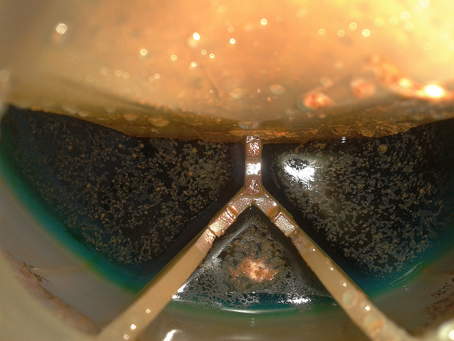

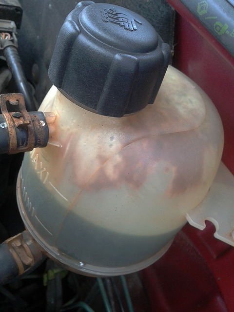

Stuff at top of the tank

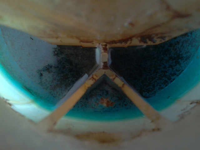

Stuff inside (without flash)
Stuff inside (with flash)

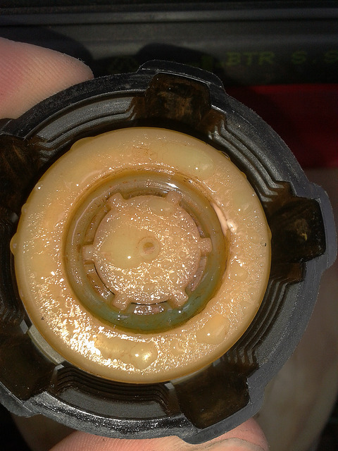

Stuff on the water tank cap

Oil is less dense than water so will always float, even if there's a tiny bit in the system.
My first duty would be to carry out a HG test, make sure its not leaking. Then if that comes back ok, carry out a full and thorough coolant flush, replace it with proper renault stuff, engine oil change and oil filter change. Run it for 100 miles and re-check everything.
