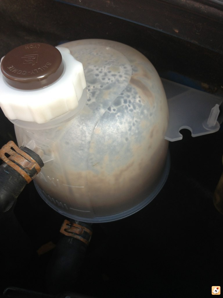

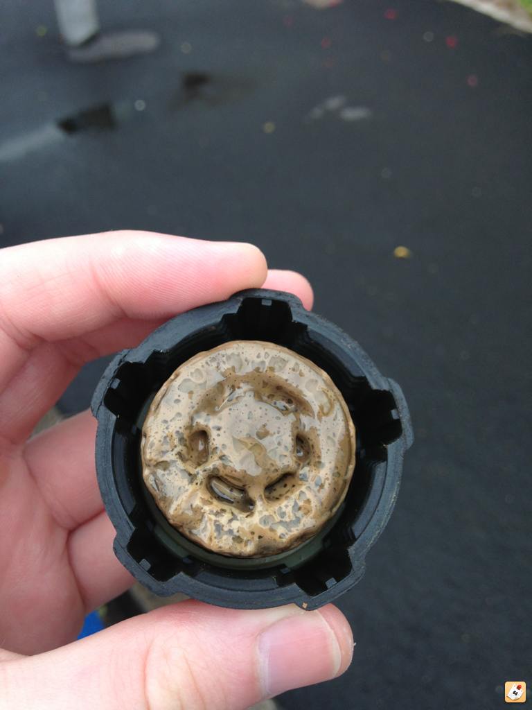

I left everything to cool overnight and checked coolant this morning (bottle is filthy so can't see level easily). When I took off the lid it hissed and there was a gurgle.
Coolant was virtually non existent. Loads of gunk on lid and looks to be some in tank too. Topped up coolant and have only been to town and back so not exceeded 30mph.

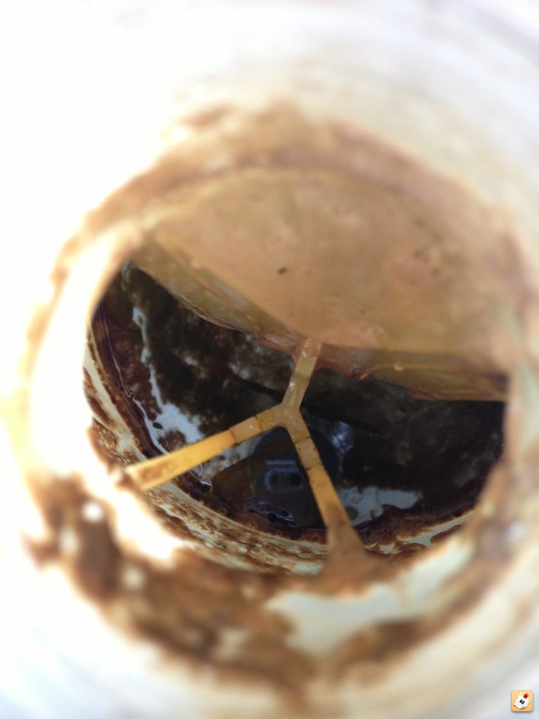

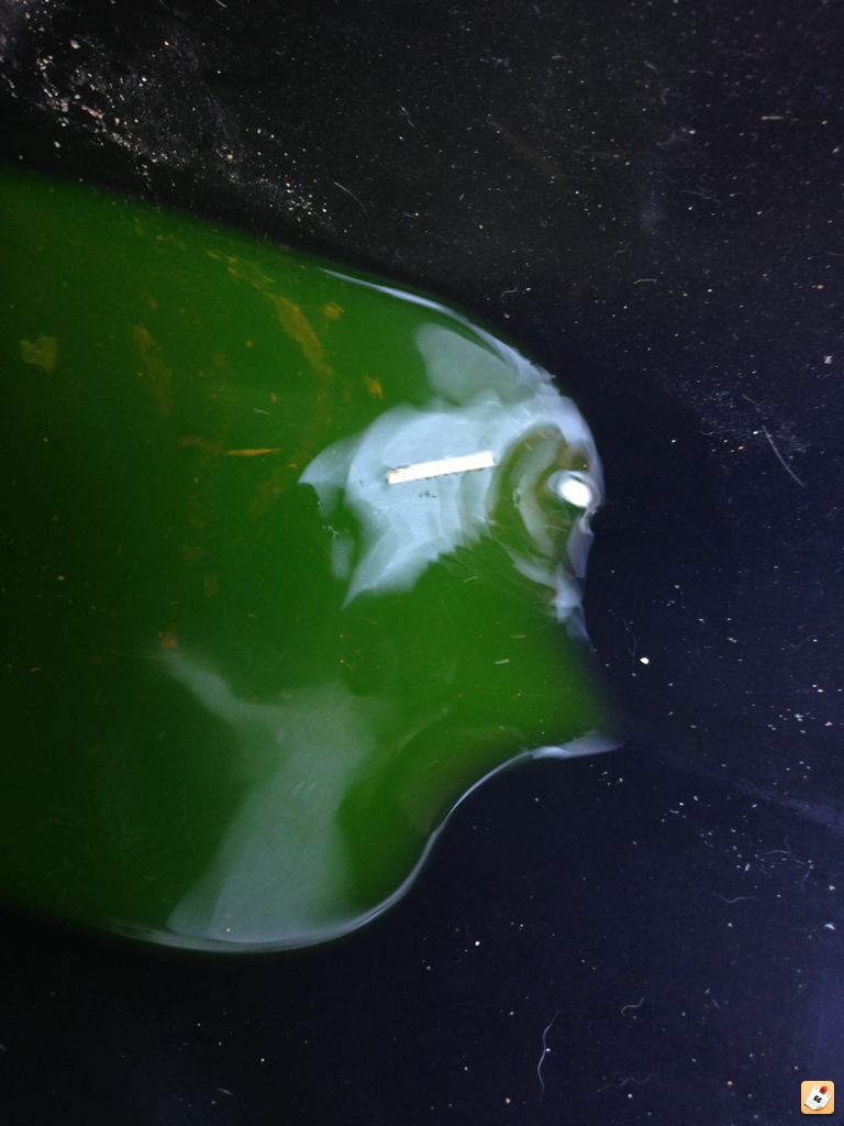

Spent ages yesterday changing the gasket, coolant, and expansion bottle. Everything was all nice and clean. I used some gasket sealant alongside the new gasket and drained and flushed the system the best I could.
The coolant that came out of the bleed valve and wherever else I could get it from seemed pretty clean.

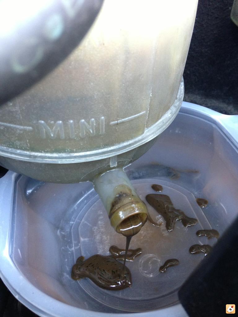

Obviously as oil floats on water the stuff that came out if the tank was a different story:
I got the car up to temp and also bled it and all seemed ok.
However, after a drive to work this morning I've lost most of the coolant. This isn't a surprise as the seal around the thermostat is goosed and I e ordered one from Adam at Renault Wolverhampton. The tank is also s**t up again too.... My nice shiny new tank.... :(
