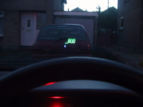

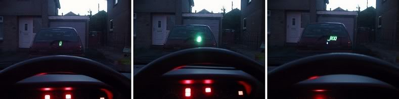

I fitted one of these to my mk1, easy enough once you figure out which wires to tap into. For the speed signal, there is a 3 pin white connector attached to the speedo cable. I think it's the black central wire you need IIRC, for the revs, there is a multi pin connector at the back of the dials for the revcounter, again IIRC, it's the 4th from the end (Maybe pink). I mounted mine permanently under the dash top by cutting out a rectangular hole and gluing the hinged bracket onto the underside. Makes it less visible to thieves and harder to steal. There are 3 brightness settings and different options for displaying revs / speed via digits or LEDs.
Here's a close-up, there is a slight ghosting effect caused by reflections on the inside and outside surfaces of the glass, but isn't really noticeable when driving. There is a tinted sticker with the HUD that is supposed to reduce this but i never bothered applying it. BMWs with HUDs have specially treated glass.
