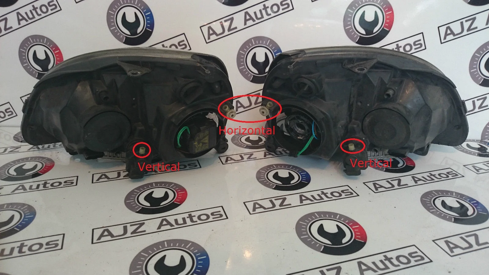

Going to sound like a simpleton here.....how do I adjust my lights!
Just fitted an original set of headlight units and the drivers side basically points at about 2" in front of the car, not ideal.
I know there are adjust screws (the White screw things behind the unit), but aren't these for left/right adjustment? The electric motor adjustment is on "zero" so the highest they will go.

The servos have a height adjustment on them.
For it to be that far out I think something's not right though.

It might be worth twisting out the servos from the back of the light, seeing if the servo rod is connected to the light, or if it's there at all! I had to rebuild one of my servos as the rod had wound right out of it.

Got a picture of how they actually look, the driver's side is definately too low.
Going to have another look tomorrow evening to see if it is the servo adjustment. If the servo is fubar'd then I have the old ones I can try, but is is making a noise, I just couldn't tell if it was moving and it was 12am last night and I wanted to go to sleep!
