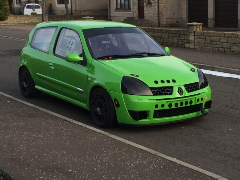

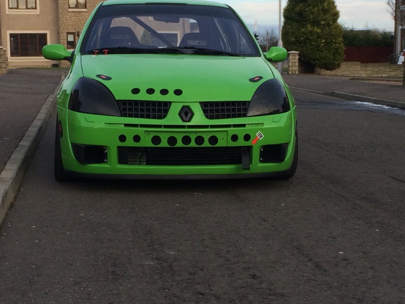

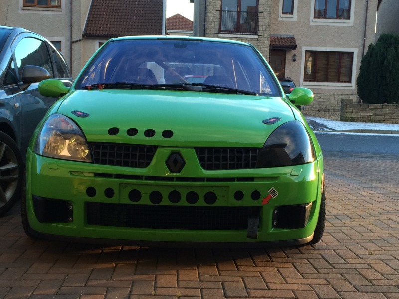

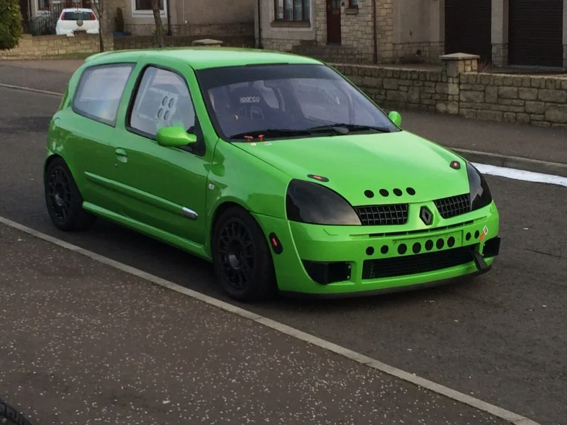

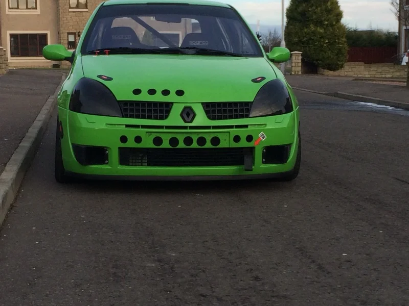

Made some for mine recently , £5 pair of headlights from a breakers gutted them and painted the inside.
Brilliant hanks for the pics, just spent a good half hour fighting with the back of the headlight getting all thw crap out! Just about won
I just took a grinder to the back of them, undid the 3 little torx screws then the inside pulls out. Also I painted the inside of the lights to save them getting stone chipped.
Yeah I'm am going to prime the inside as i have a load of black primer left over then paint the outside as they are not in best condition
