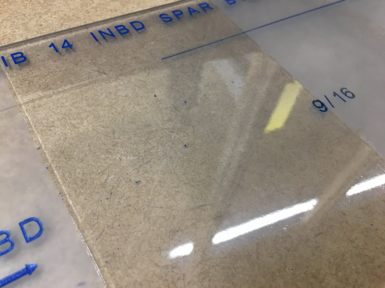

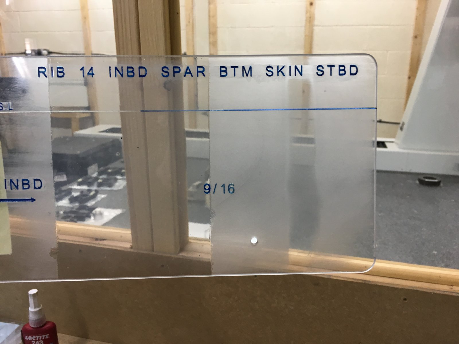

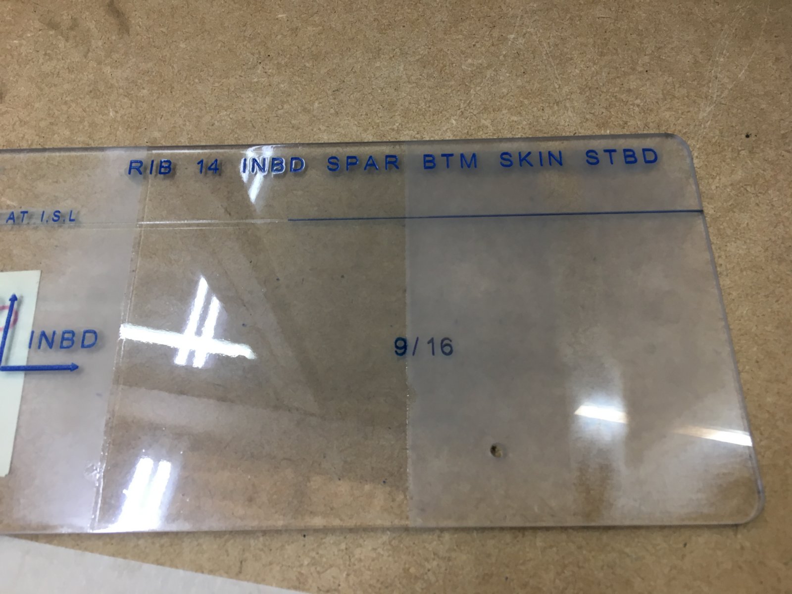

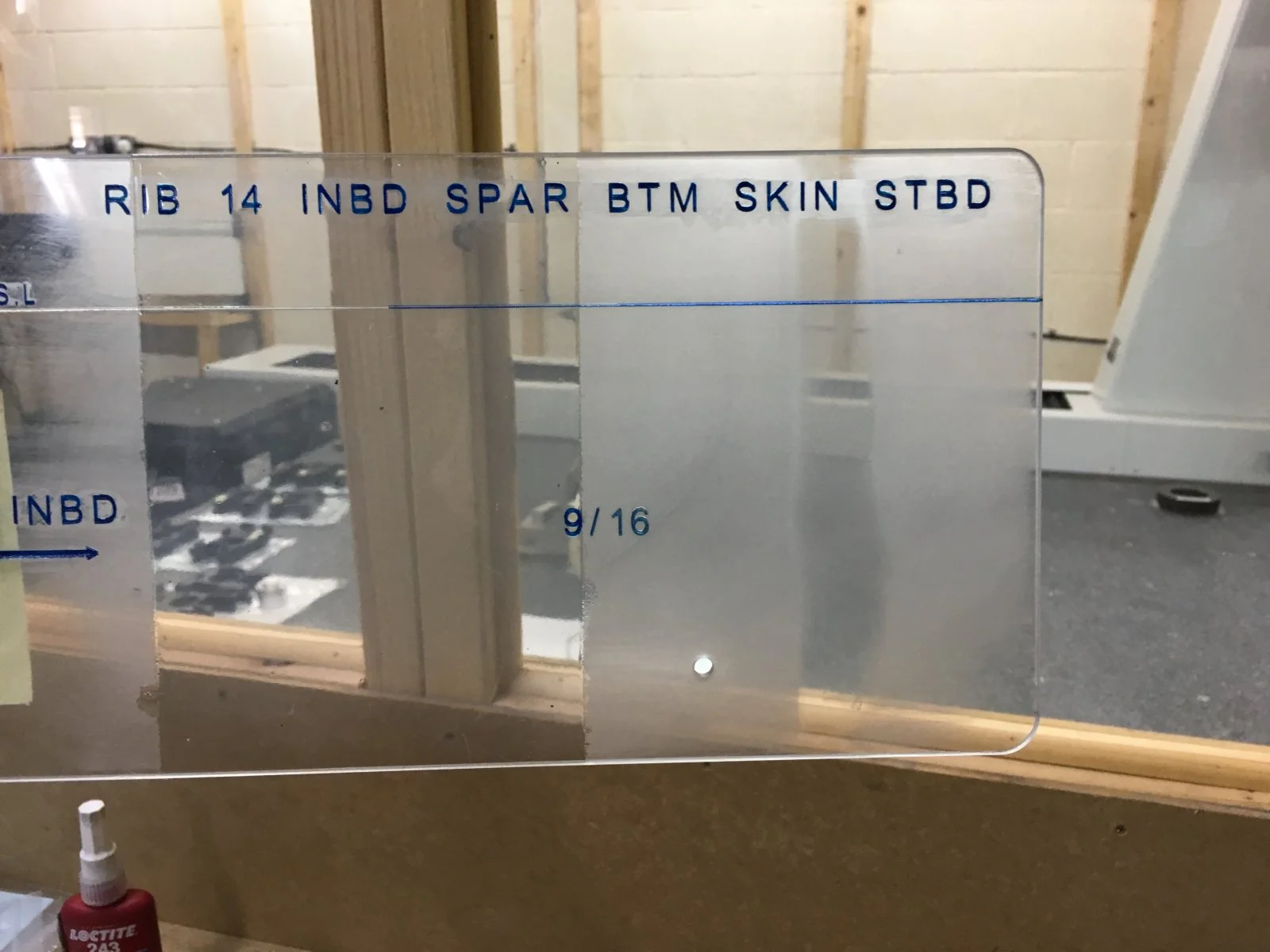

I happened to be testing a piece of polycarbonate in work today. Flatted back with 1200 grit paper then quickly rattle canned.
Straight away it's better but if I took my time and used decent paint it'd have come out perfect.
To be honest even if it comes out with an orange peely finish, you could always flat that back and polish the lacquer
Knuckles
Looks great that mate! Any particular laquer you used?
I just used our local paint companies 2k lacquer. It's the stuff I mentioned above that stays a bit soft for a while.
I don't know whether it was because I rushed or because it was a rattle can but I wouldn't leave the finish as is, if it was headlights and it dried like that I'd flat and polish the lacquer too.
Yeah fair enough. Could always do that and polish the laquer as you say, something like 3000 grit.
Knuckles
Yeah, just to remove the majority of the orange peel if you get any.
