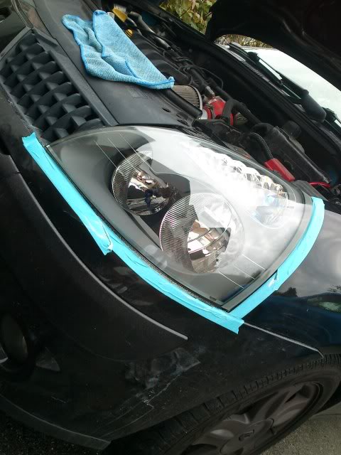

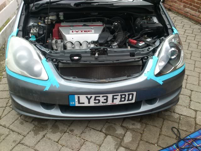

Did a mates CTR and my brothers Clio yesterday with my machine polisher and wet sanding. Came out pretty well for my first time using it
They now have a better reflection than the rest of the car :eek:

I worried that I was going to cloud them up when I was sanding them and then not be able to polish them back to a usable level - I needn't have worried.
If you have cloudy headlights, DO IT.
I thought exactly the same, after sanding them i was oh no i think I've just made them even worse but put some polish on them used the rotary polishing sponge and they looked good
