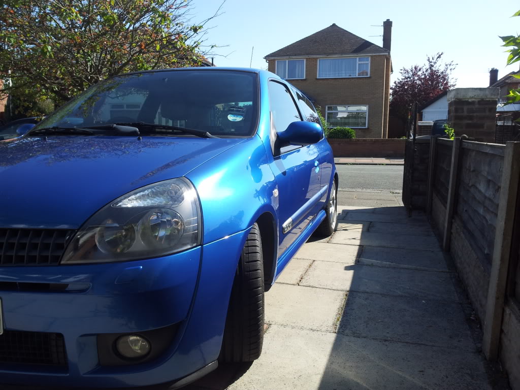

To begin I soaked the wet and dry in some water, here is a pic of how my headlights started off:

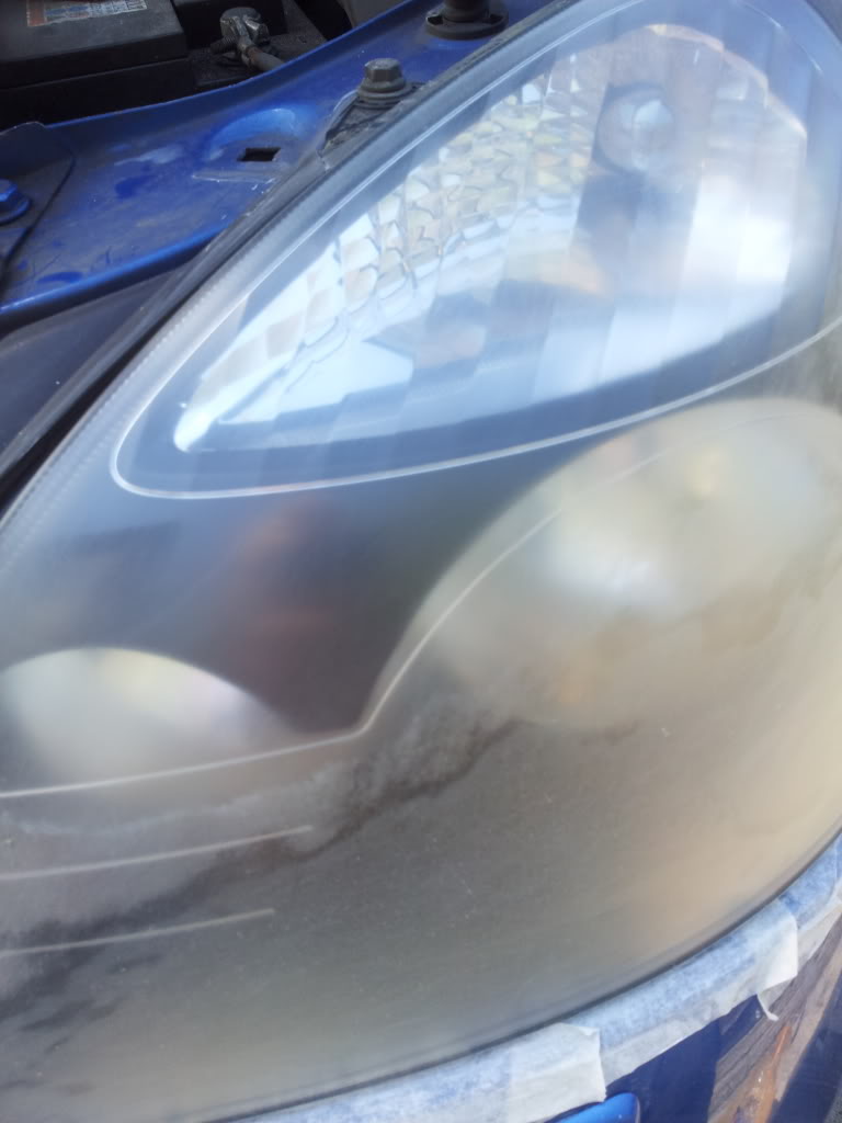

I then started sanding until all the horrid bubbles had disappeared. A top tip here. If you think you have finished sanding, go over it a couple more times, I learnt this the hard way.

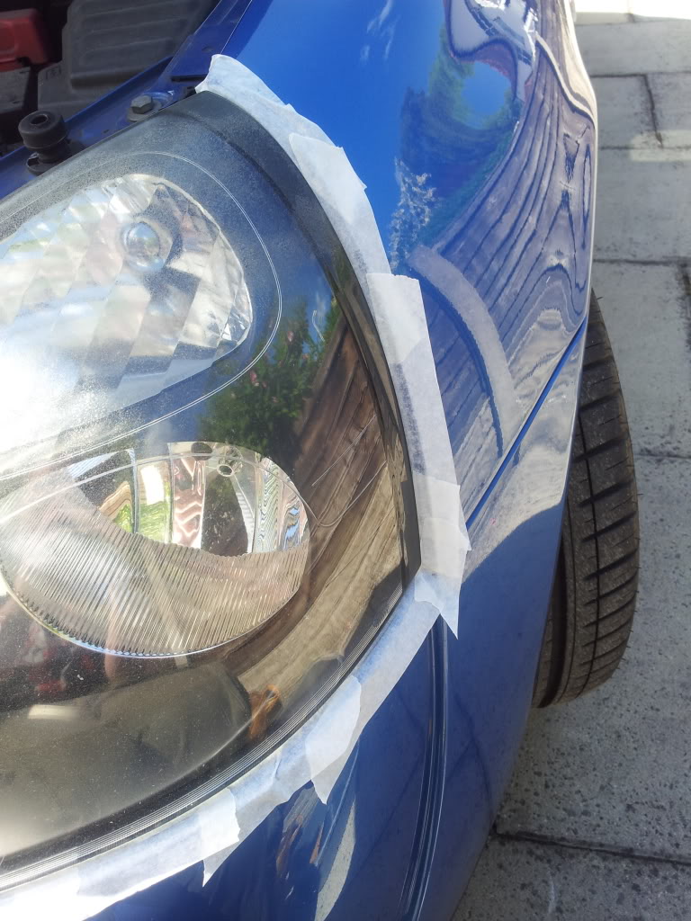

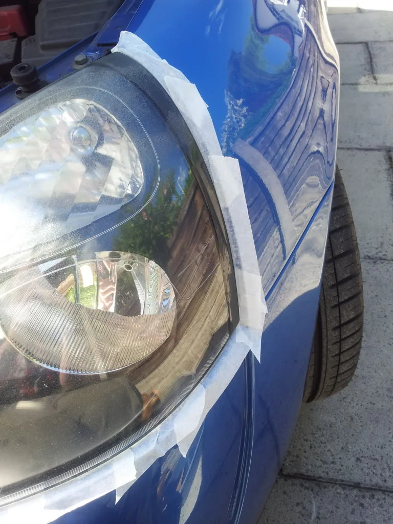

all masked up:

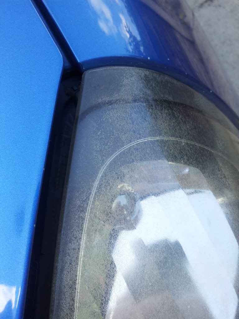

This next pic was it the end of the sanding process, as you can see, its pretty flat at this point

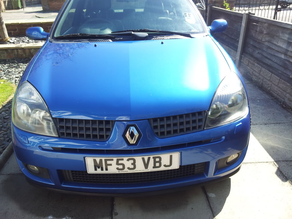

Old Vs New pic here:

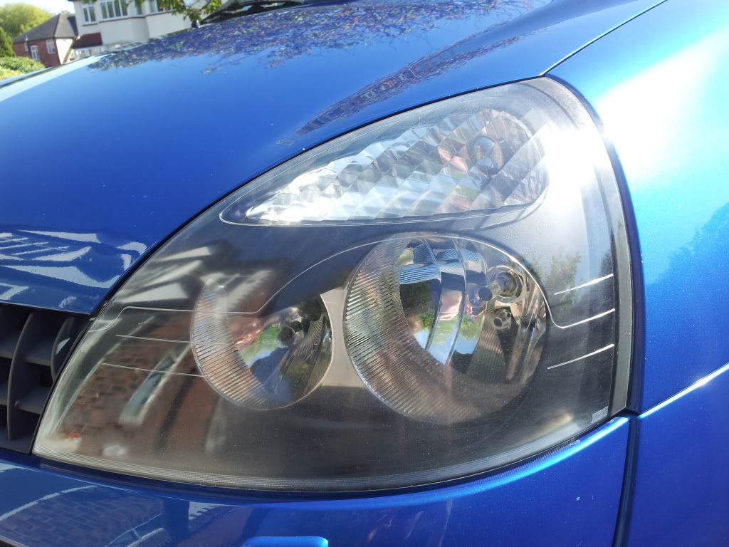

All done:
