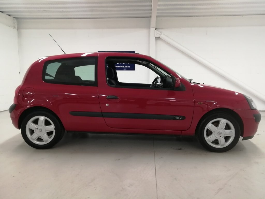

  • 2001 51 plate, 1.2 16v Dynamique
  • 2 owners since new (mother from new, transferred to son when she passed this year, who's now sold to dealer)
  • 15,300 miles
  • Garaged from new

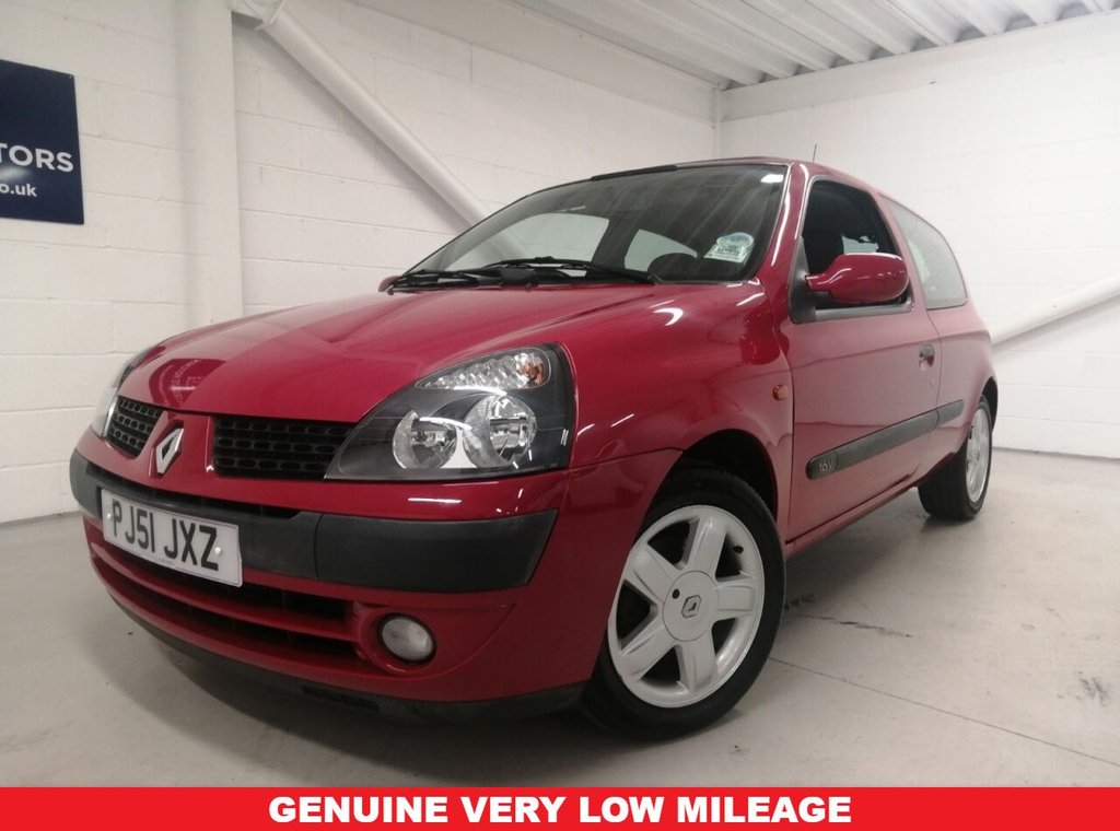

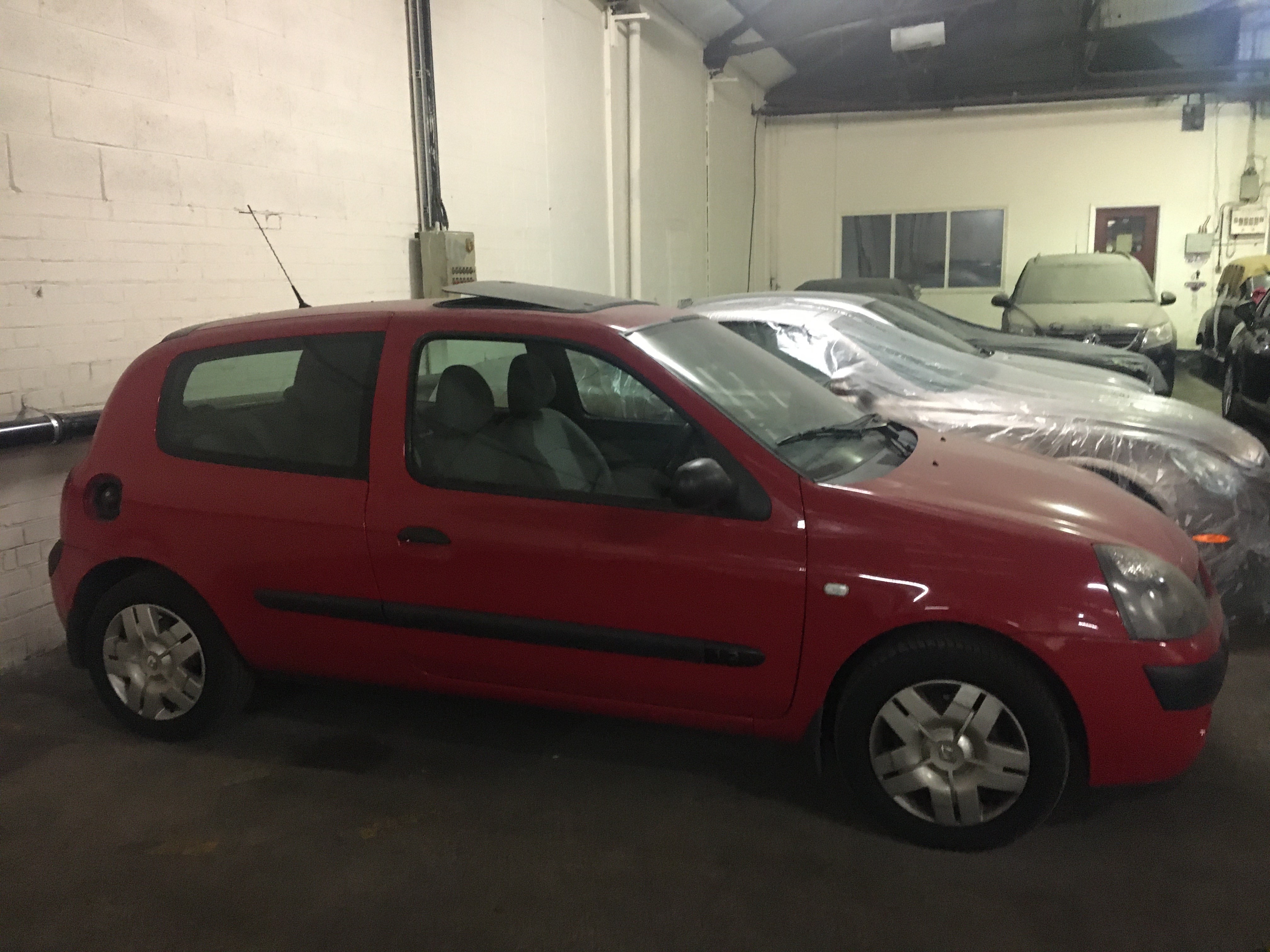

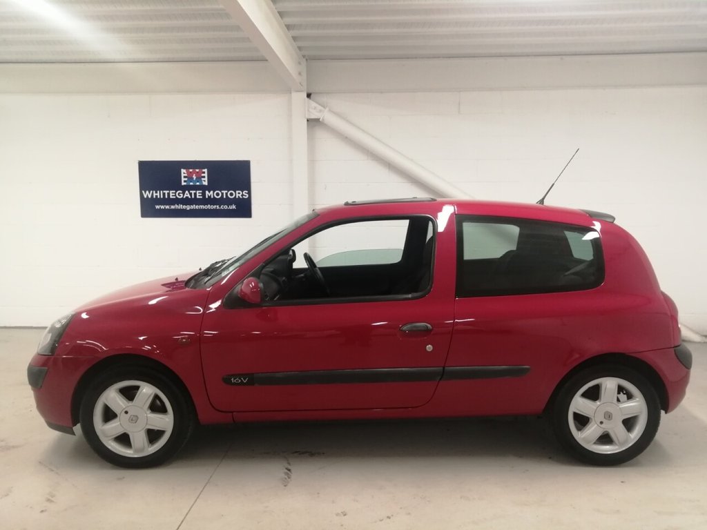

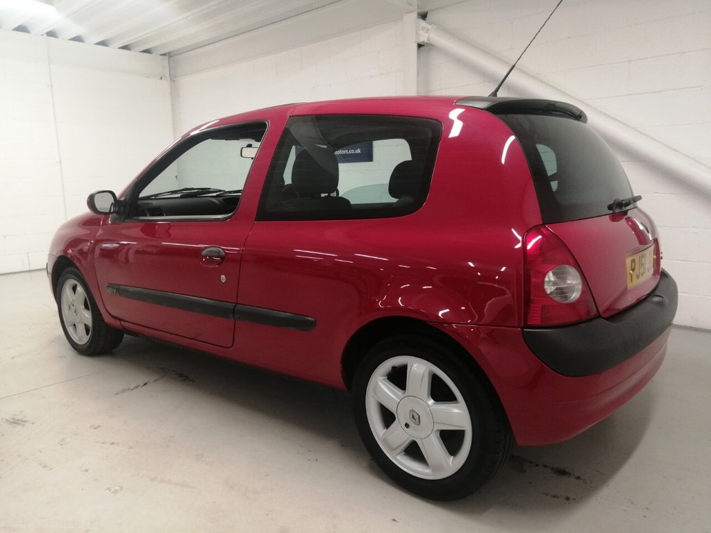

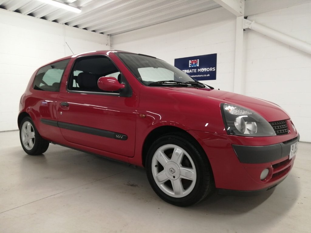

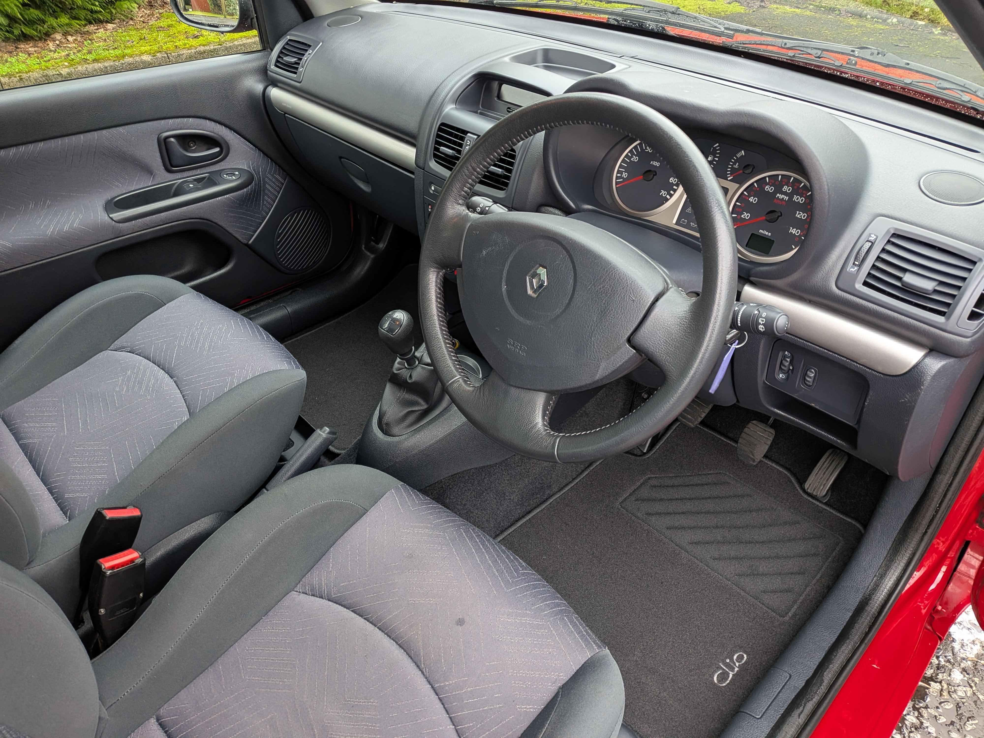

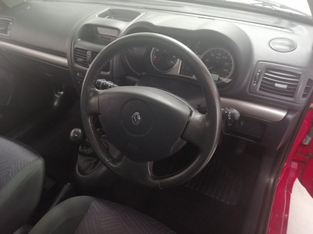

The car didn't have any pics just the placeholder "coming soon" images, I straight away was onto the dealer asked for some pics and basically said if it was as good as it sounded, id put a deposit down, few days later the dealer got the pics over to me and i put a deposit down straight away. - Not the best pics but enough to see the car is an absolute time warp condition!

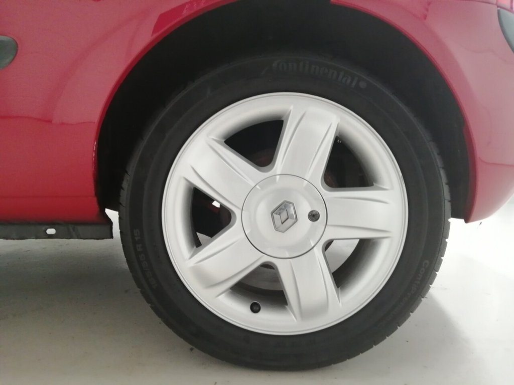

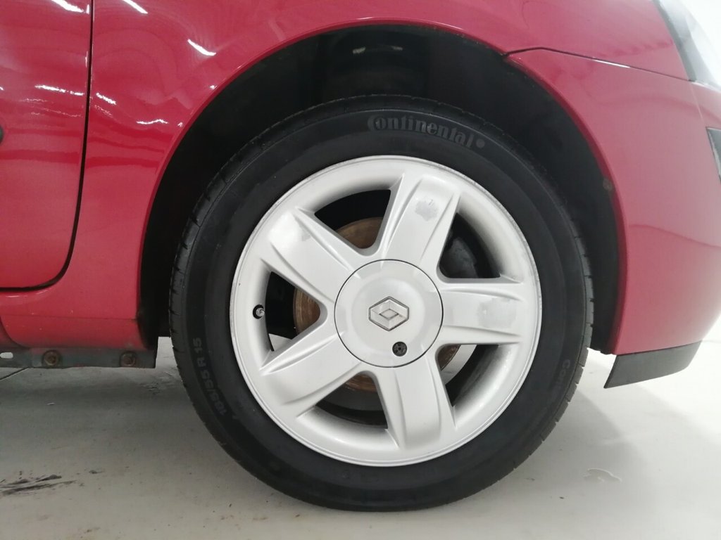

Couple of wheel scuffs to sort out, even has its factory Continental tyres (cool but probably not great!!)

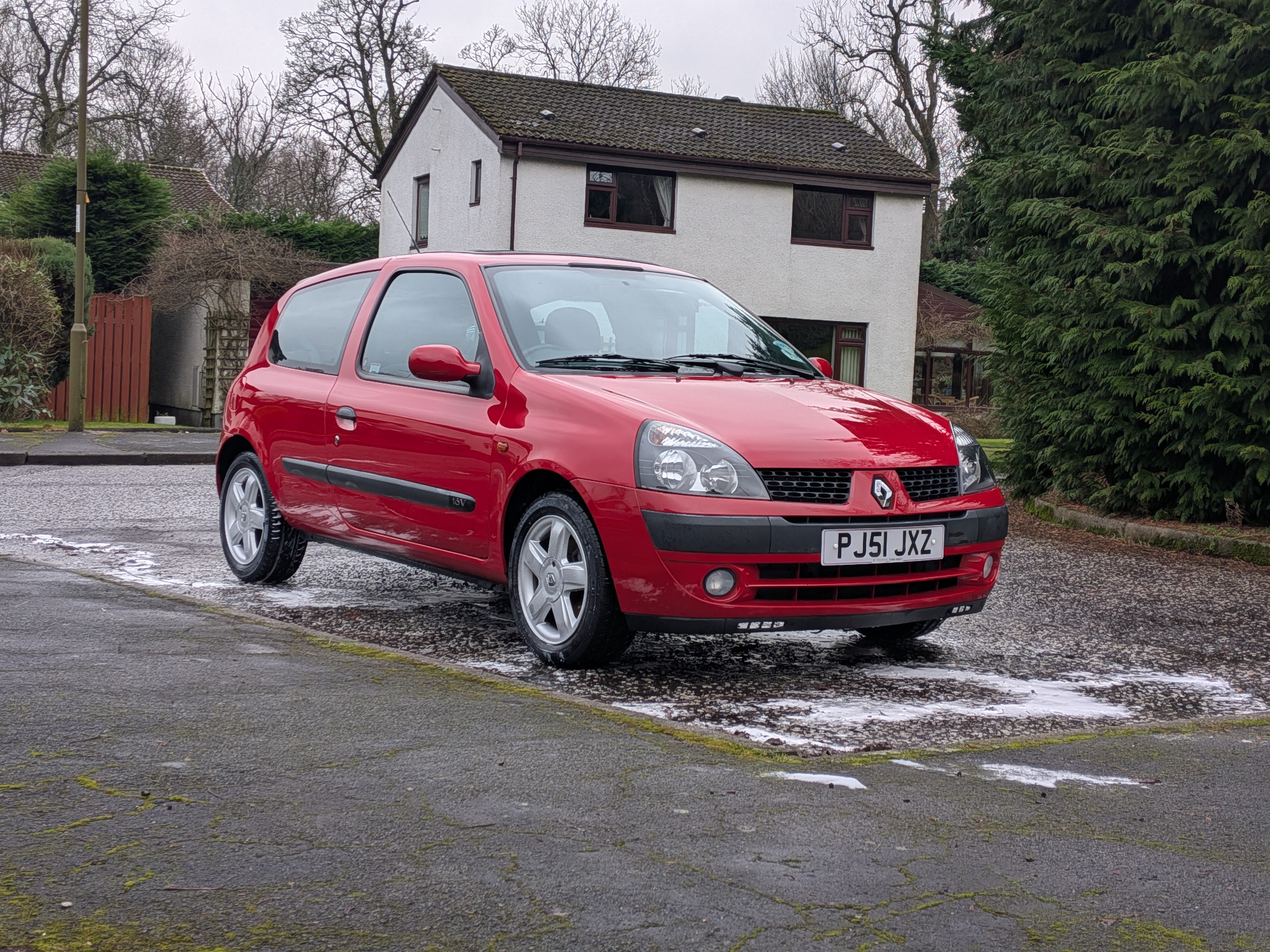

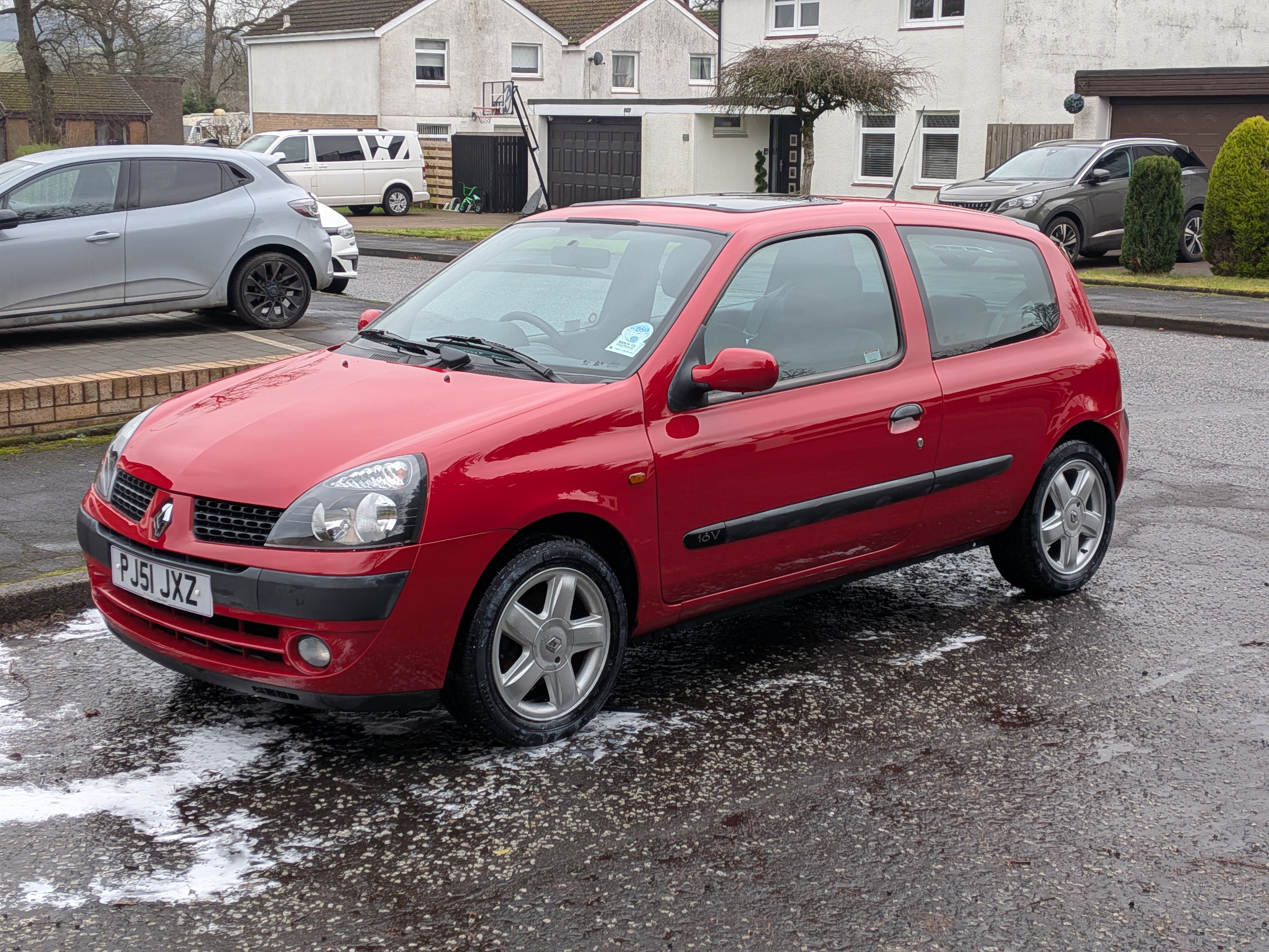

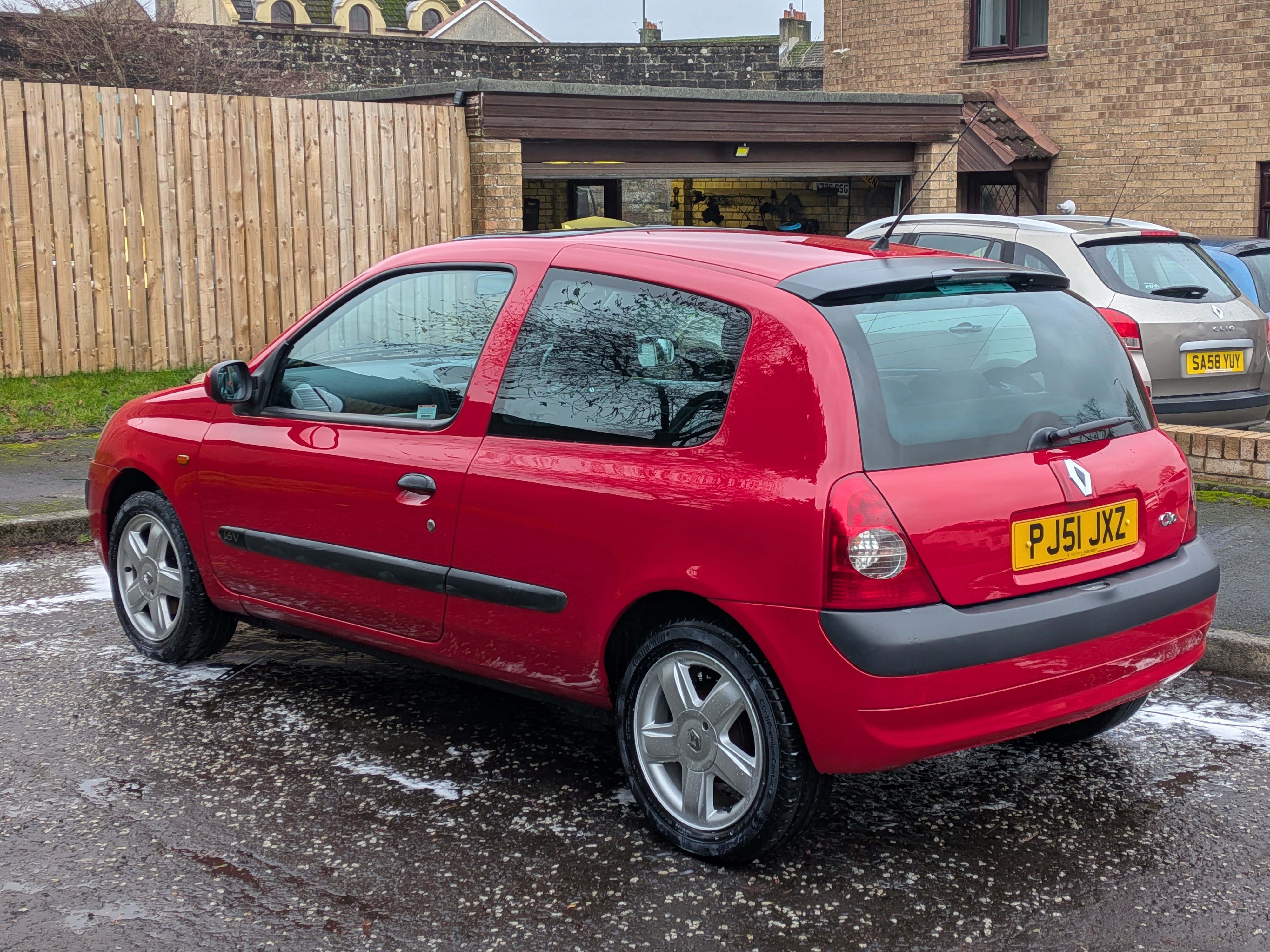

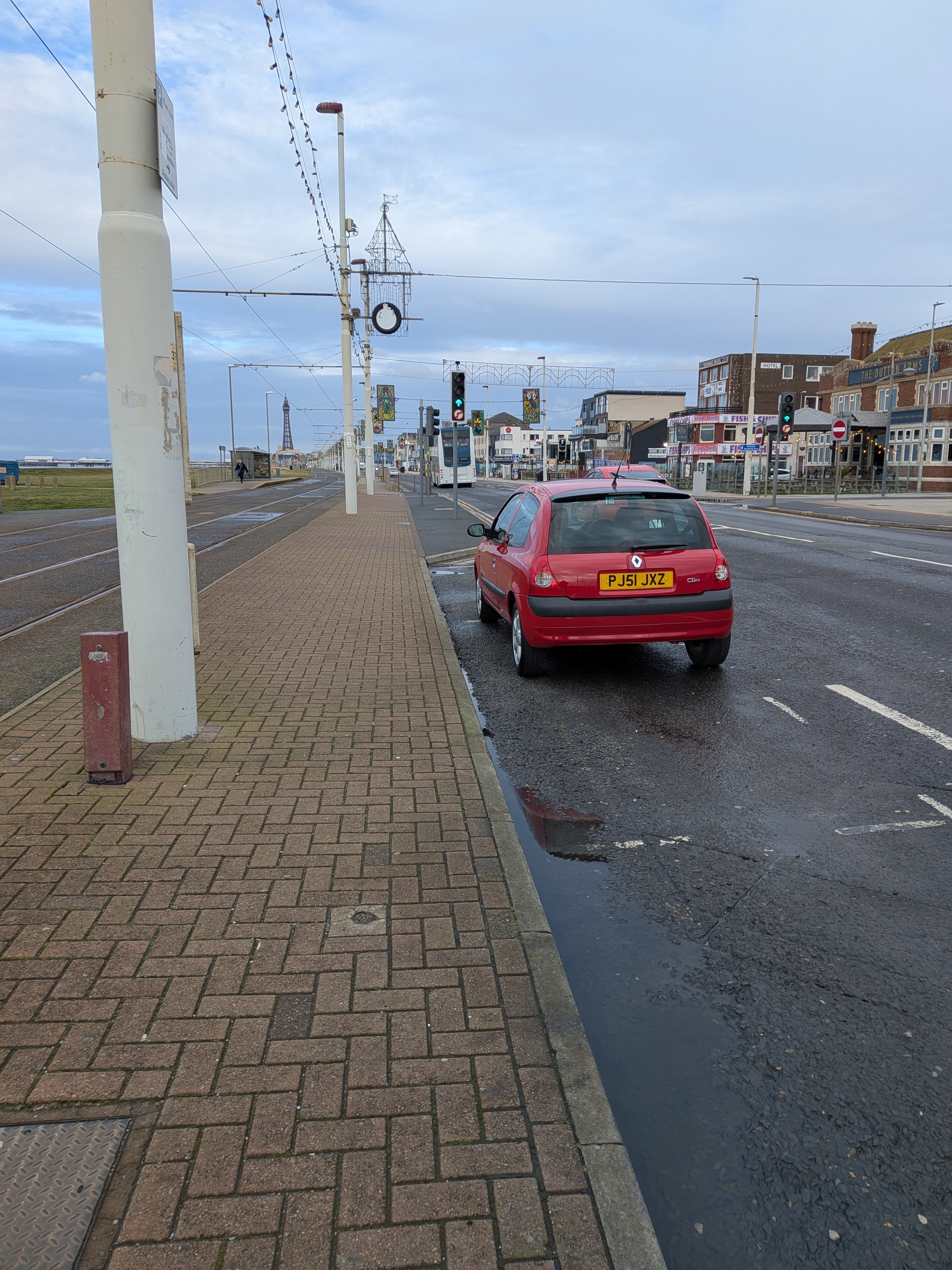

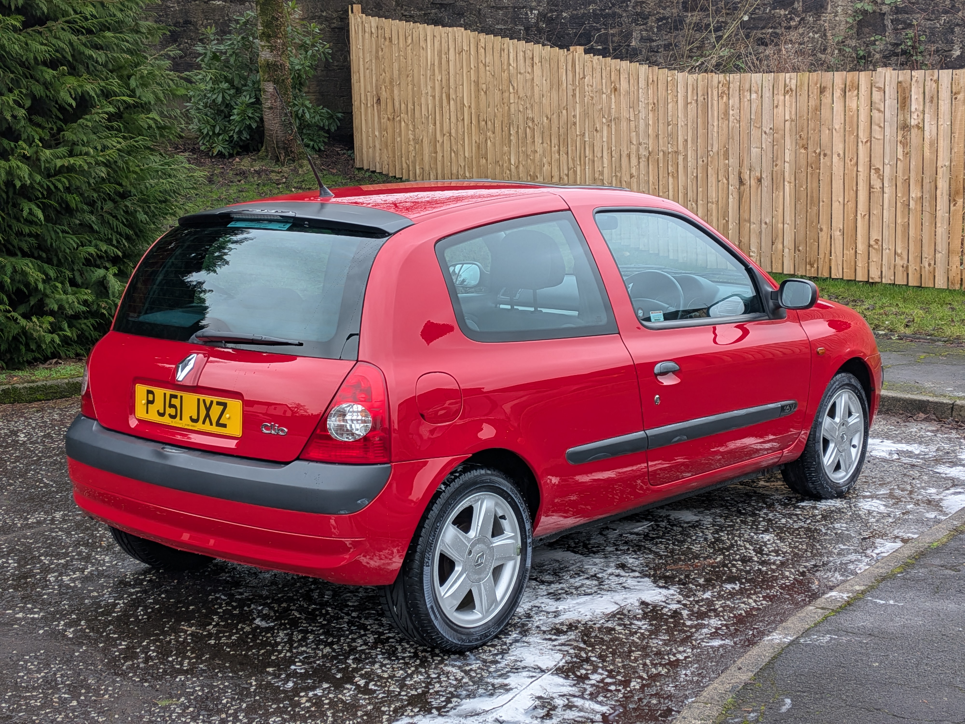

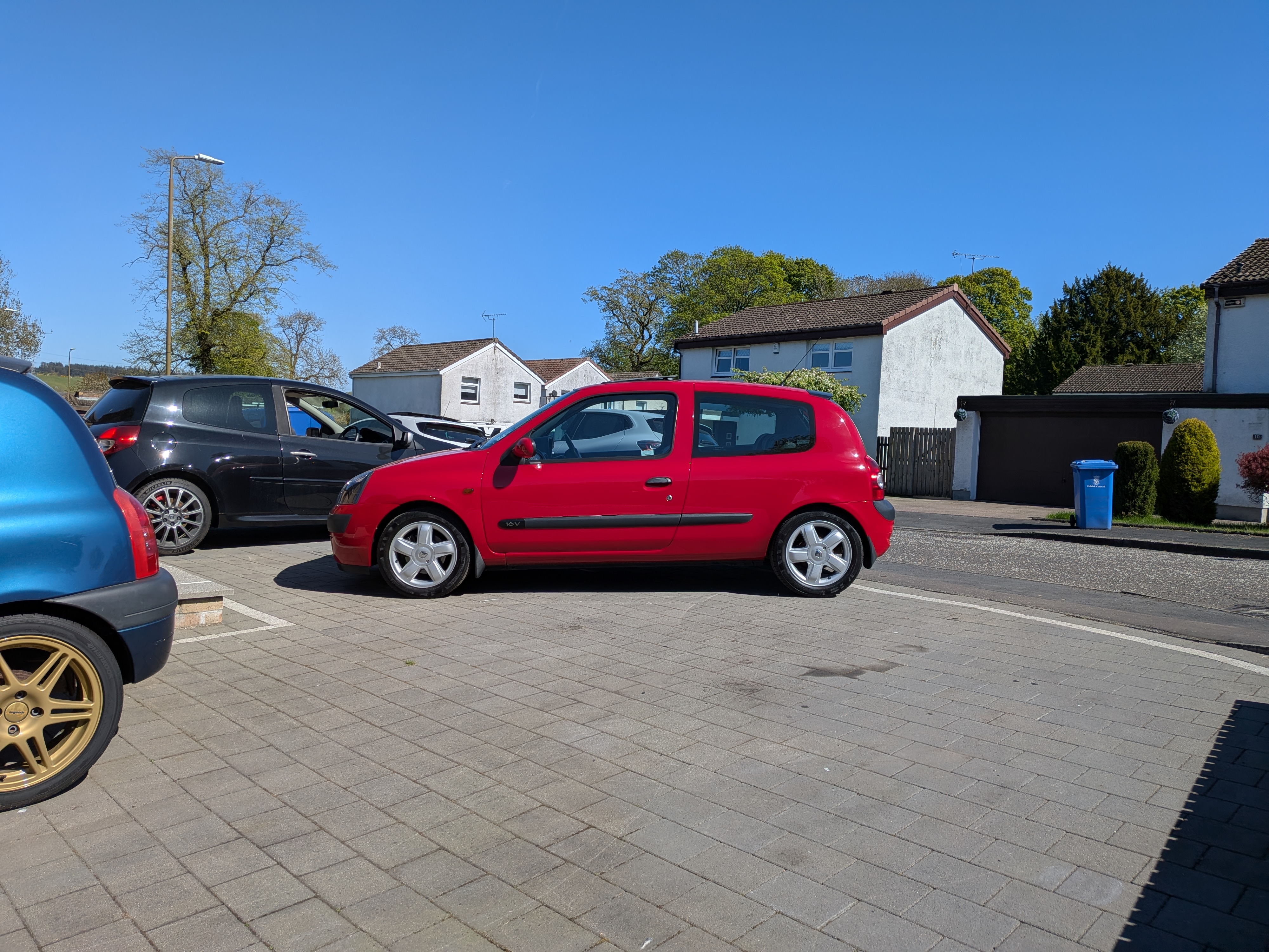

Collected yesterday, no decent pics yet but car is mint. Surprise of the day was that it's capsicum red, not the deep cherry red colour that I assumed it was!
Started the trip up the road, I had let my daughter stay off school and come with me for an adventure, bad move as shes very observant and reads all the road signs....
Years since I've been to Blackpool, oh my god it was never exactly last Vegas but Jesus Christ what a dump. Nostalgic dump none the less...

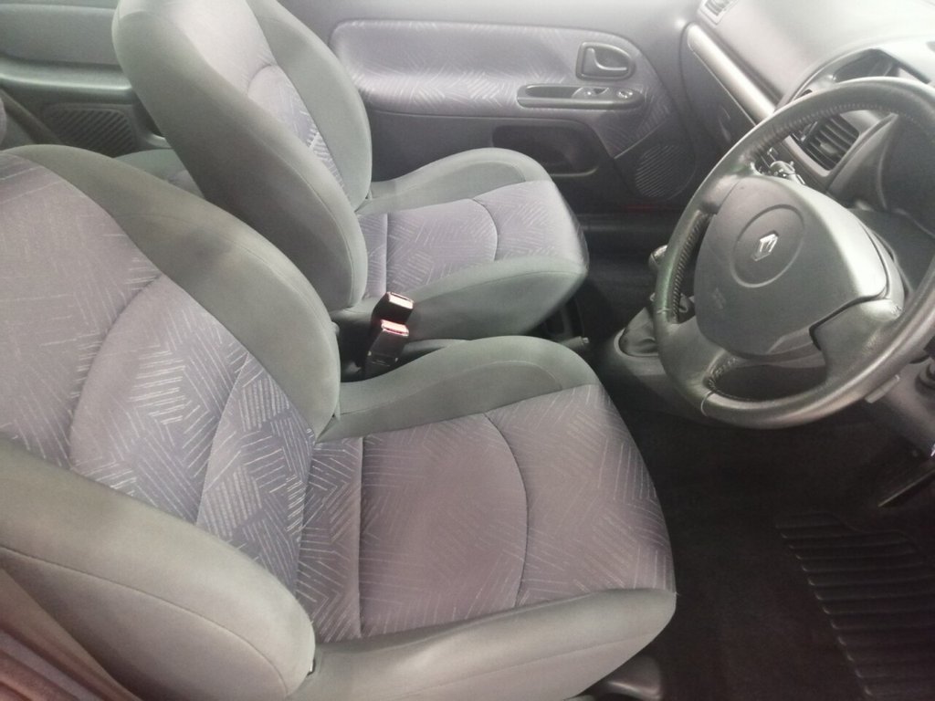

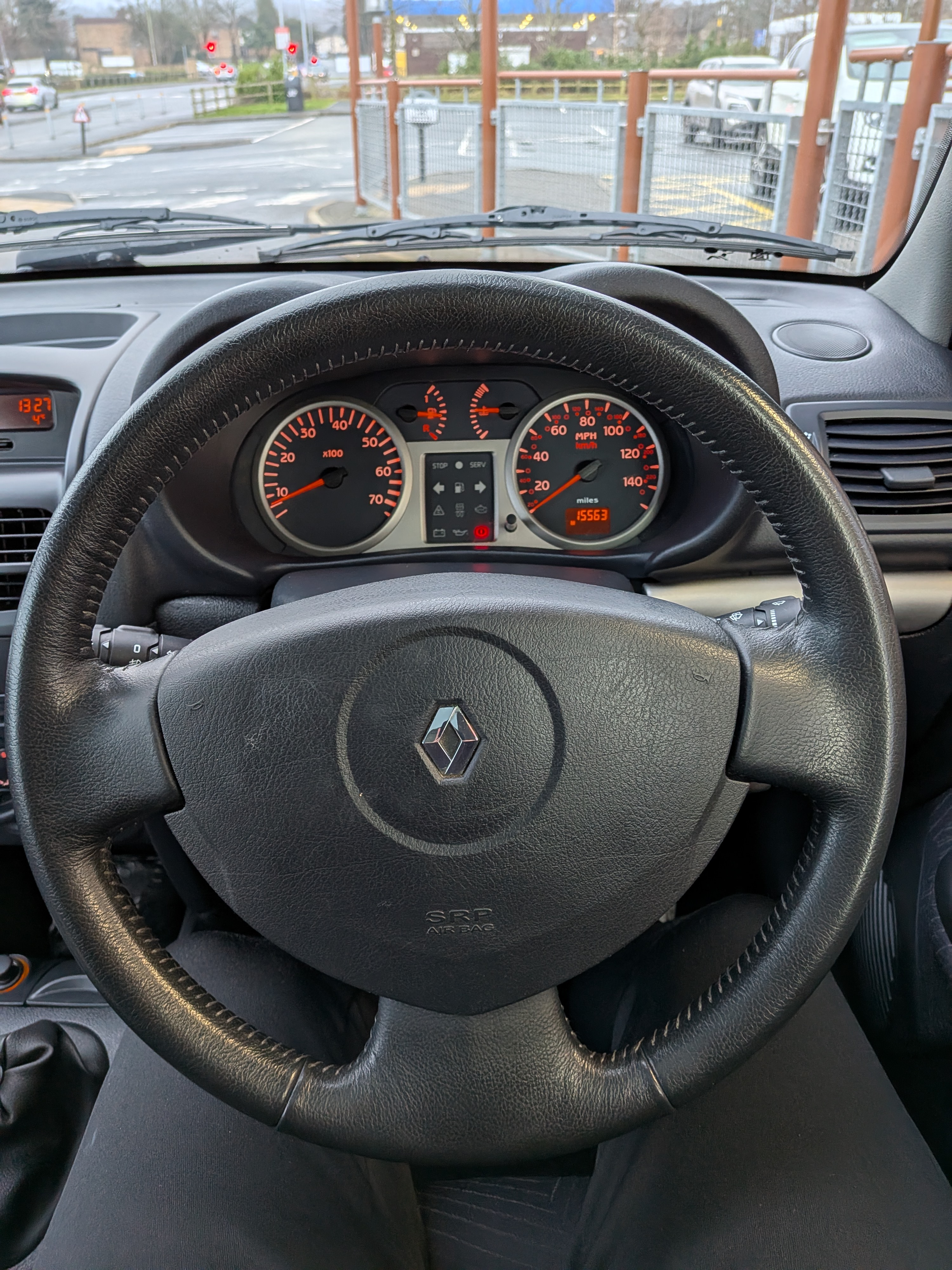

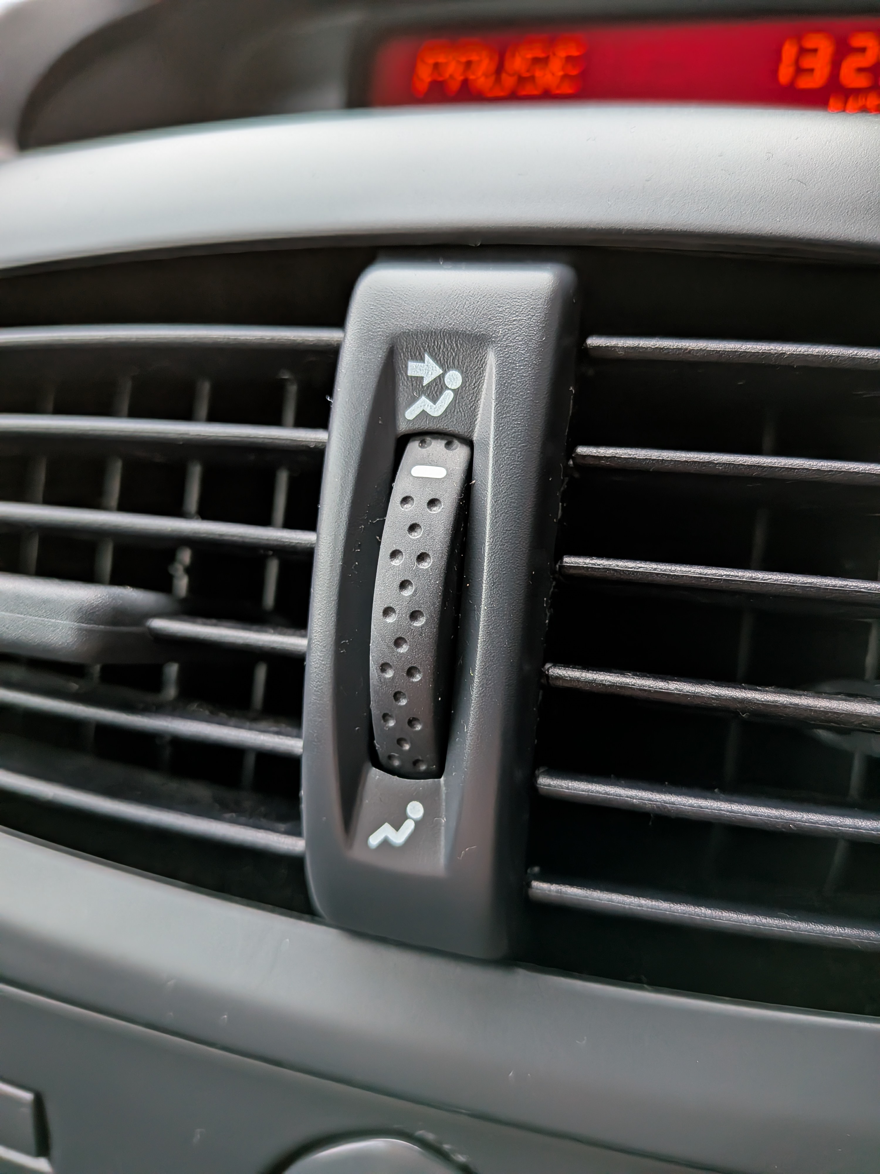

The car is mint, the switch gear all feels like it's never been used, proper tight clicks to the buttons, indicator stalks etc!
Engine even feels tight as if it's not run in!

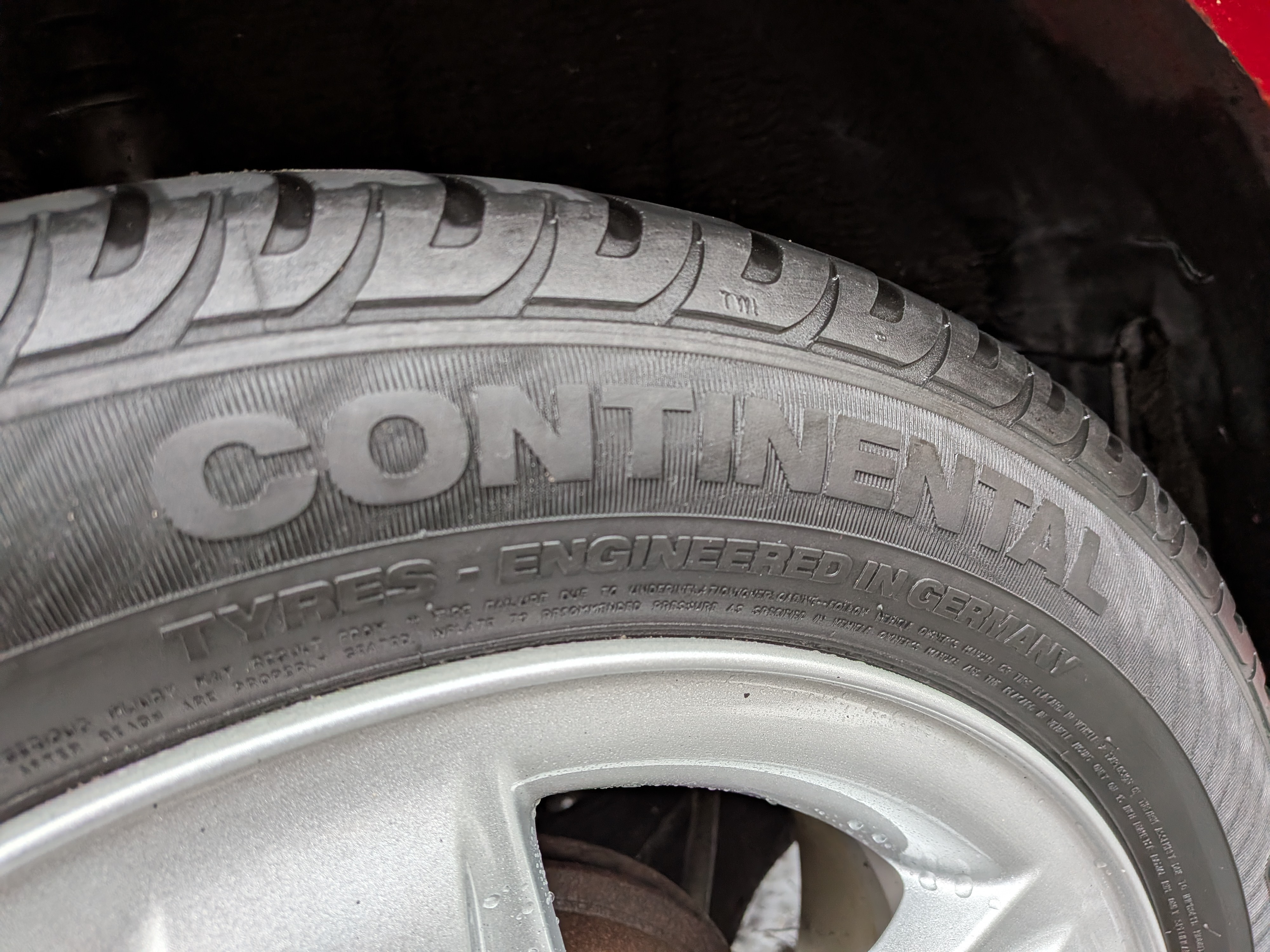

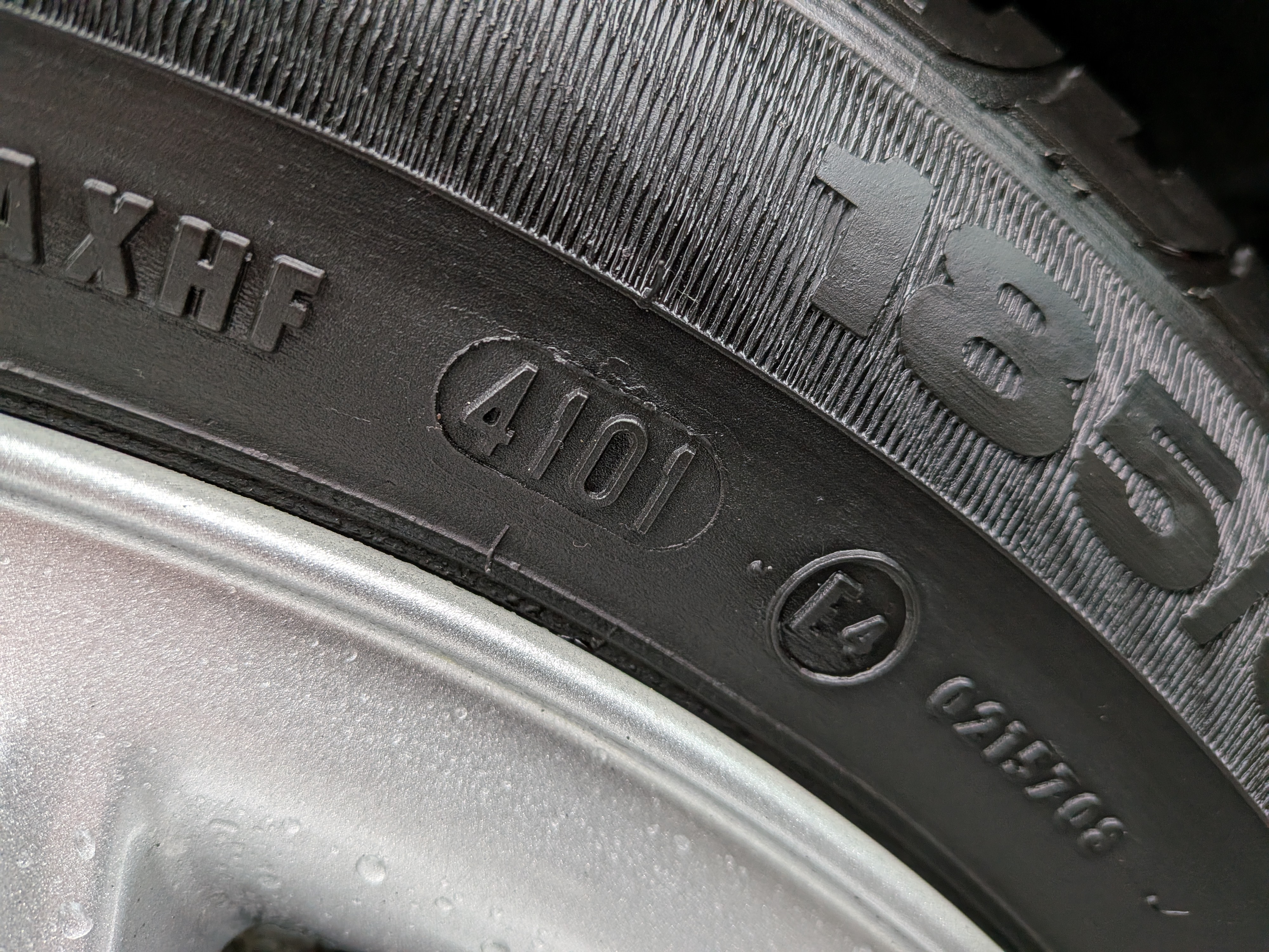

25yr old factory tyres are like plastic and fairly terrifying!

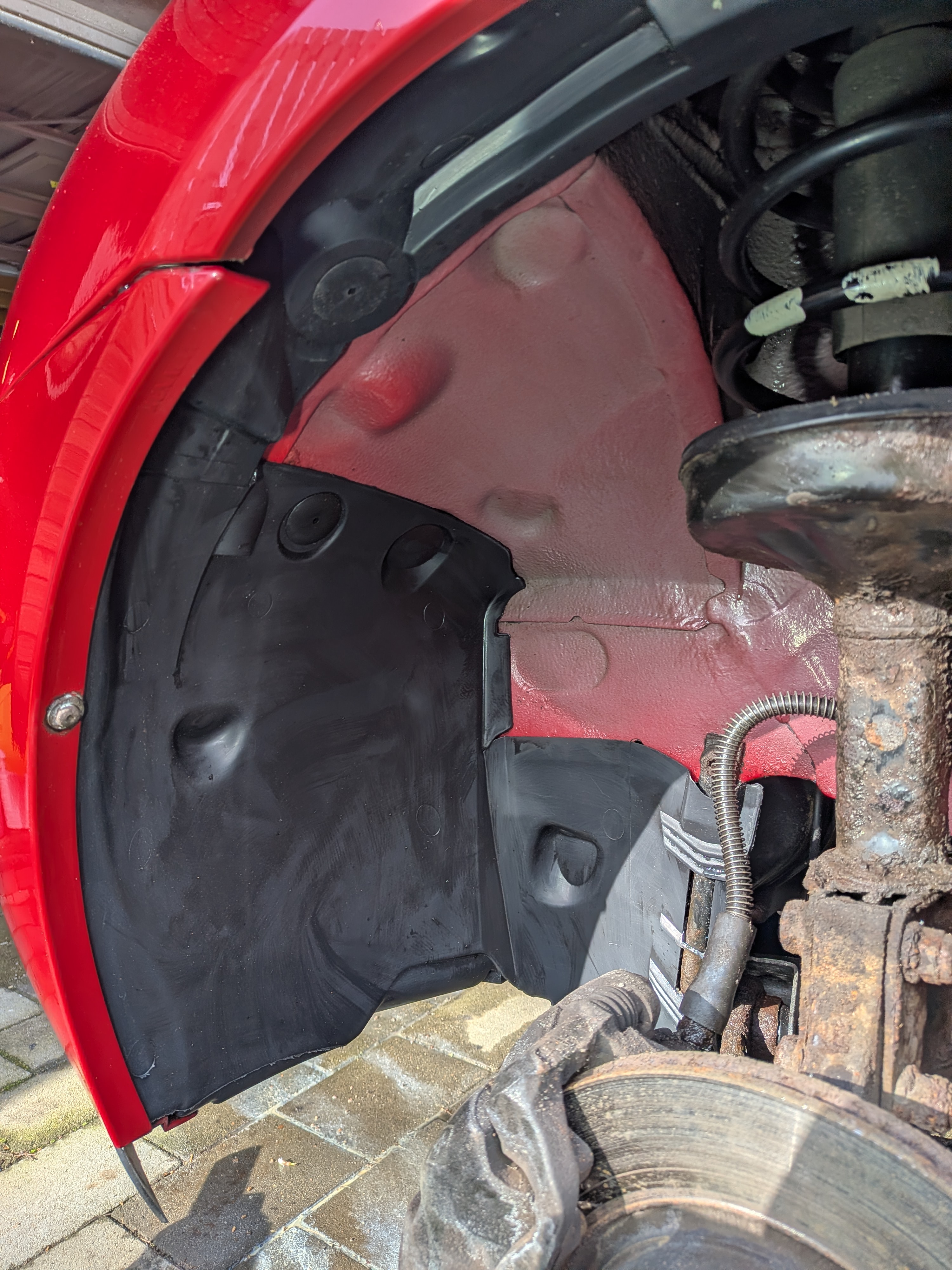

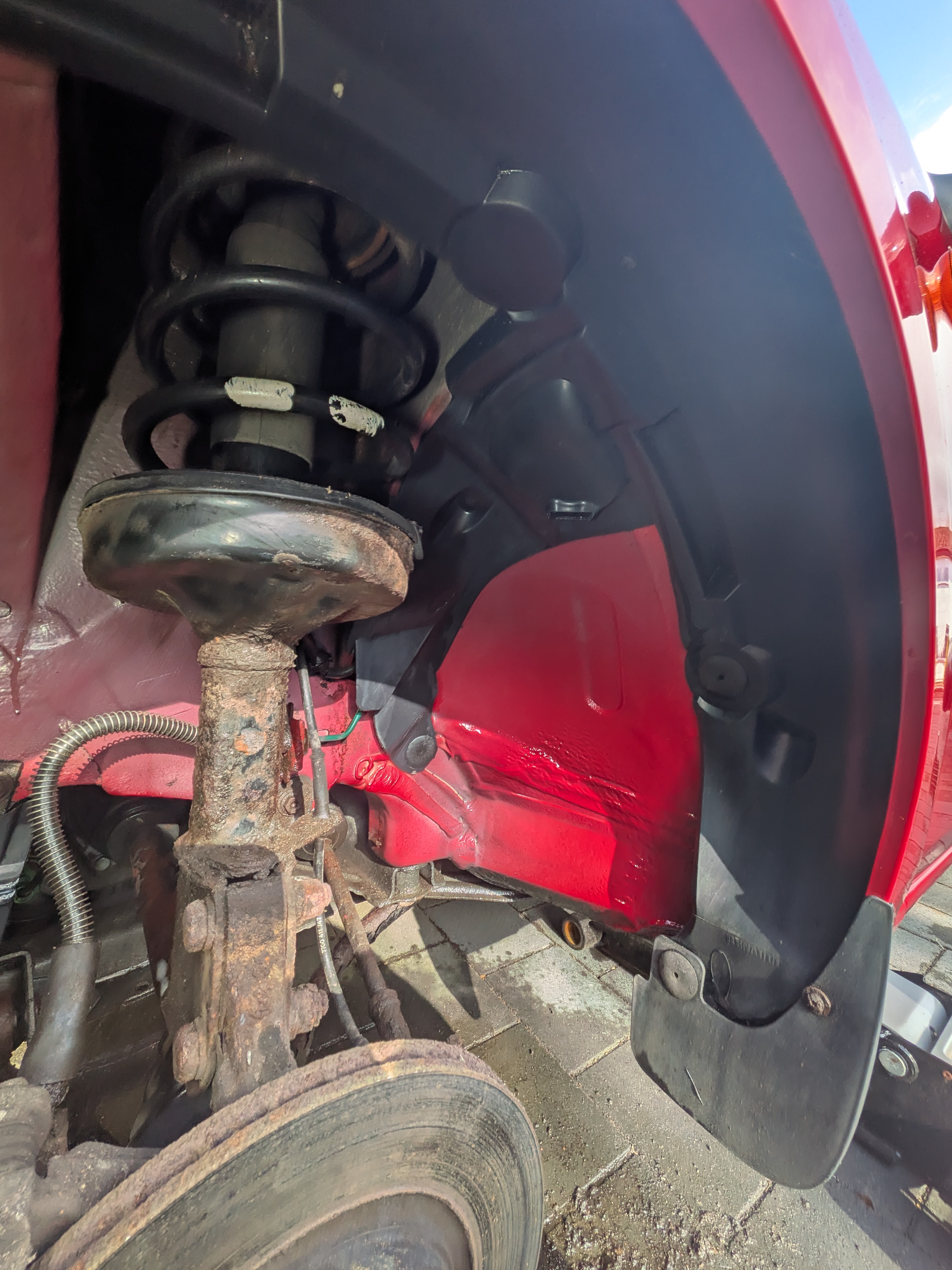

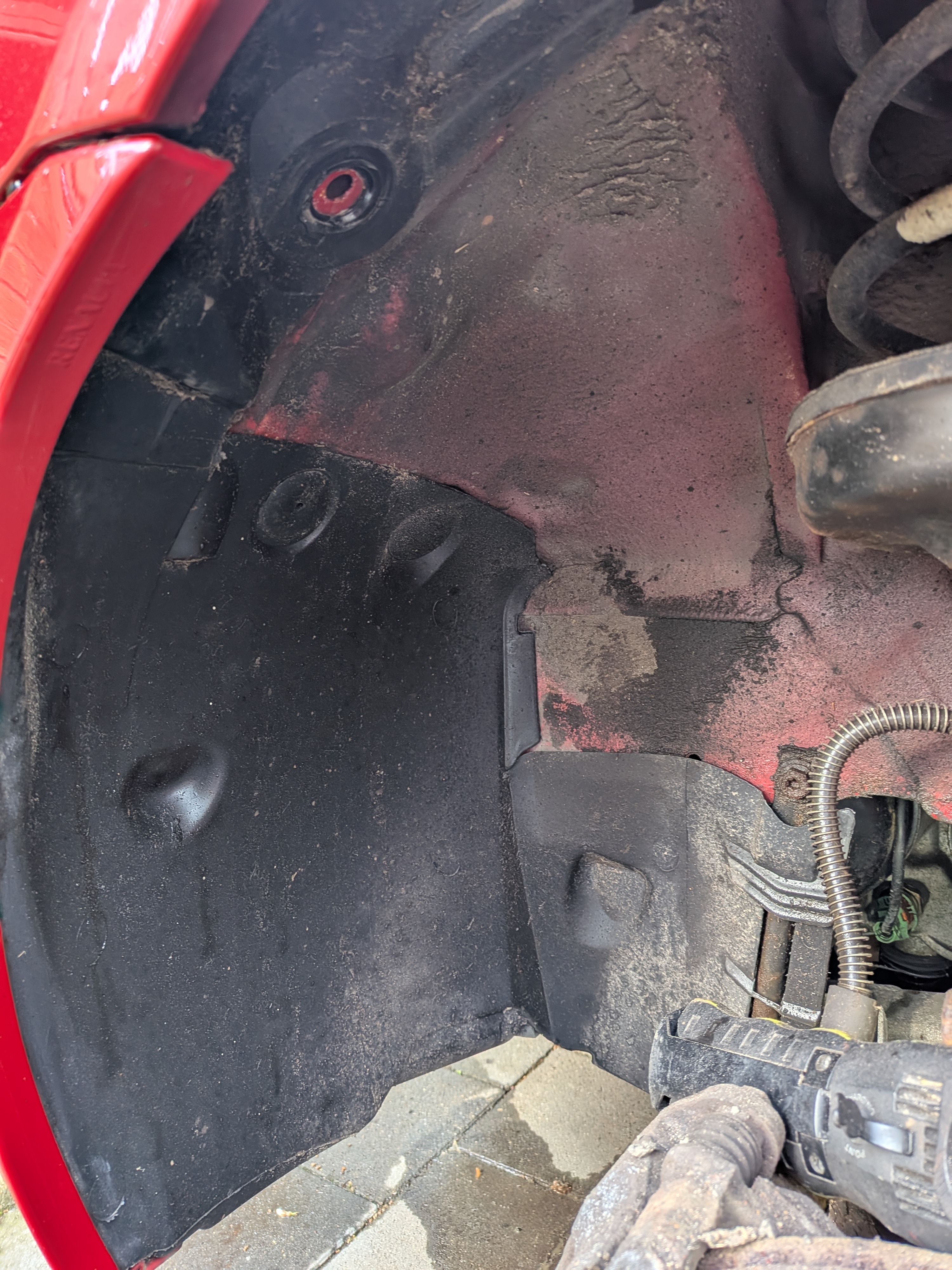

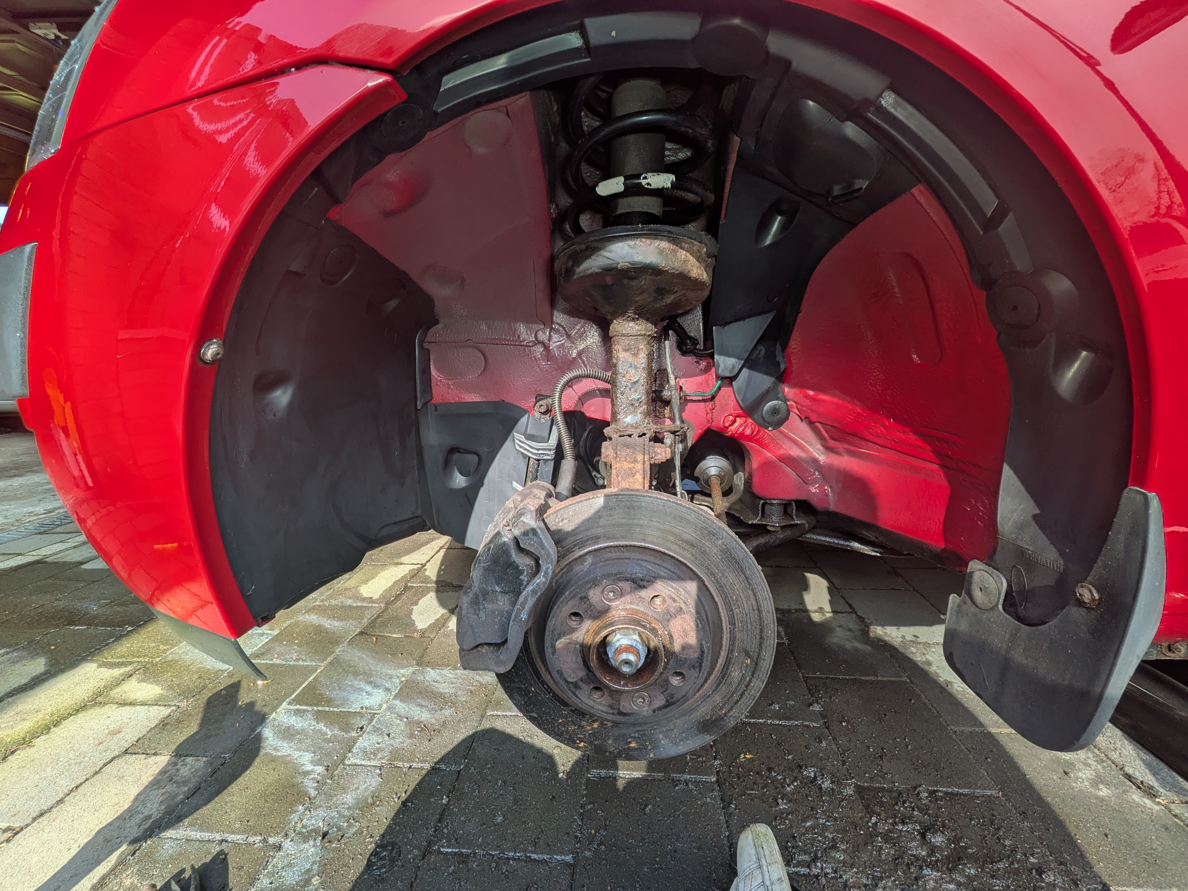

Started cleaning up the arches, also sourced a nice condition set of factory mud flaps so took the time to remove all the arch liners, clean everything up behind them and fit the flaps in the process

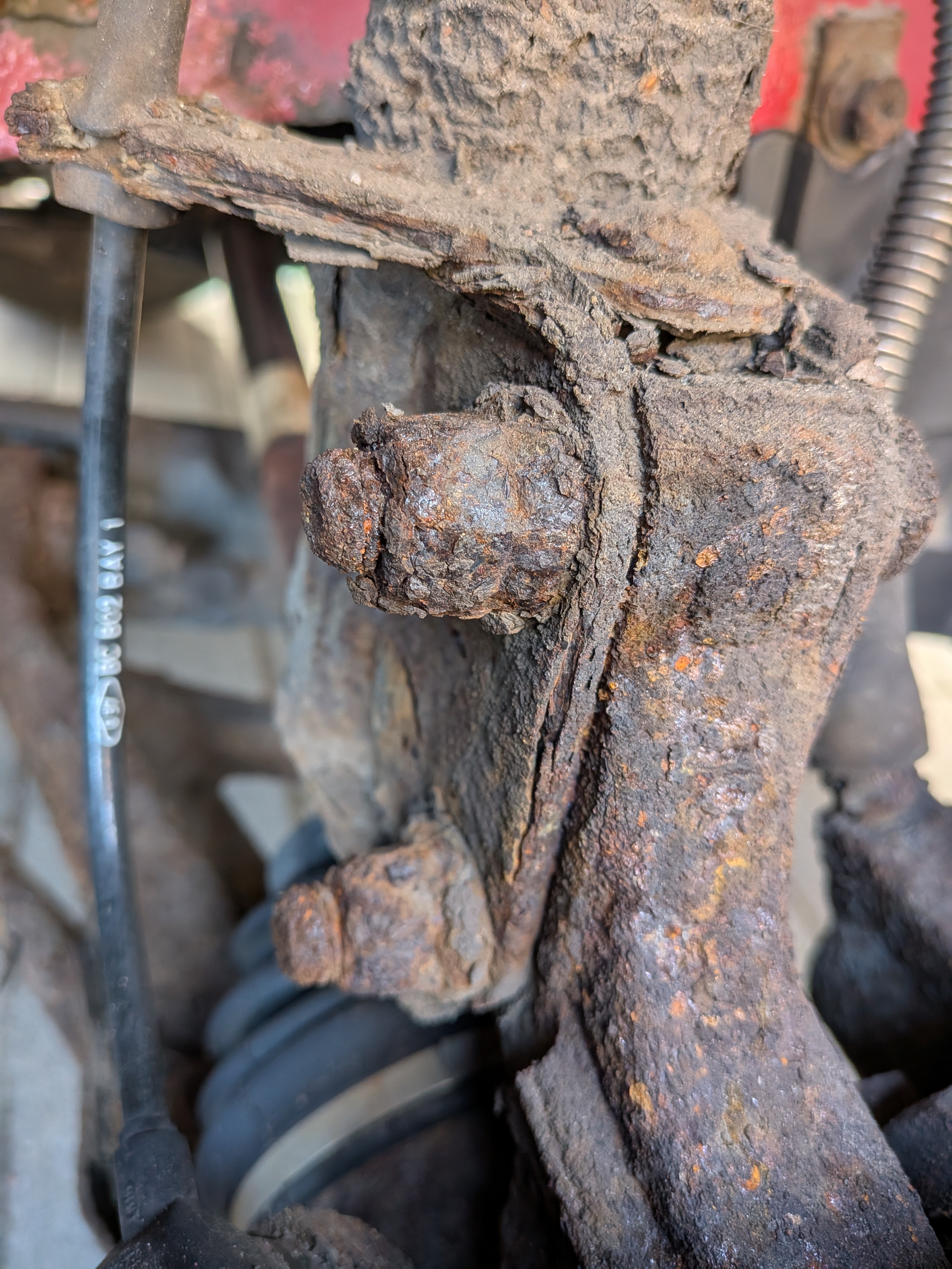

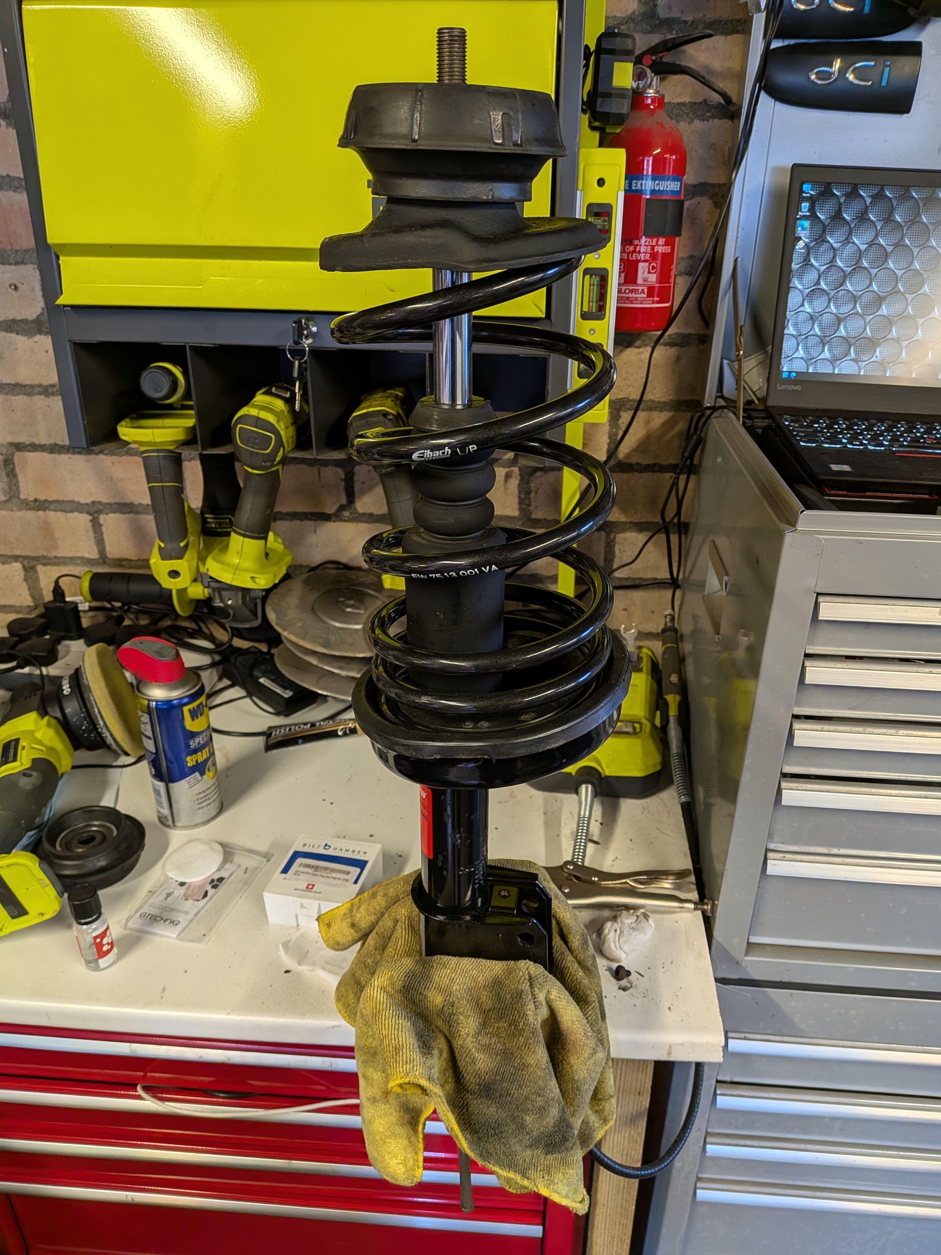

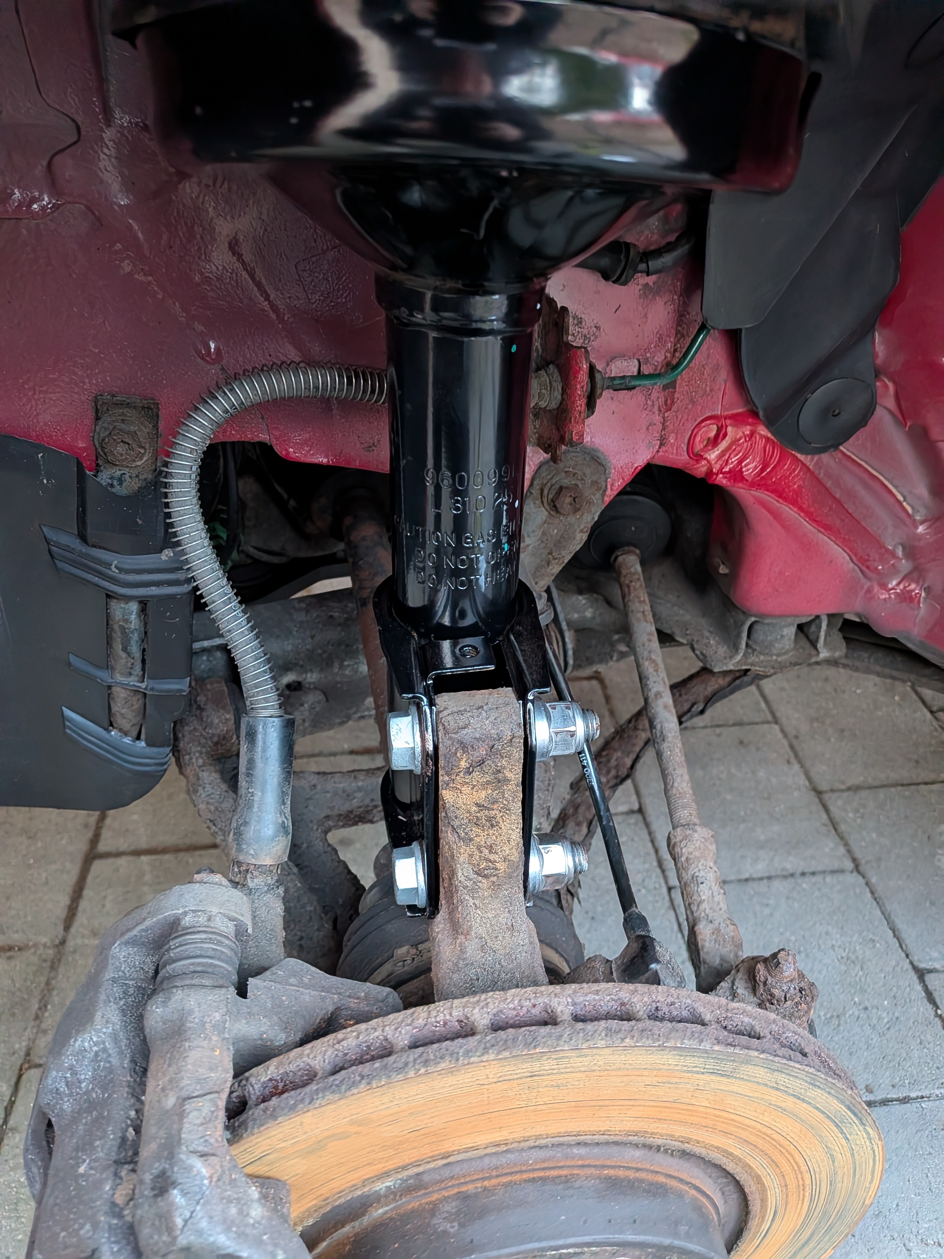

Suspension was all original, covered in surface rust but was nice to see its not even had a spring! Couldn't believe how good the factory springs looked - Anyway I decided it was worth pulling the shocks off and cleaning up in the suspension turrets!
And then I swiftly found a broken front spring :ROFLMAO:
I weighed up my options, Genuine springs are NLA, pattern part ones can be a hit or a miss but I didn't want to put lowering springs on it. I decided to compromise and go for a set of Eibach Proline so I can get a really good quality spring but hopefully not lower too much.
Both front shocks weren't returning back up when pressed down, might only have done 15k miles but they are 25 years old! so i ordered a set of TRW shocks all round as I've had good experience with these in the past

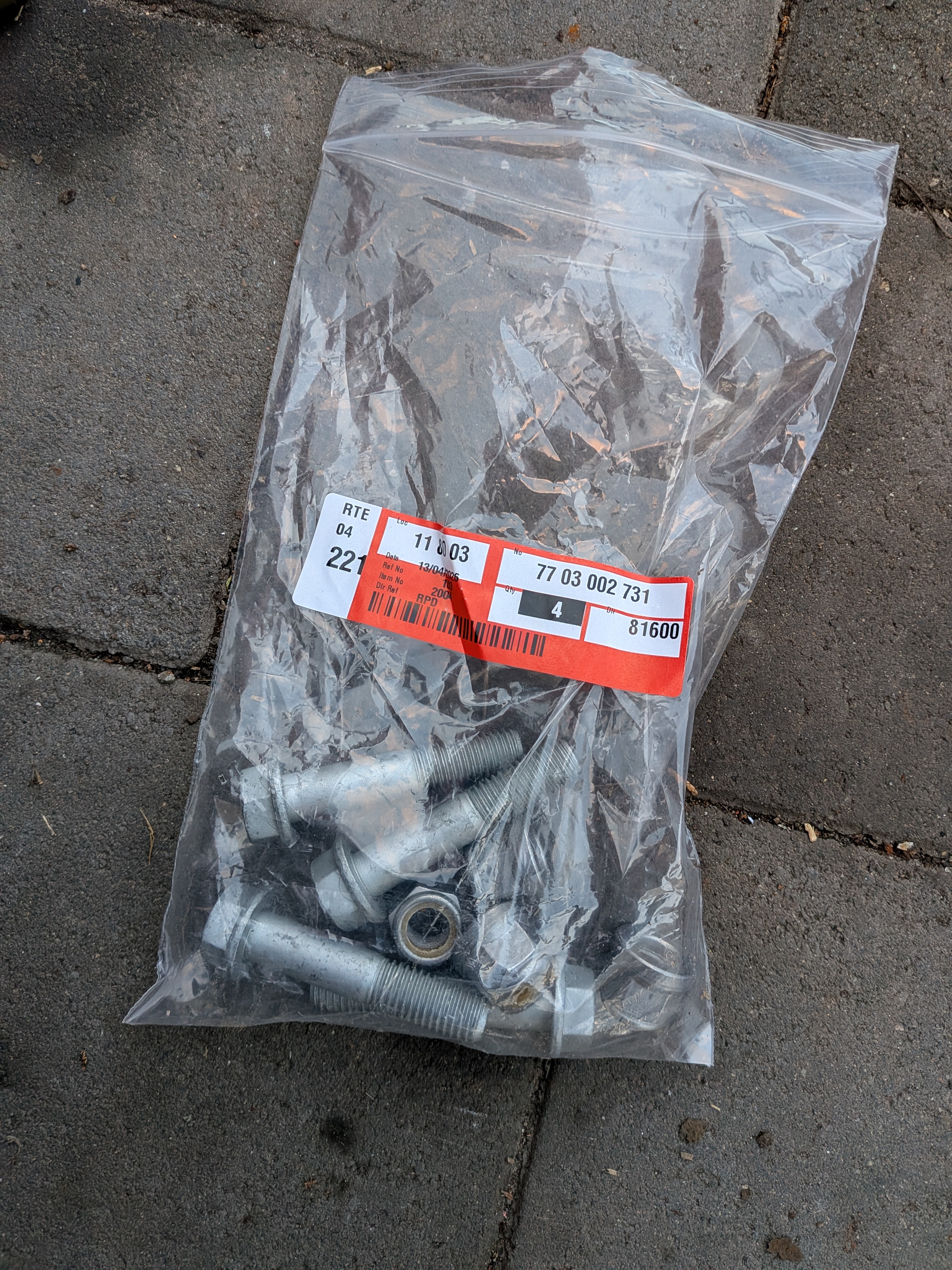

These were not fun! having never been off.
Luckily the bolts are still available from renault.

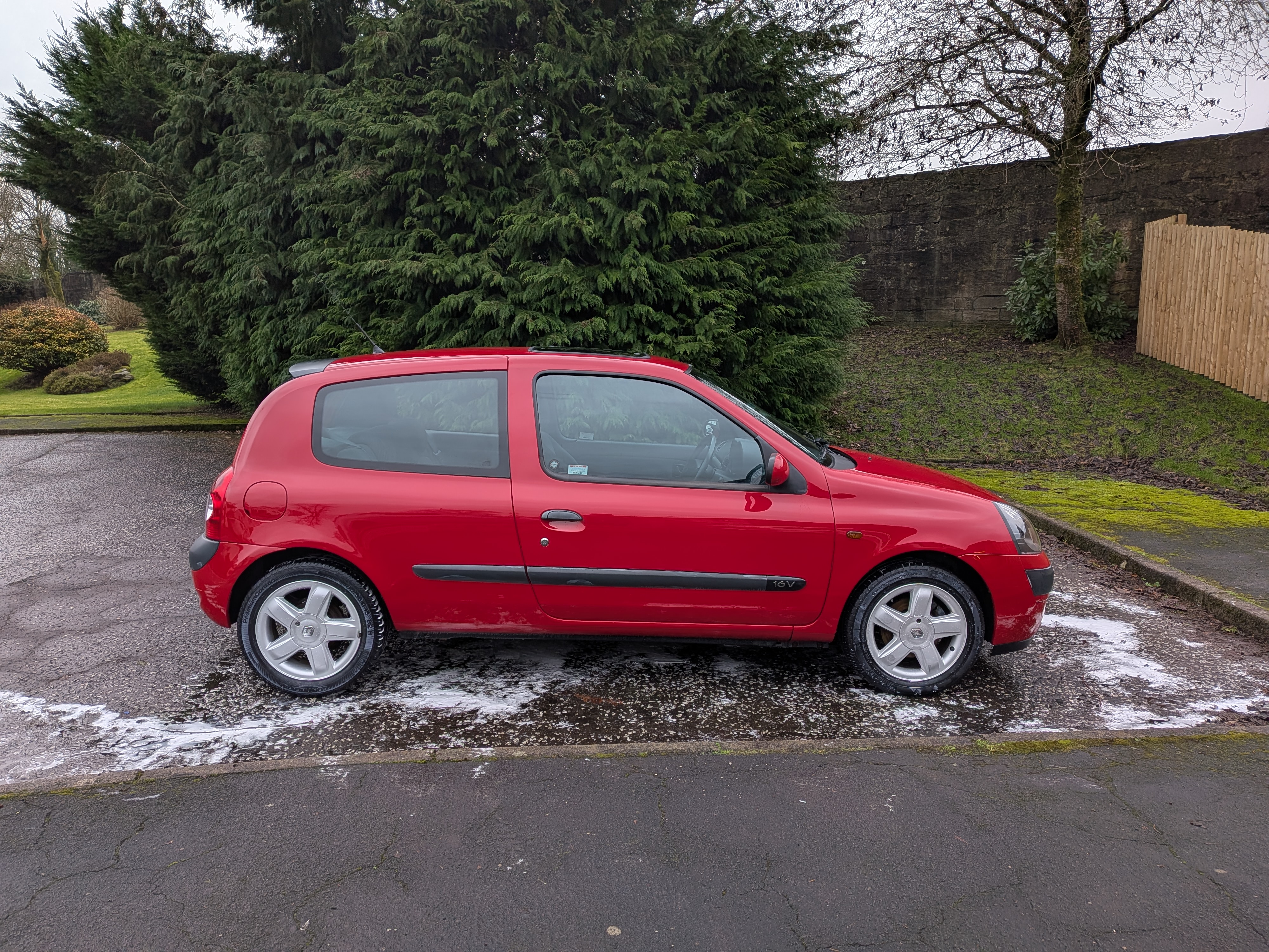

If I'm being honest it sits just a tad lower than I had hoped for initially but as time has gone on, ive warmed to it and think it looks good.

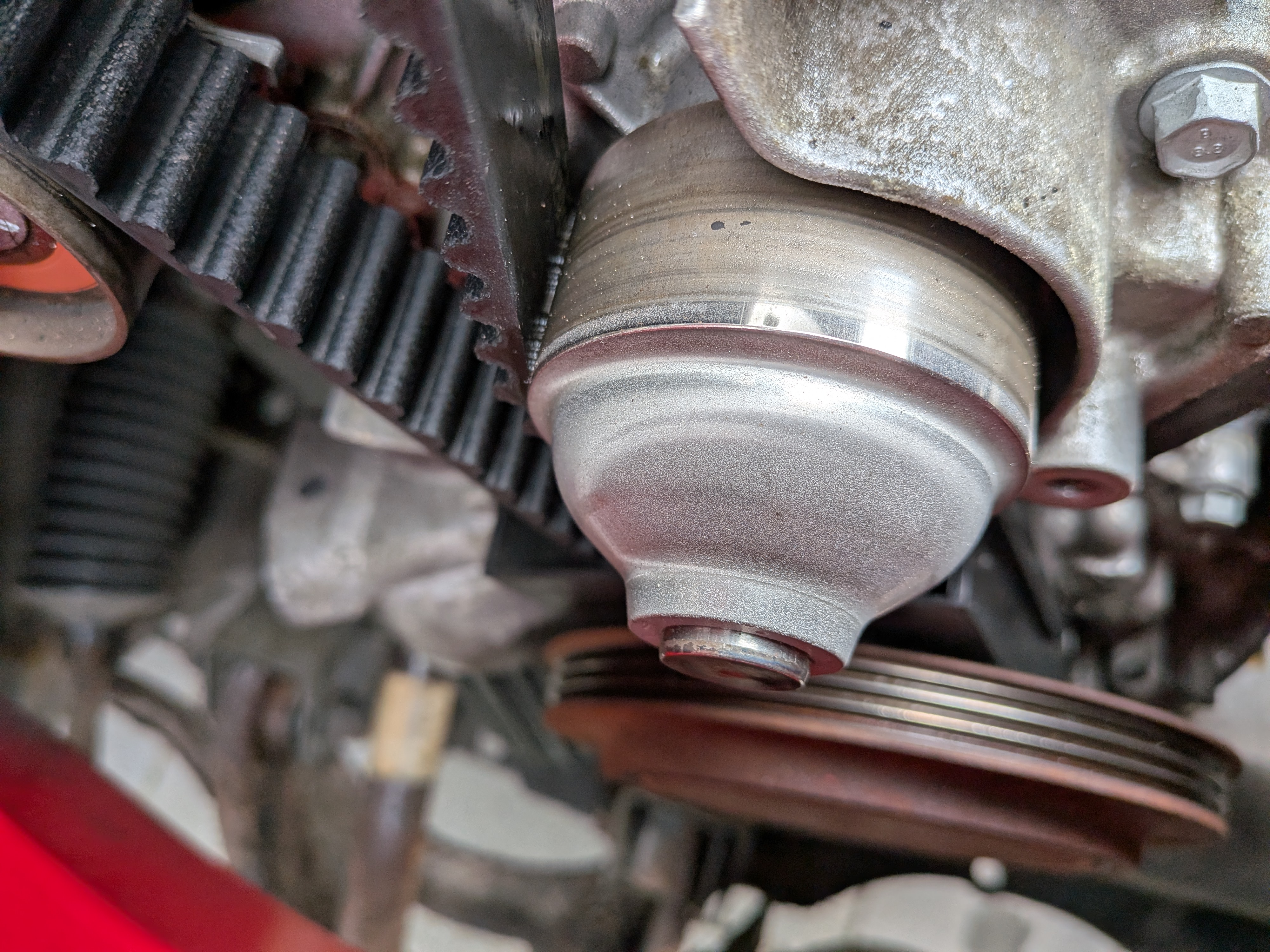

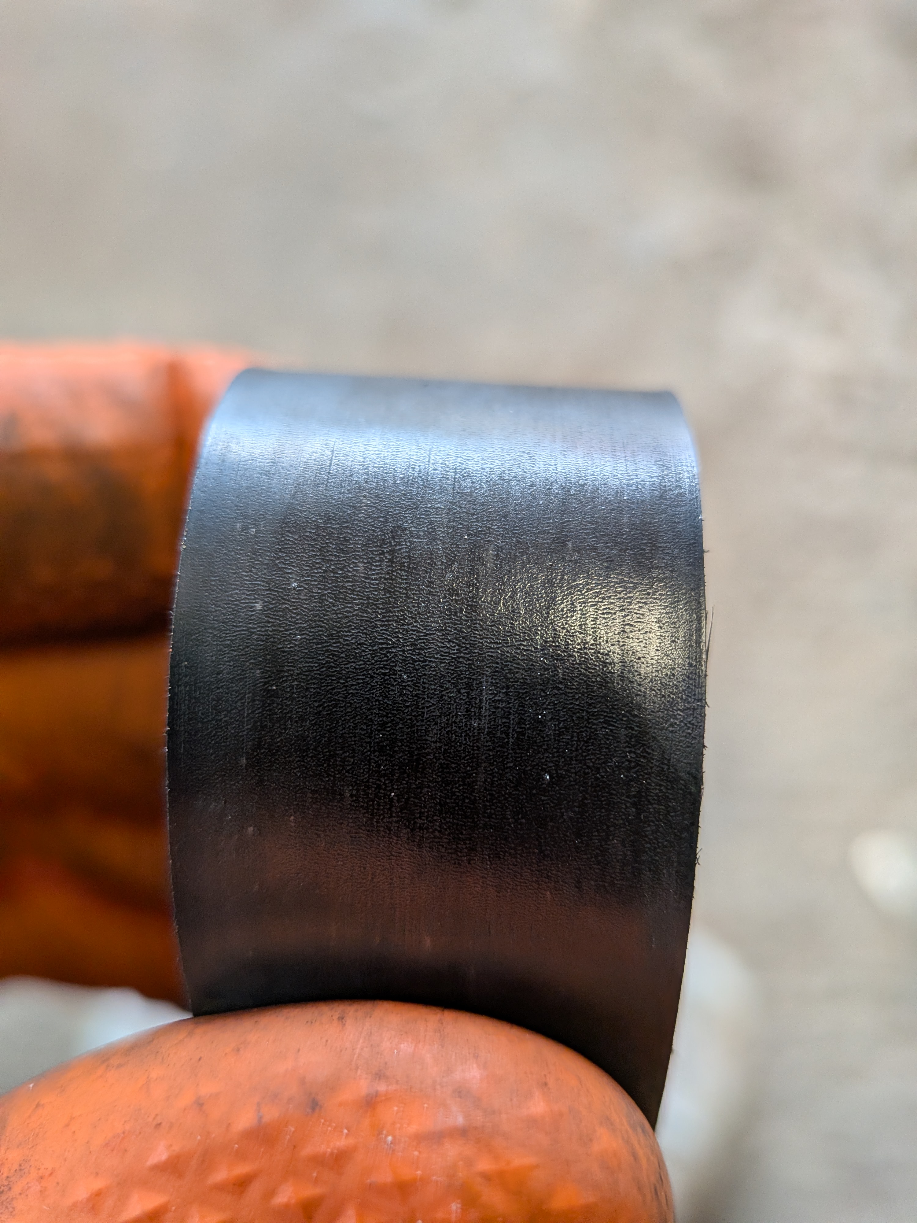

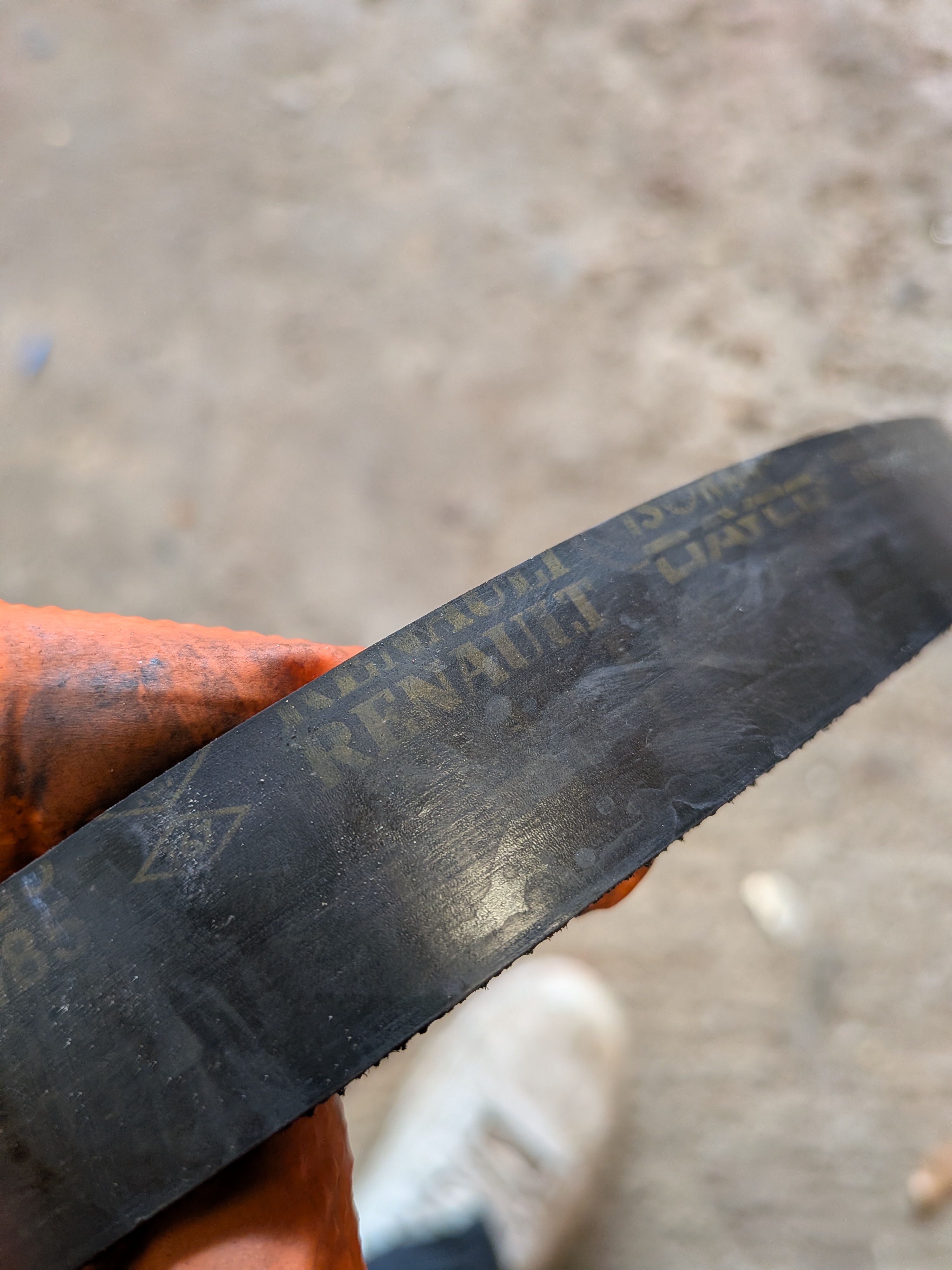

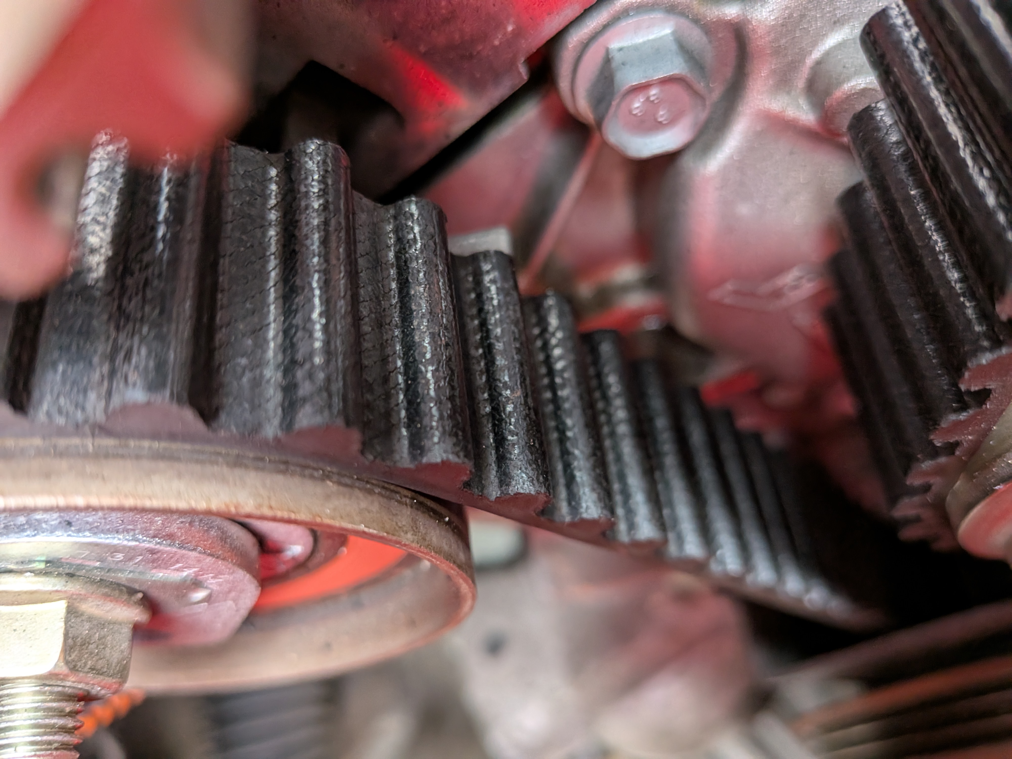

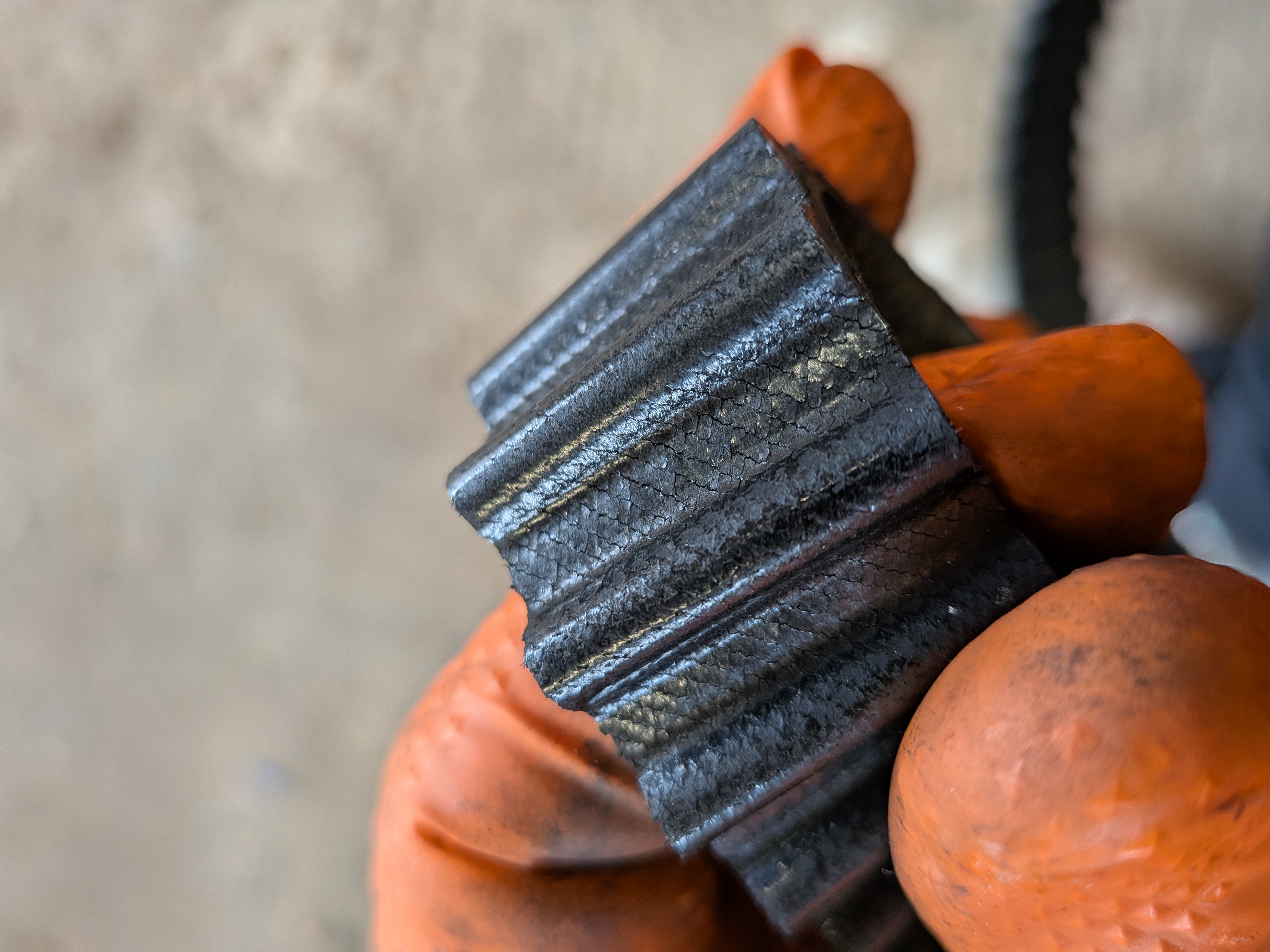

Done the belts on this at the weekend as there was nothing in the history about it. Must have had a belt before now surely, cant be 25yr old and on its original belt.... or so i thought...

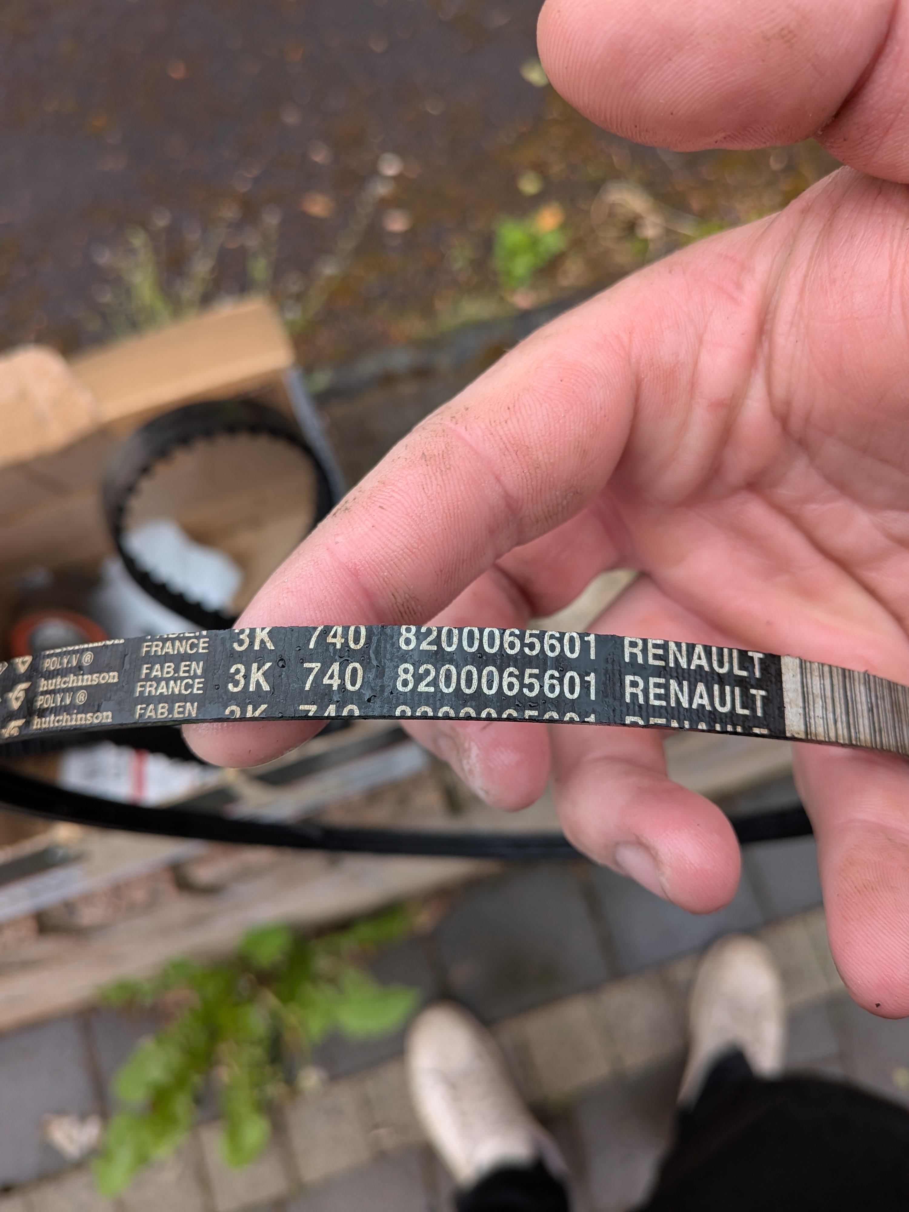

I think that belt would have done another 25 years! Even the aux belt was like new...

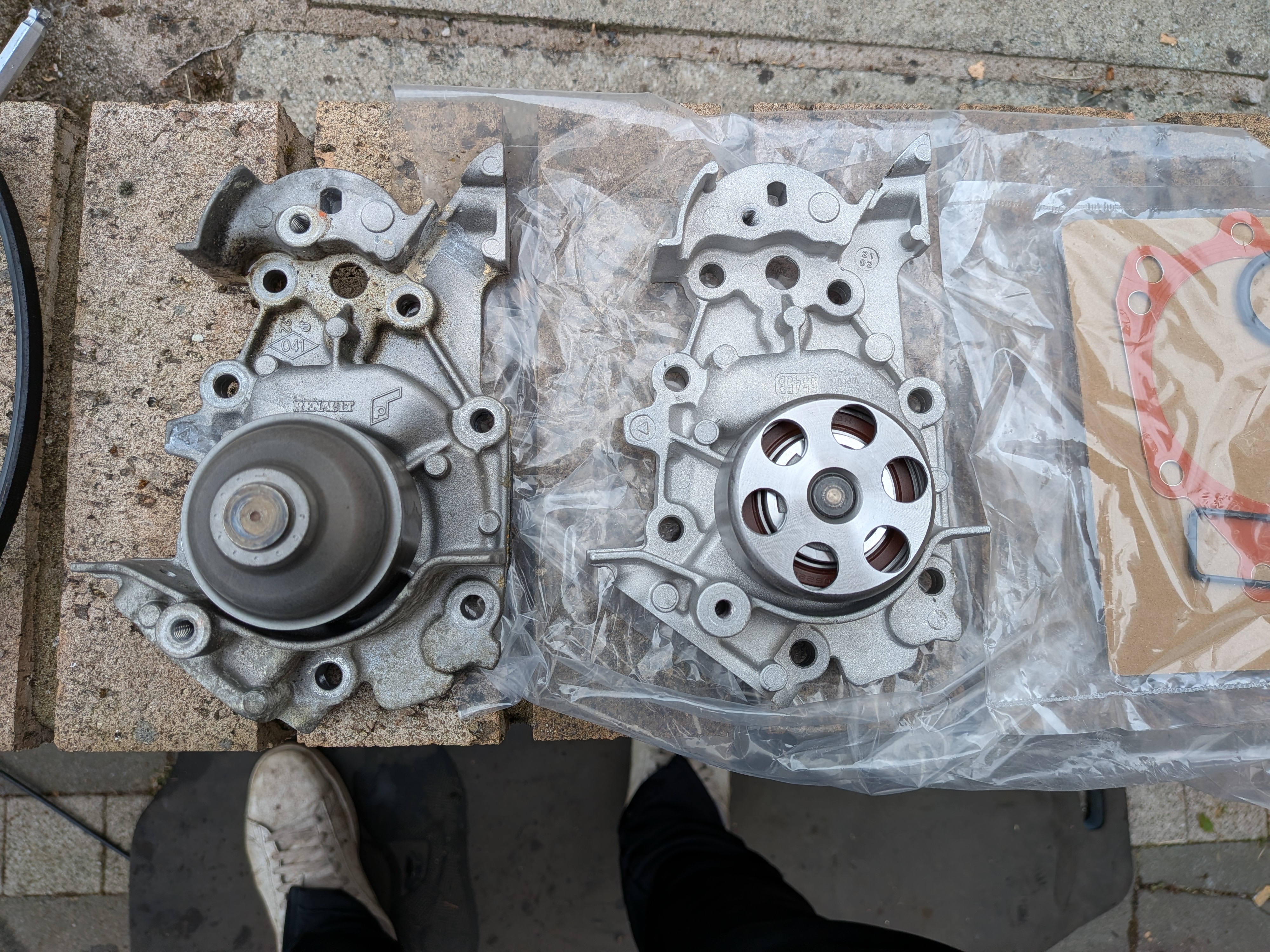

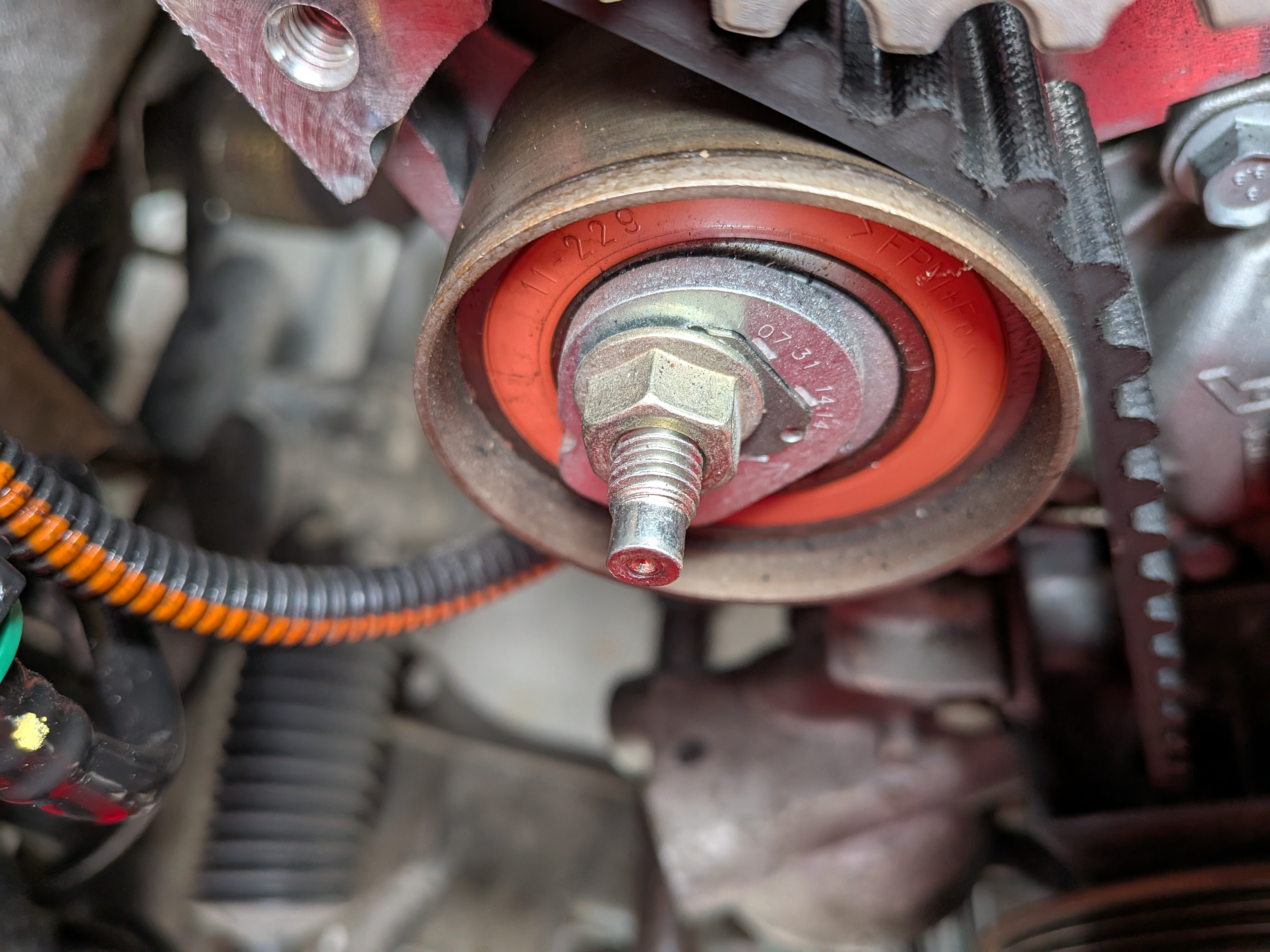

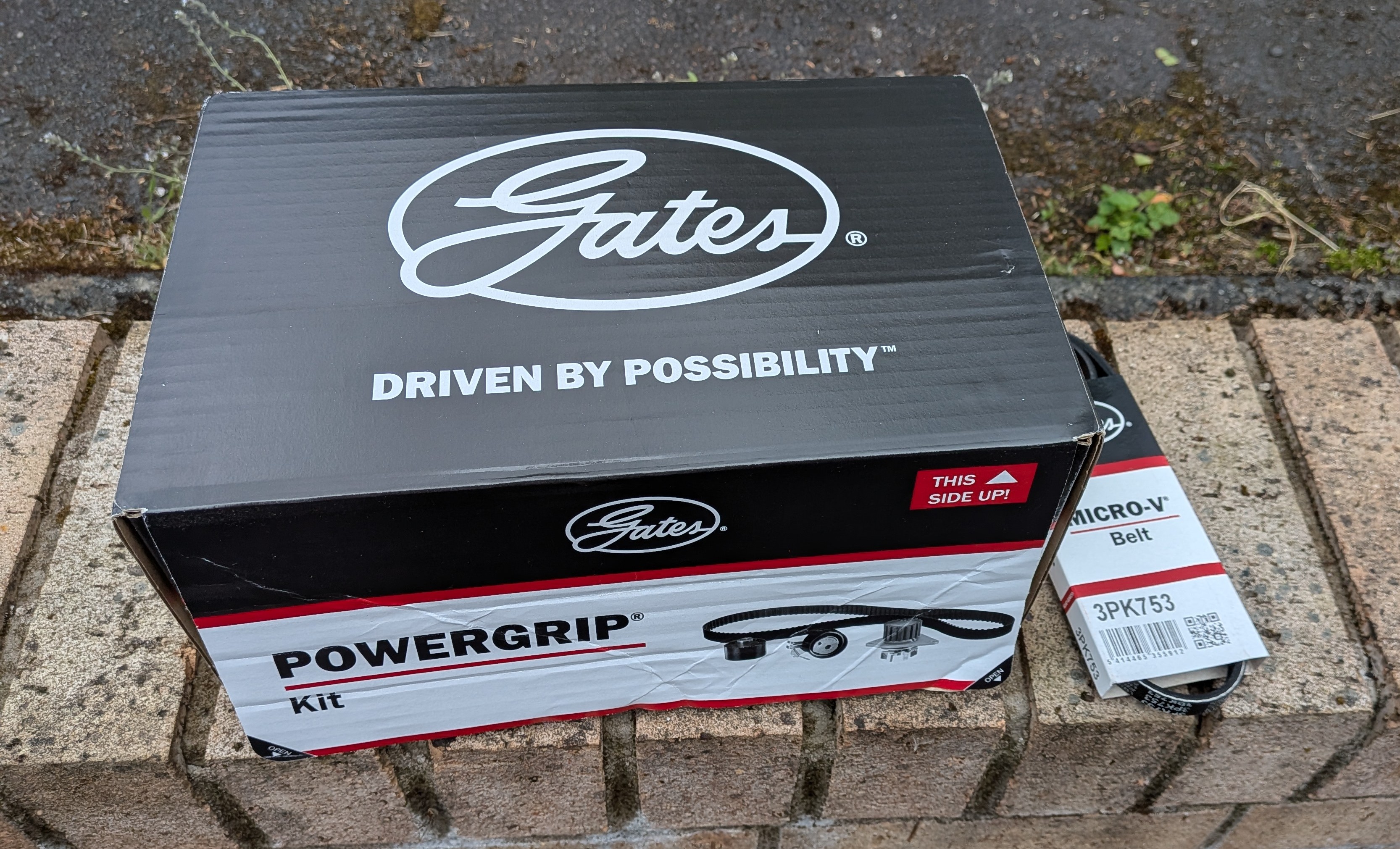

I usually use INA belt kits as they seem great quality and ive never had any issues, but i decided id go for a gates for this one and "treat it" but tbh i really wasn't impressed with the quality, belt its self seemed fine but the casting on the water pump and the general feel of the tensioner weren't great. I was close to fitting the belt and reusing the old waterpump and tensioner! Ill probably remove it for an INA kit at a later date, since its only a 30 minute job on these!
