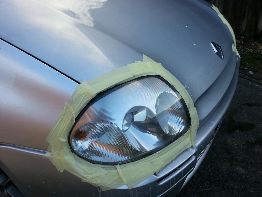

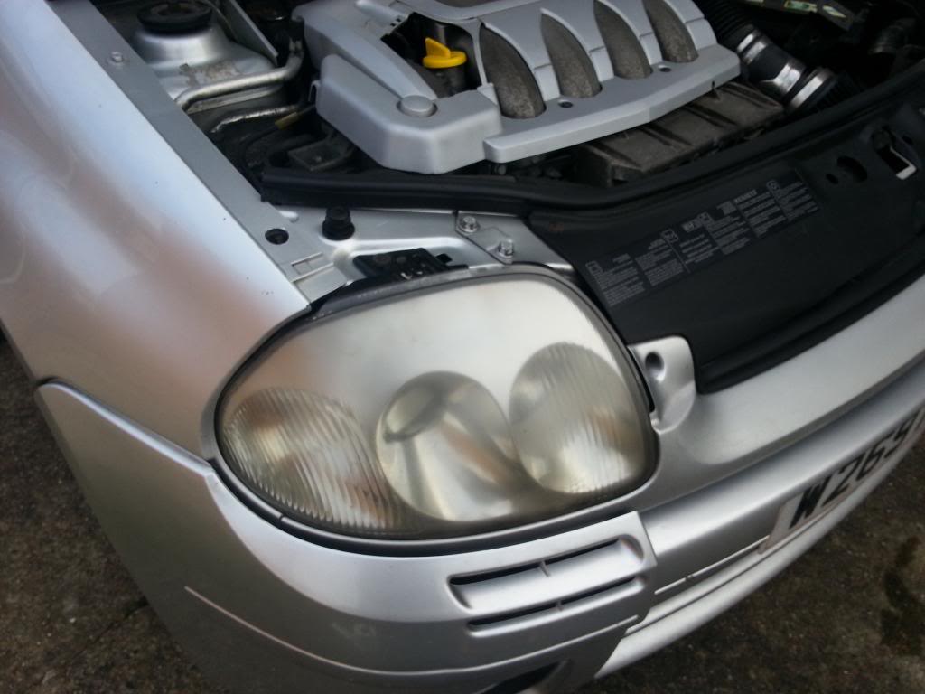

I had no issues at all using the 3m kit on the drill, perhaps that's less brutal than a true rotary then?
Lol. Get the 500 from a wood shop?! Far too coarse a grade for plastic headlights!!
indeed!! would never go 500! i thought 1200 would be pushing it so just went for 1500 then 2000 in the end, worked out a treat!
