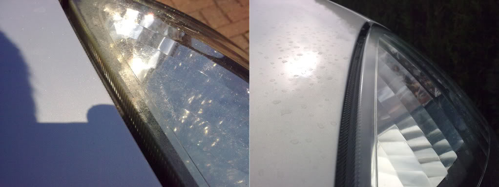

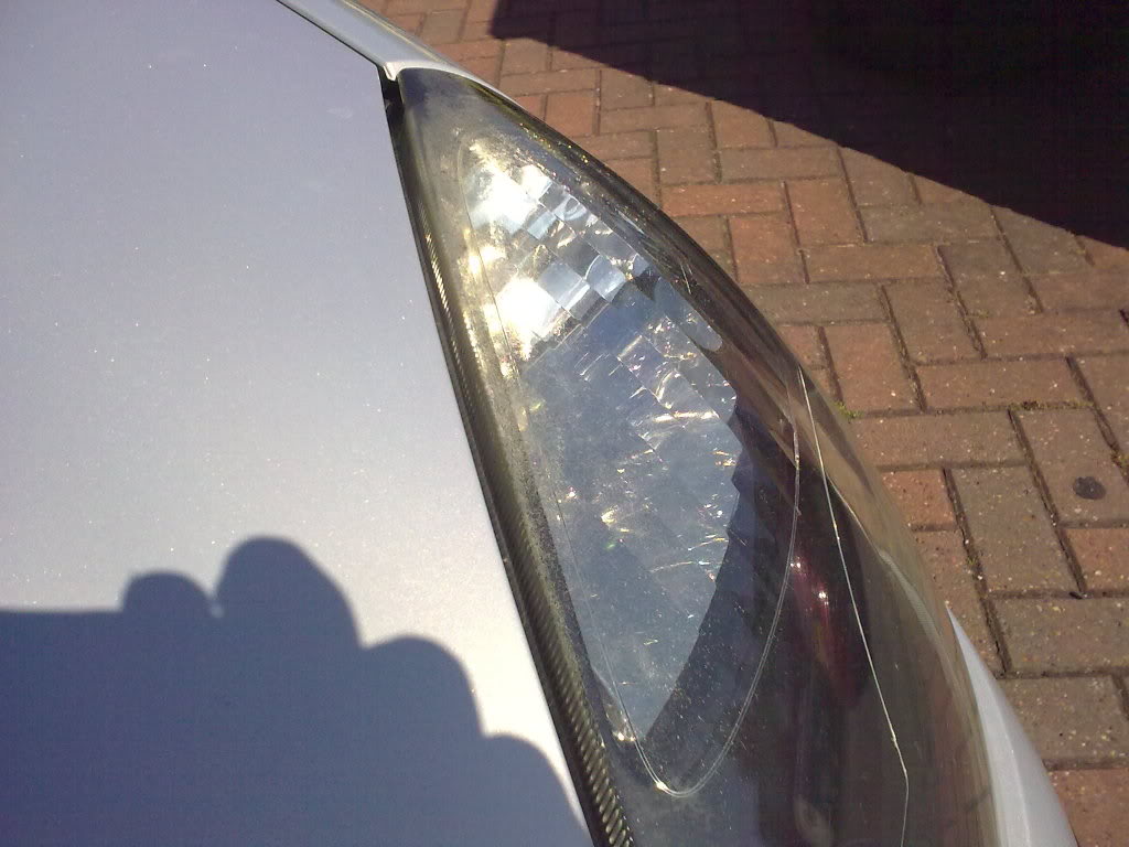

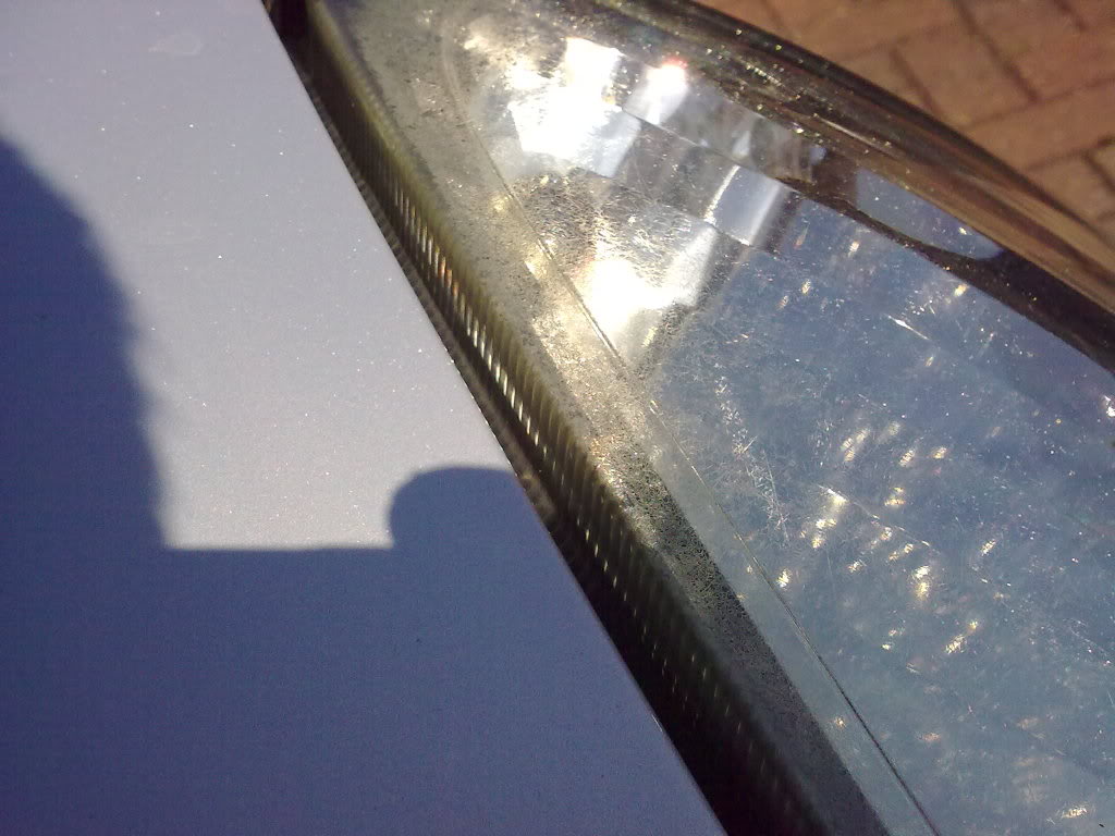

Before....
As you can see they werent looking to great and both headlights looked like the photos above. So I wet sanded them and polished them back up using SRP and a polishing attachment for a drill (tbh this worked much better than I thought it would and for the sake of a fiver I thought I would give it a try).

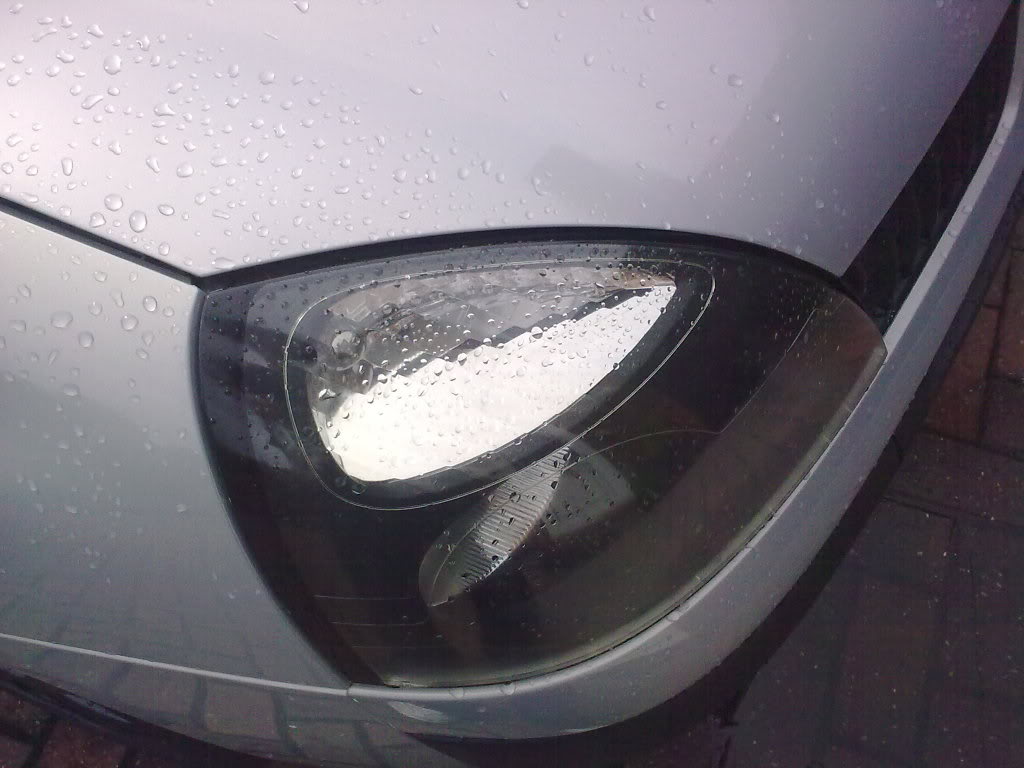

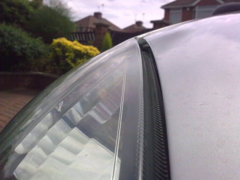

After...
Before and after ...
As you can see they look much better, could could still maybe do with been machine polished tho if anyone fancies doing them for a few beers. :rasp:

Good effort, the result still looks a little hazy, so give them a go with a more intense polish, aka something with a bit of cut.
