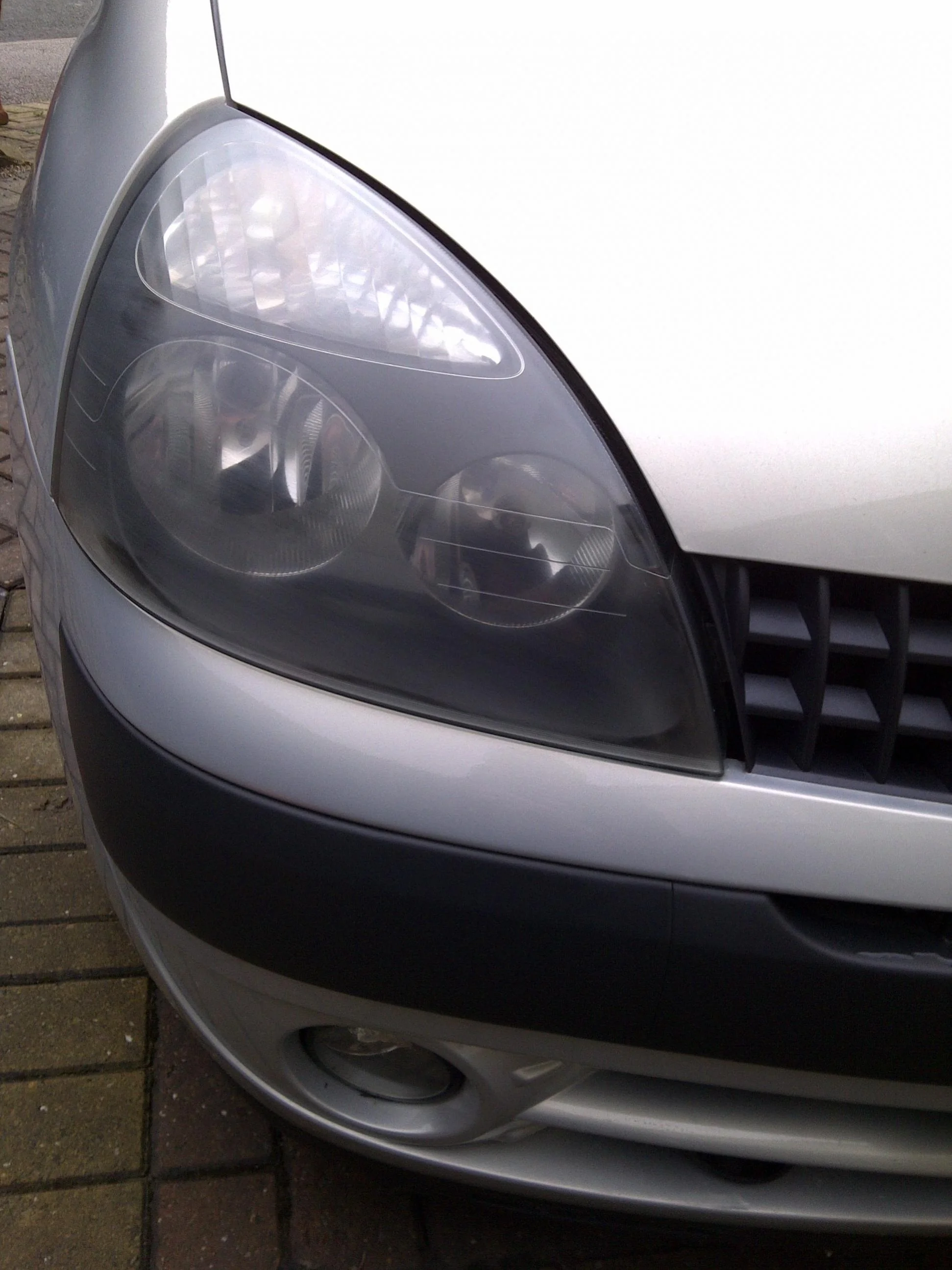

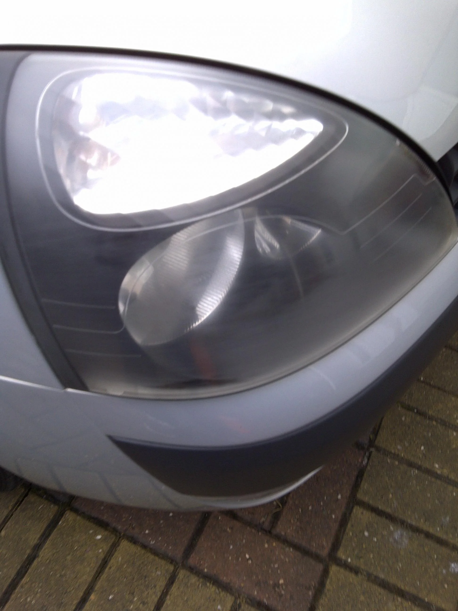

Anybody know anything I can use to sort out my headlight? Used wet and dry paper as stated on a guide on here and then the scratchx 2.0 but it looks abit dull.....

You have done a good job of the sanding from what i can see. What was the last grade of sand paper you used?. It looks like you have either not finished with 3000 grit or your not rubbing hard enough. The higher the grit you go, the easier to correct.
