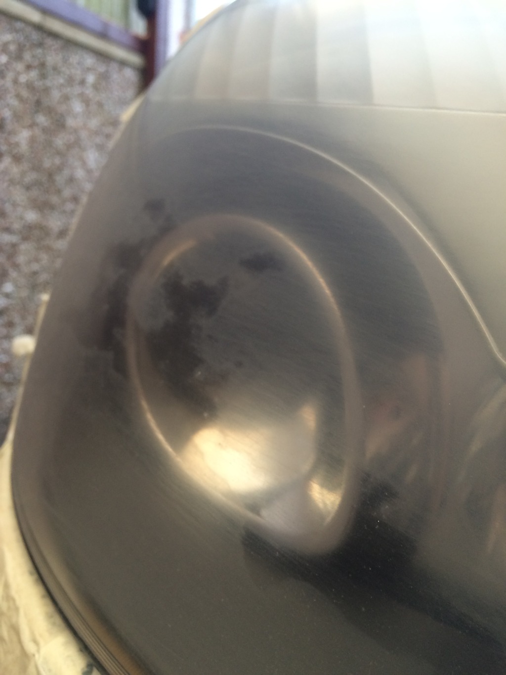

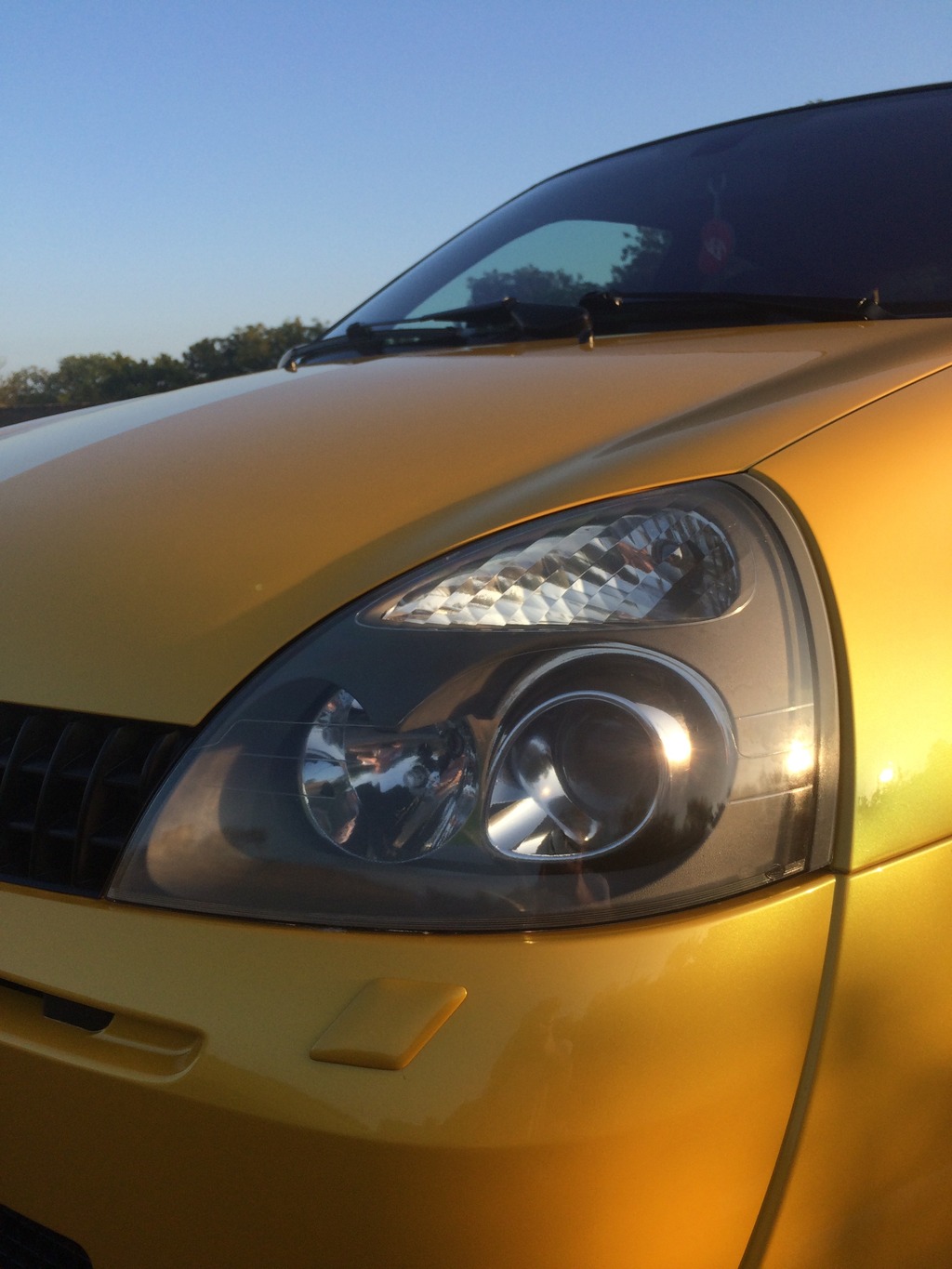

This has probably been covered hundreds of times, but has anyone encountered these island-like shapes forming when refurbing the headlights?
[/URL][/IMG]
Thanks for the quick reply mate. I'm sort of mid-job right now lol. I'm going to clear coat them afterwards, any reason why I shouldn't?
No need, but makes everythibg easier.

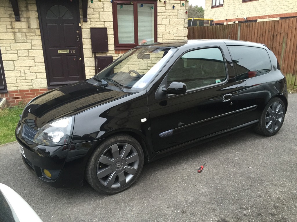

This is it immediately after clear coating. I waited over 24hrs then wet sanded with 3000 grit before hand polishing with G3 scratch remover. Haven't taken pics since I polished though so I'll get them up tomorrow
