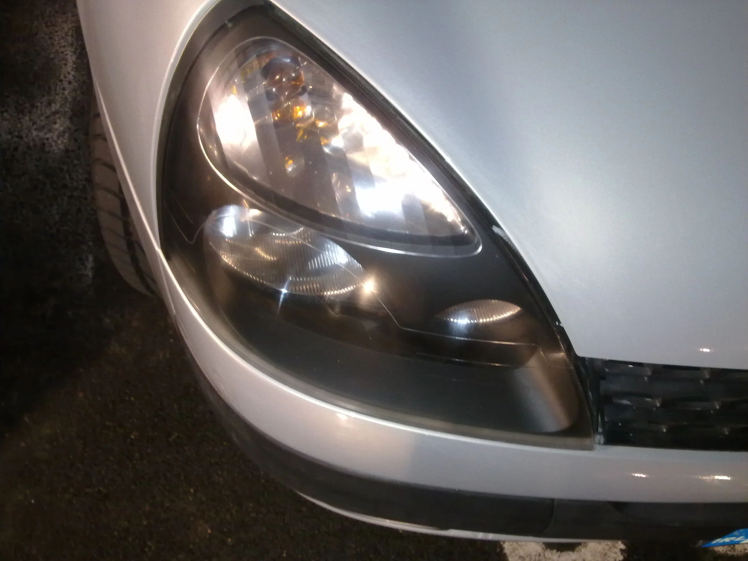

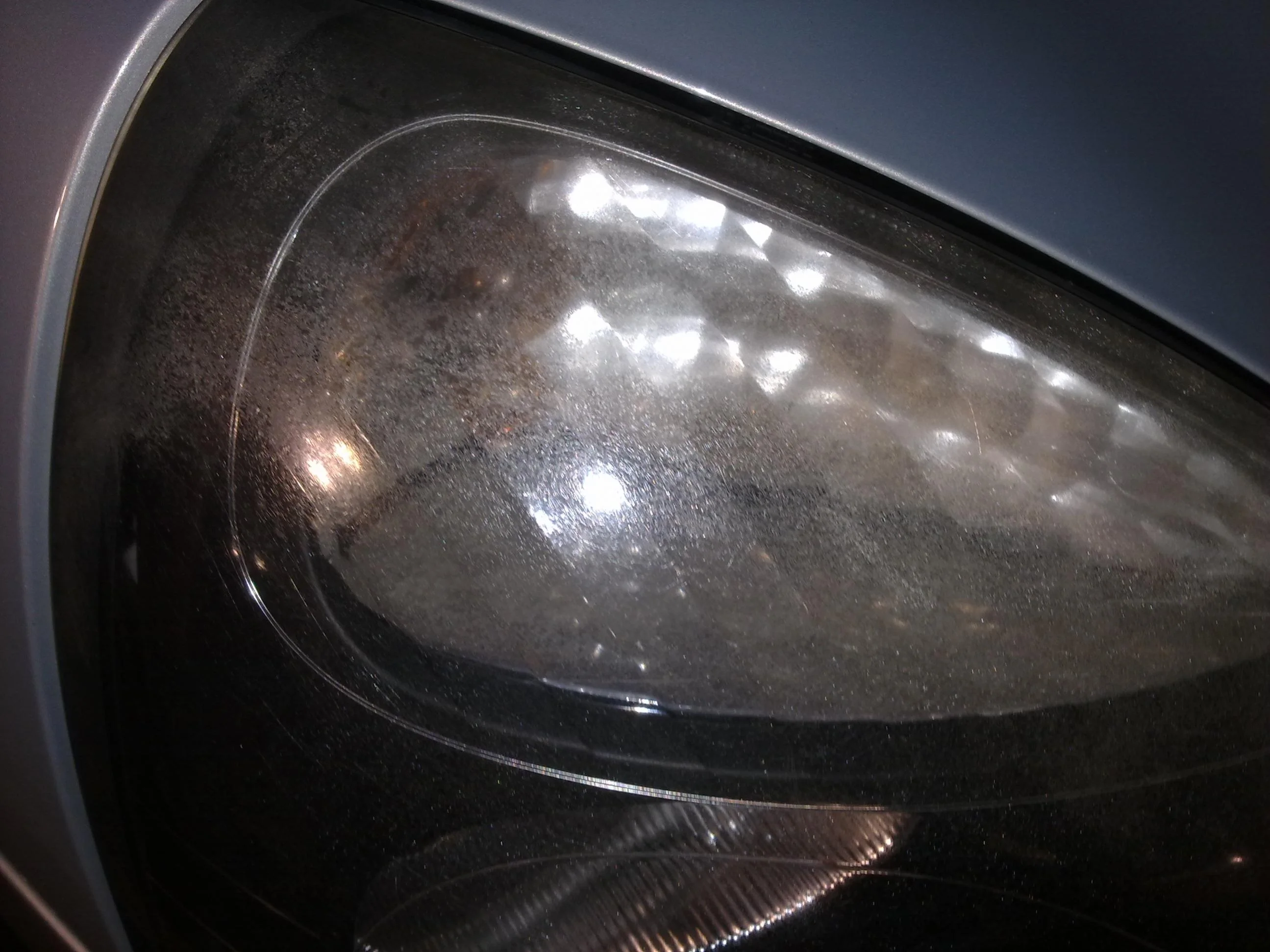

hi, i did restoration today but its not this what i was expected...
its looks better but not like new or maybe i have to spend more time and be more patient...
before:
after:
