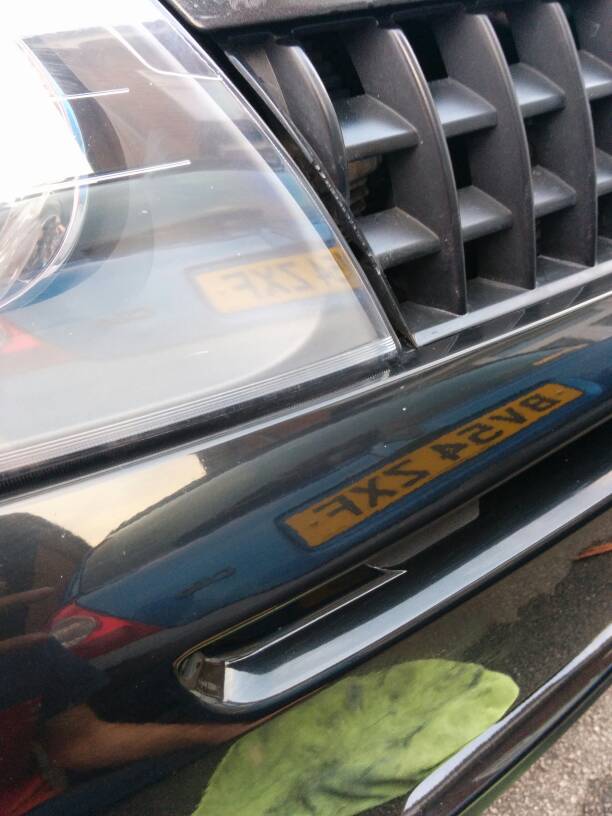

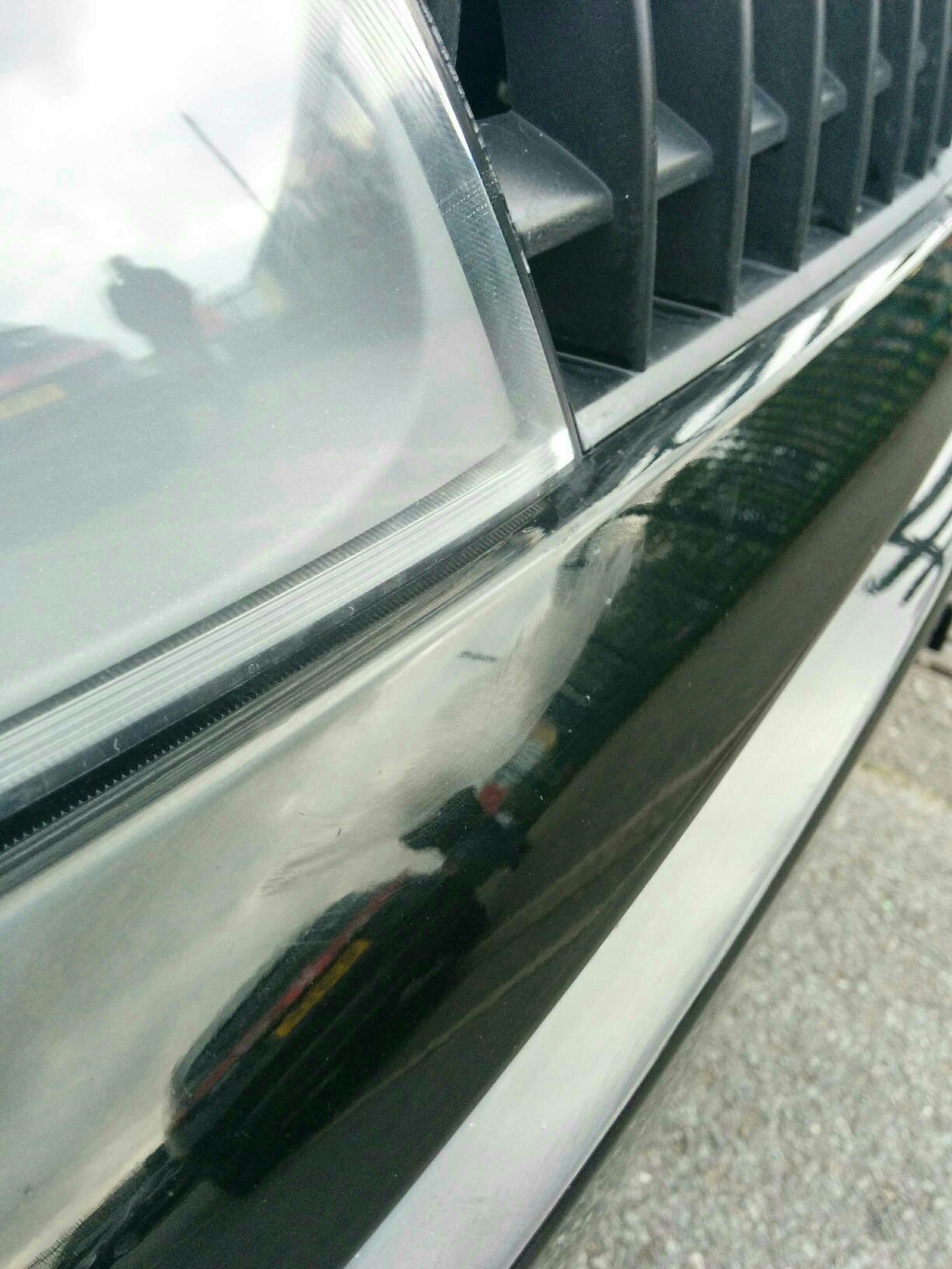

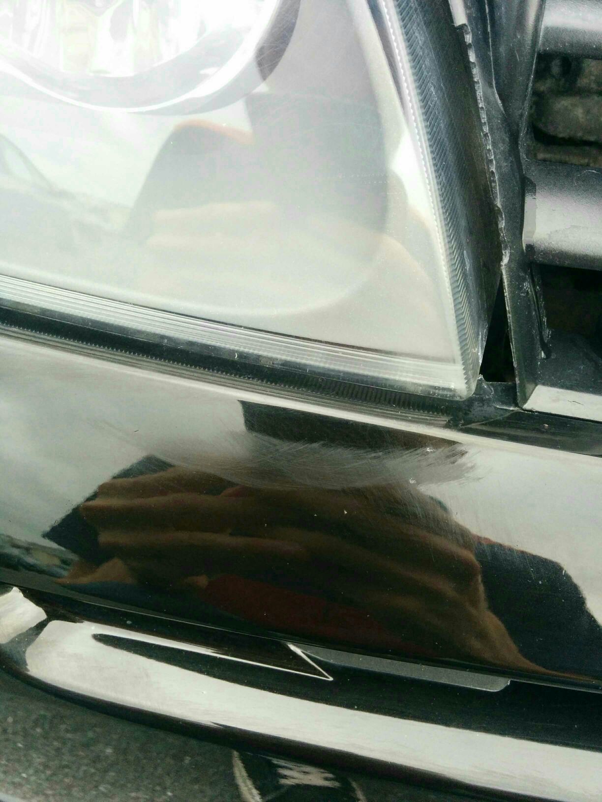

Despite using lots of tape and extra different tape, the headlight restoration kit still went through one part. How can i remove the scuffing mark its made? Thanks
  BG182 FF
Post up a picture and ill let you know if it can be polished out with a DA or if it needs respraying
adamlstr
Wait, I was looking at the bonnet edge. But that might just be reflection.
If it's just what's underneath the headlight, I polished something similar out.
  BG182 FF
The bonnet was a massive stone chip which started to flake off! I've tried a light cutting compound but hasn't shifted it :/ its still a scuff though because the paints still underneath
Whatever you used to polish the headlight up should take that out, it's only marked the surface.

Got it out. I actually used the headlight rubbing compound and the drill attachment and its all gone!
