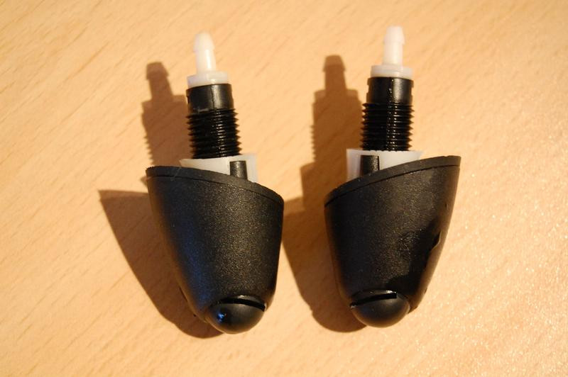

Okay, had a play,
Was trying to get water through them and eventually figured out that there is a rubber seal inside, when pushed it releases the water.

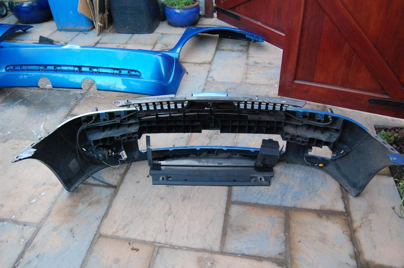

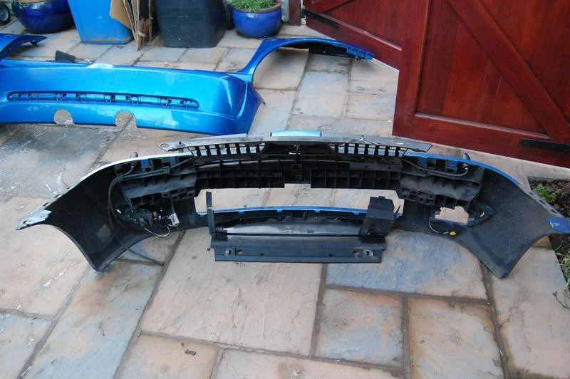

For Daz:
That's how there set up behind the bumper dude.
I have the tubes shown there aswell, want to speak to whoever's having them about the bolts mind. Yet to check how much it will be to post.
Can have the full resolution pic if you want it to have a closer look.

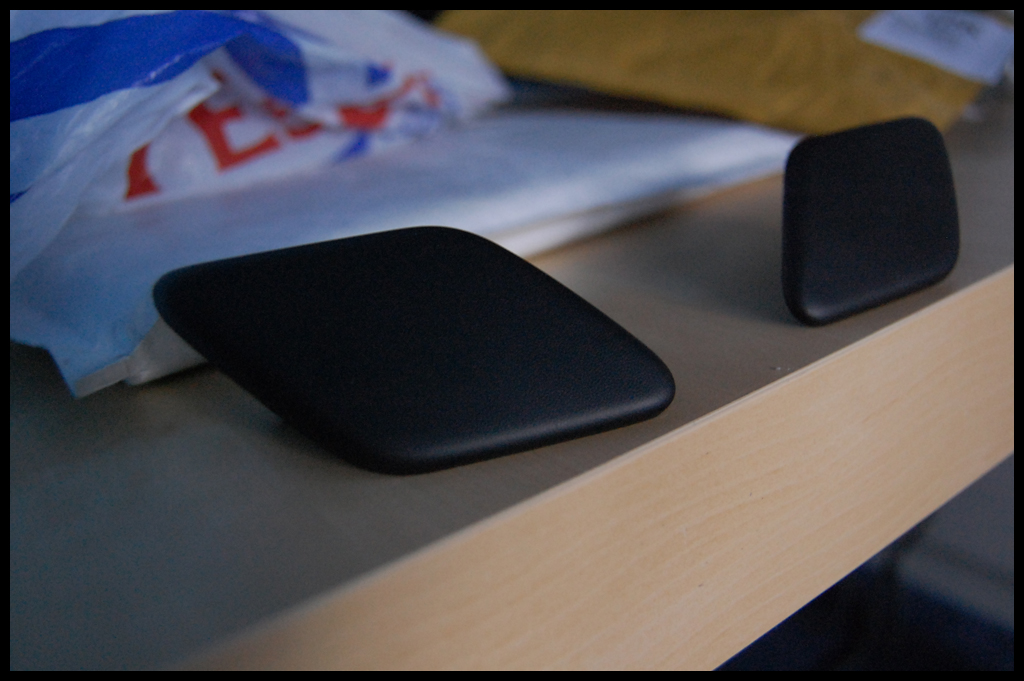

i am in need of 2 of these also (in black), any idea where i could get some from cheers
