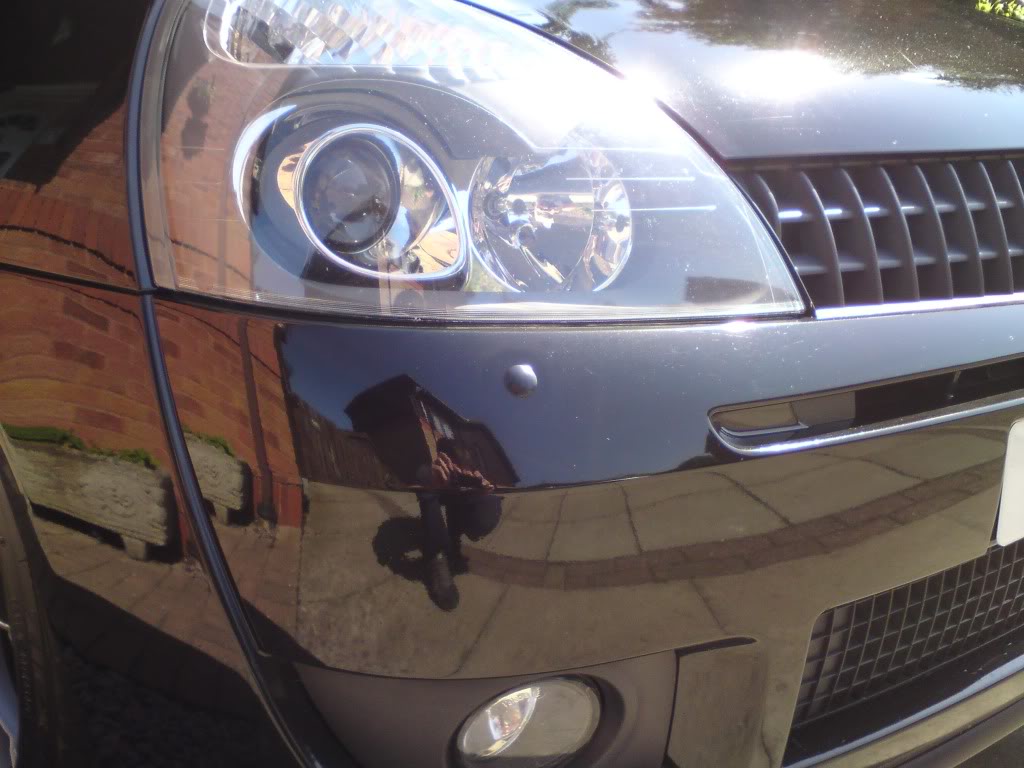

i was sick and tired of leaking headlight washers and with them spraying my car when it was clean! lol. so i plugged up the pipe going to them and removed the washer jets and fitted very cheap rubber gromets. looks great imo. and i have had no trouble at all with 2 mot's. get it done.

halfords dan. thats where i got mine. just make sure you get domed ones so that they finish flush with the bumper :) its another weight saving for you too ;)

sorry mate, just noticed this post.
just measured the hole the washer jets leave and its 14mm. i have a gromet in there thats meant for 13mm holes and it works a treat. the outer diameter of the gromet i have is 20mm. you need to make sure the gromet you buy is at least 20mm overall diameter to cover the hole as it has a notch as well as a hole :) hope it helps.

i think the black gromets i have will look fine on a blue car too. they are tiny, and the washer jets are bloody great black things anyway.
