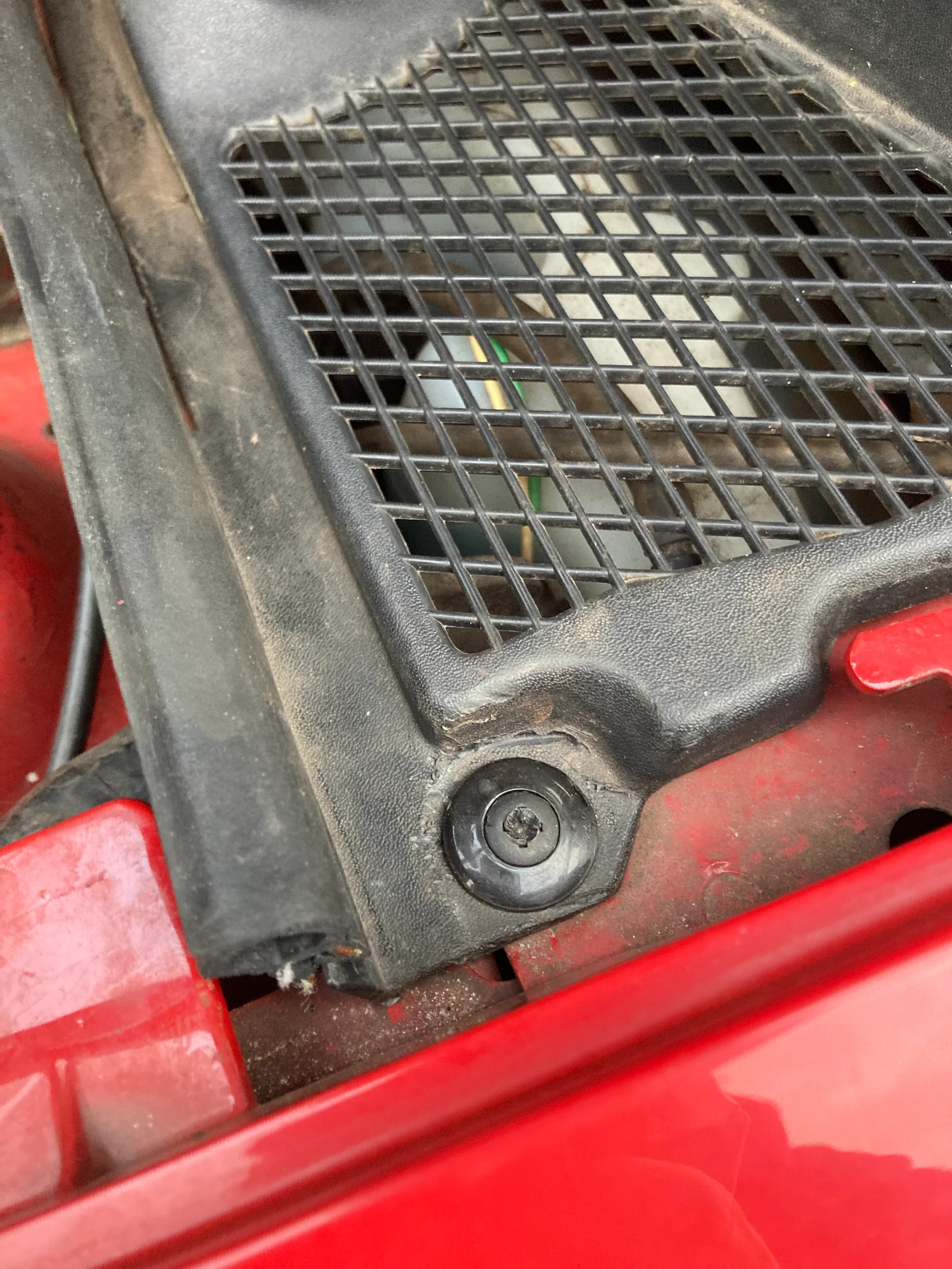

Not sure what on earth is going on here or how much of a moron I'm being- how do you remove these rivets?
They have a philips head that rounded before they'd turn much and they don't want to pop up at all.

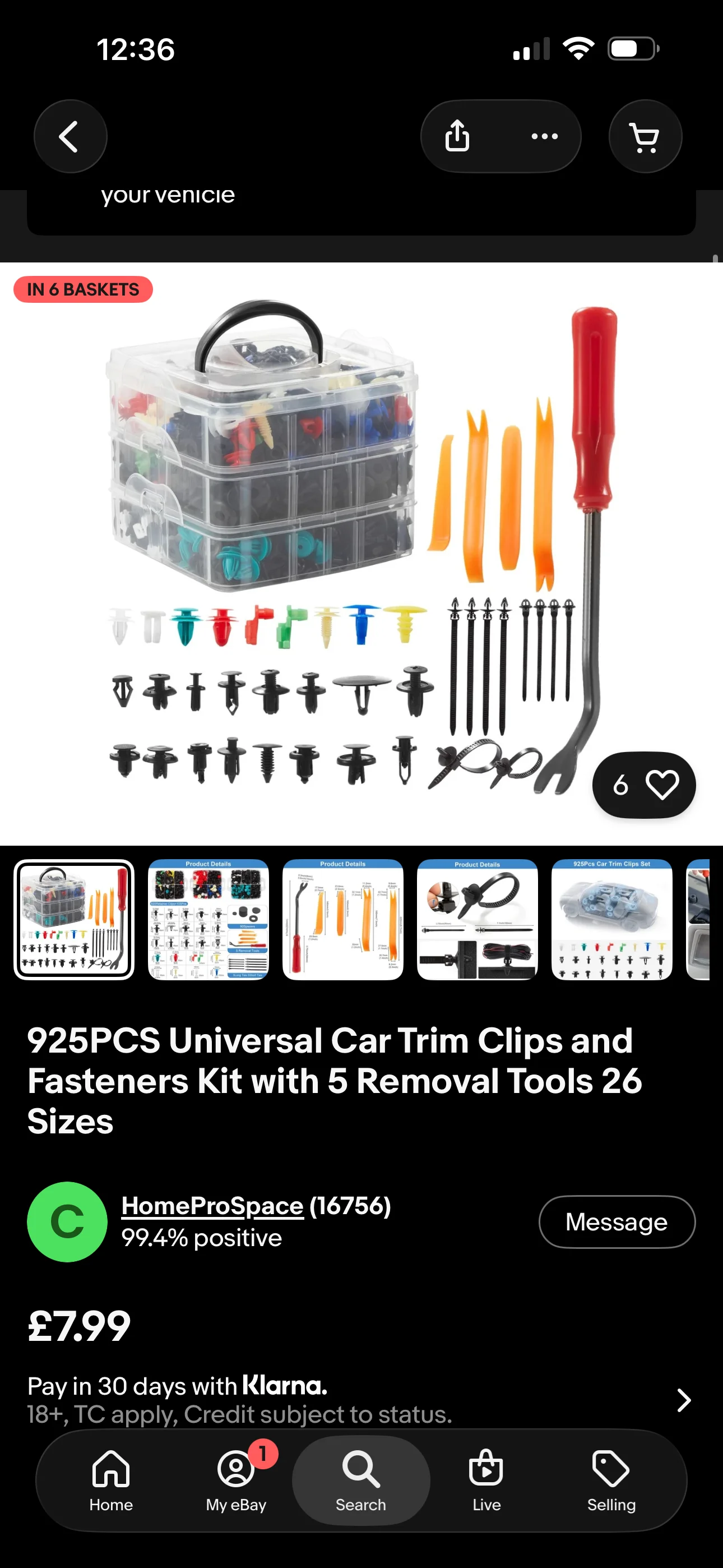

That little screw can be levered out with a small flathead screwdriver. Meanwhile get some trim removal tools like this with a load of fasteners so if you break them you can put some fresh ones in.
The amount I’ve broke is tons so this little kit is a life saver.

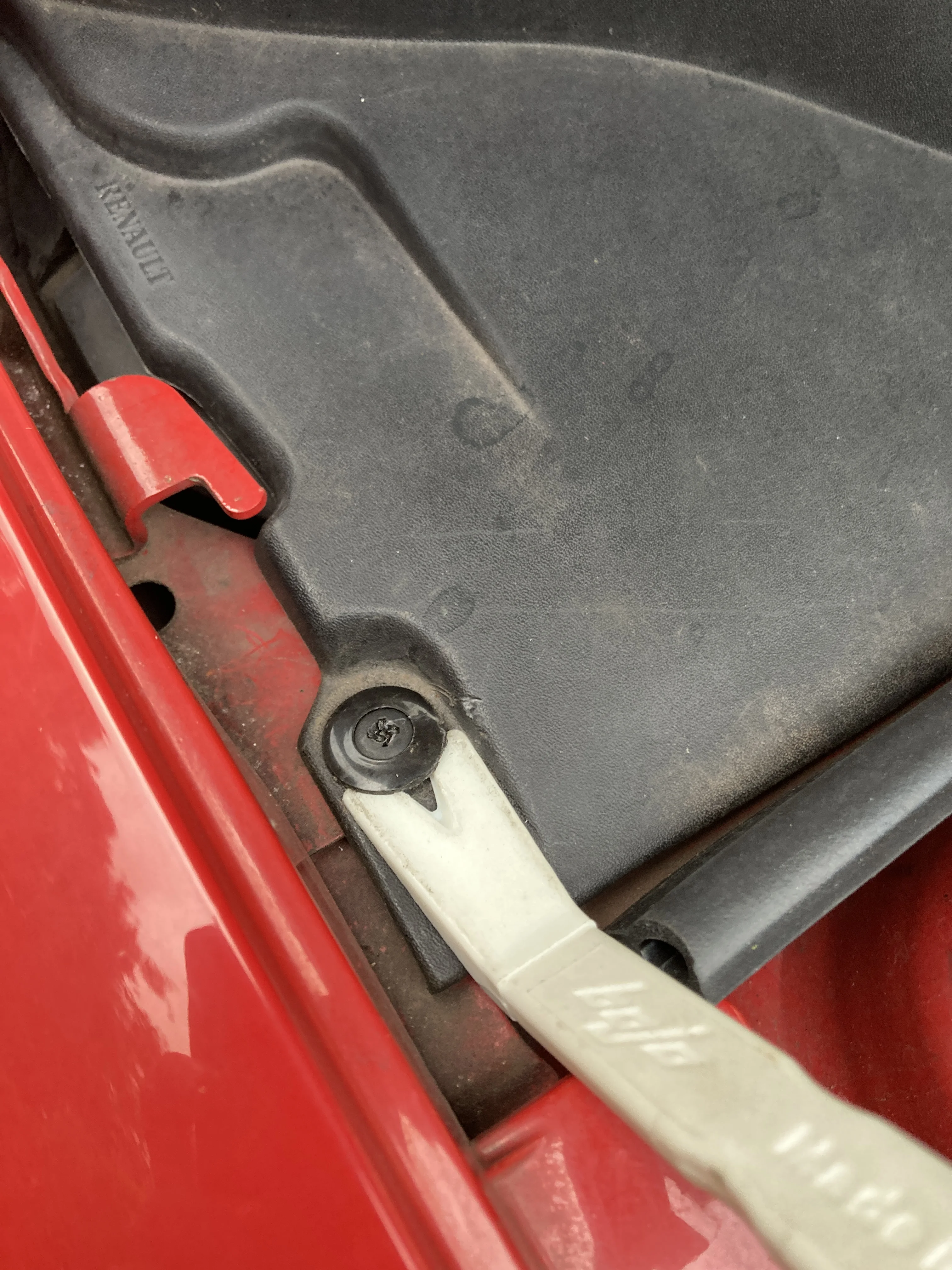

Ok thanks I'll try under the trim and good shout on that kit danke.

that screw takes no effort to remove. You just unwind it with the lightest of touches whilst keeping the collar still.

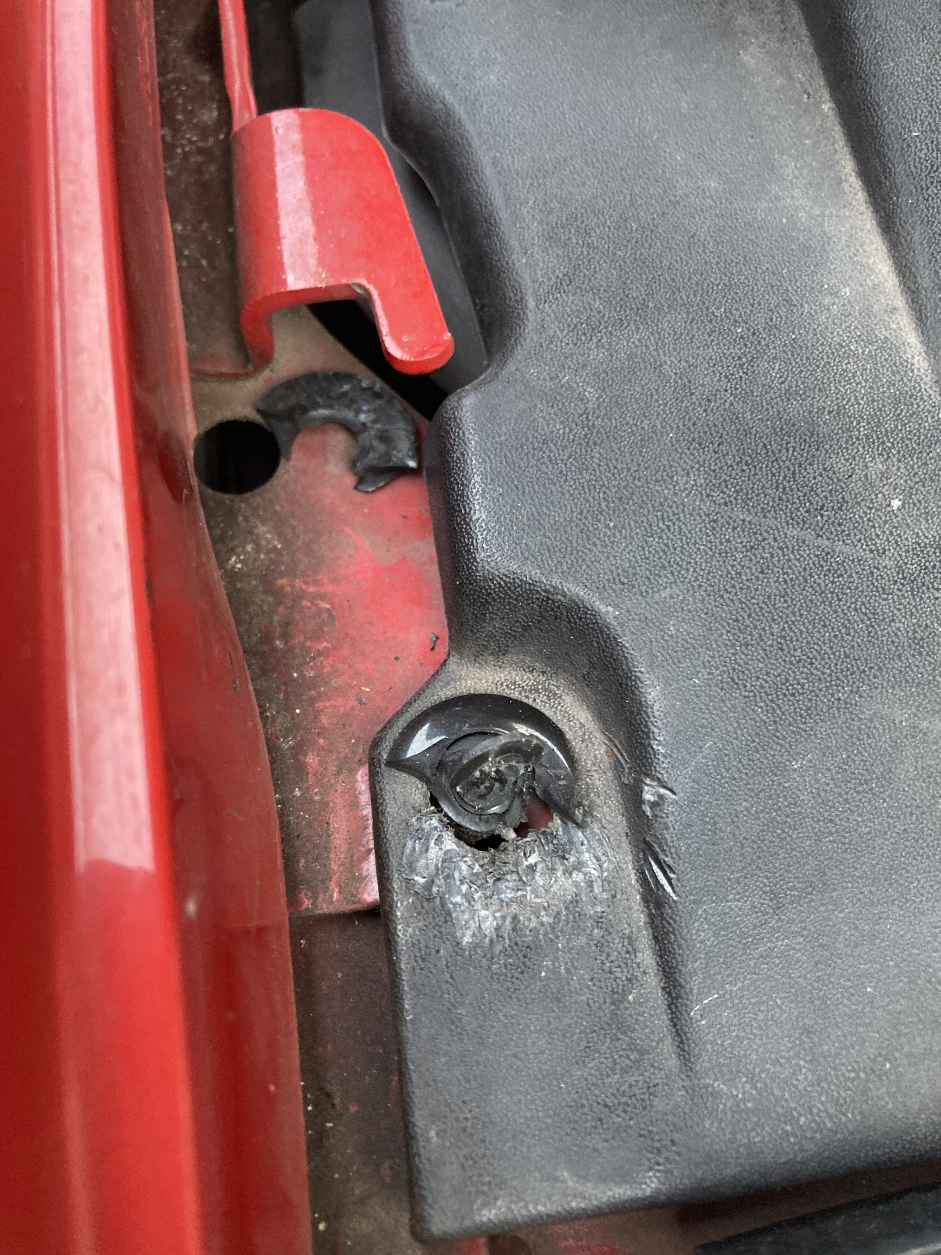

Well mine are somehow fucked because it rounded before turning much at all. One was already rounded by someone else so I took care with this one and the material was so soft.
Yeah, this must have been the worst pop rivets ever fitted to one of these.
There's no way it was popping out. Levered it from all angles then just had to destroy it with a sharp screwdriver. Still needed a good pull with pliers to get the centre bit out, pain in the c**t.
Now replaced with something more appropriate that can actually just be unscrewed, who'd have thought.

Cheers I'll try the screw first on the other side.
The kit mentioned further back actually had better clips that were an appropriate size so I'll stick the same in that side.
