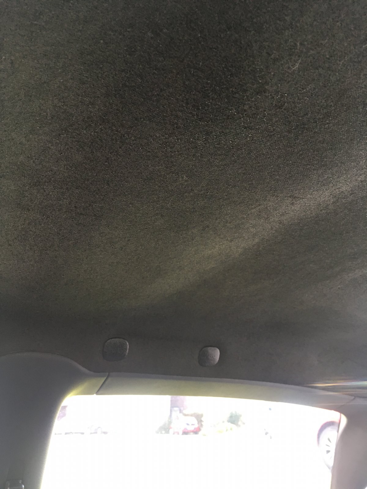

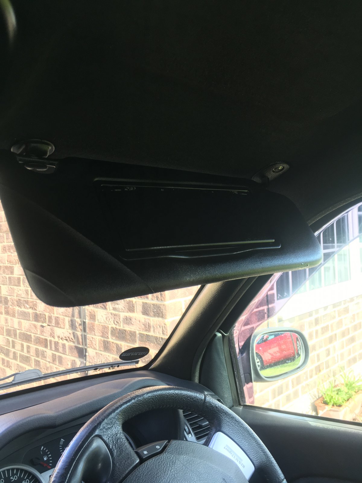

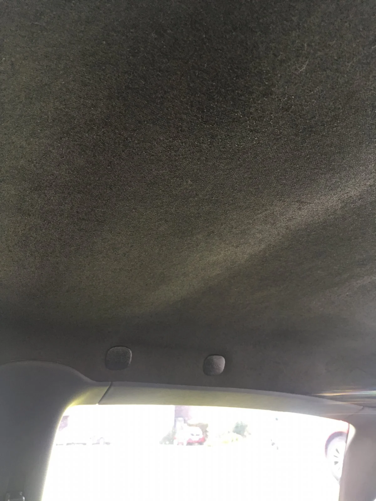

I sprayed mine done all interior dying seats next week looks good just do it in the open as I did mine in my shed nearly killed myself with the fumes
