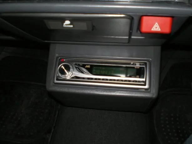

Managed to get it sorted, found a power lead that would have been used of there was a fag lighter, snipped that, extended it and connected it to the yellow lead on the HU. :D :D
Advice much appreciated.
  133/225/CLS AMG
For £70, I definitely thought it was worth doing. Especially considering that the standard speakers sound 100 times better with this headunit. Goes to show how pants the OE one was.
