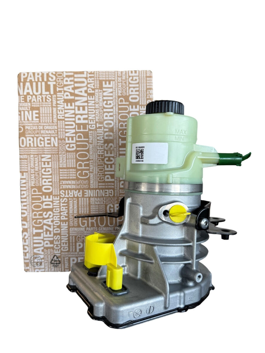

I'm in the process of swapping the old epas with an electric epas pump, in the trunk.
I Have the same one as pictured, from a Ford, but it's a generic TRW unit.
It has 2 connectors, with 5 pins in total. Two big gauge wire ( suppose positive and negative) and a connector with 3 smaller wires.
After googling the s**t out of this, i sort of understand one of the thin wires needs to be connected to positive, however, after bench testing it with a battery charger, any this wire i connect to +12 doesn't make it work. Is it a PWM system? Everything I've tried doesn't seem to work.
The 3 wires are ign live 12v wake up , the other two are CAN high & CAN low .
Not easily bypassed without the use of a can controller box to mimic the ecu as such.
Try looking for some sort of controller for it .
