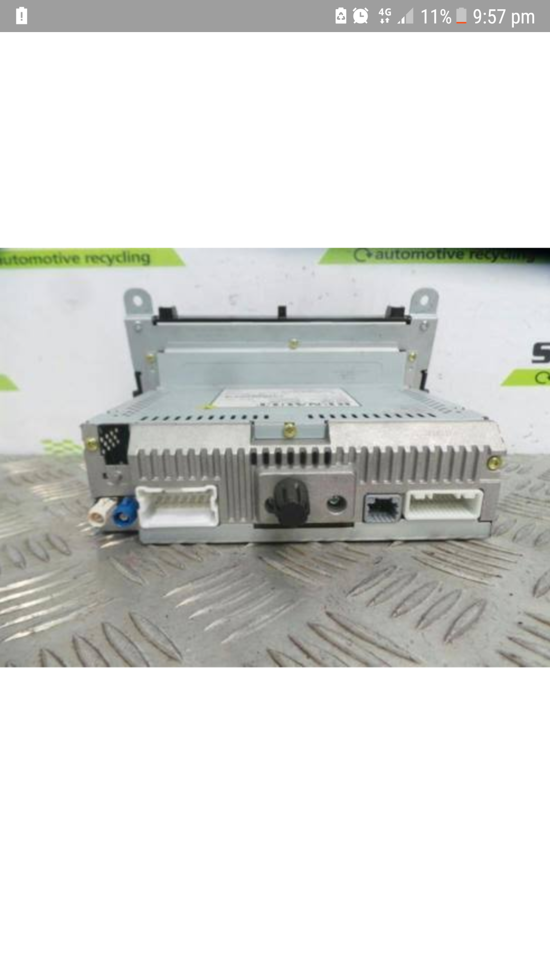

Hello I'm new to the page but I am a big fan of clios and I have one my self but I am having trouble finding an adapter to install a sub Becouse I don't want to change the existing head unit but my car is a 66plate and this is why need some sort of adapter or some knolage on how to fit a sub.

You'll lose audio to the rear speakers, using the signal to those as your "sub out".
Speaker-level input is available on a lot of subs and amps, which you then fettle to adjust tone.
Honestly though, you'd be better off with the cheapest piece of LED-riddled tat from Halfords than persevering with the OEM unit.
