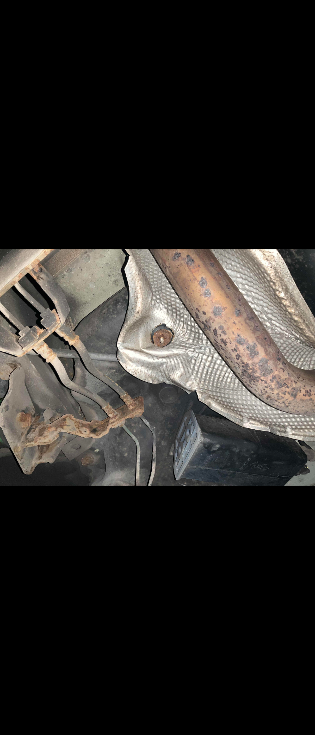

Got the rattle, has anyone tried one of those heat shield repair kits off the internet? Or should I go the whole hog and get a new one?
Offending hole pictured.
Cheers
