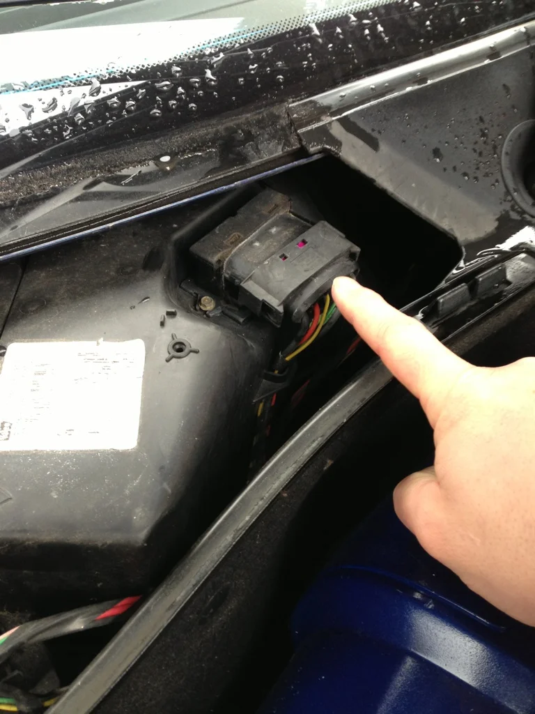

Is it this part??

Heard good things about him on here.. he strips it down and rebuilds them iirc
Don't buy any cheapo copies off ebay or the like as they are about as good as a bost genuine one.
Have you bridged pins 1 and 5 to check it definatly is the resistor at fault.
