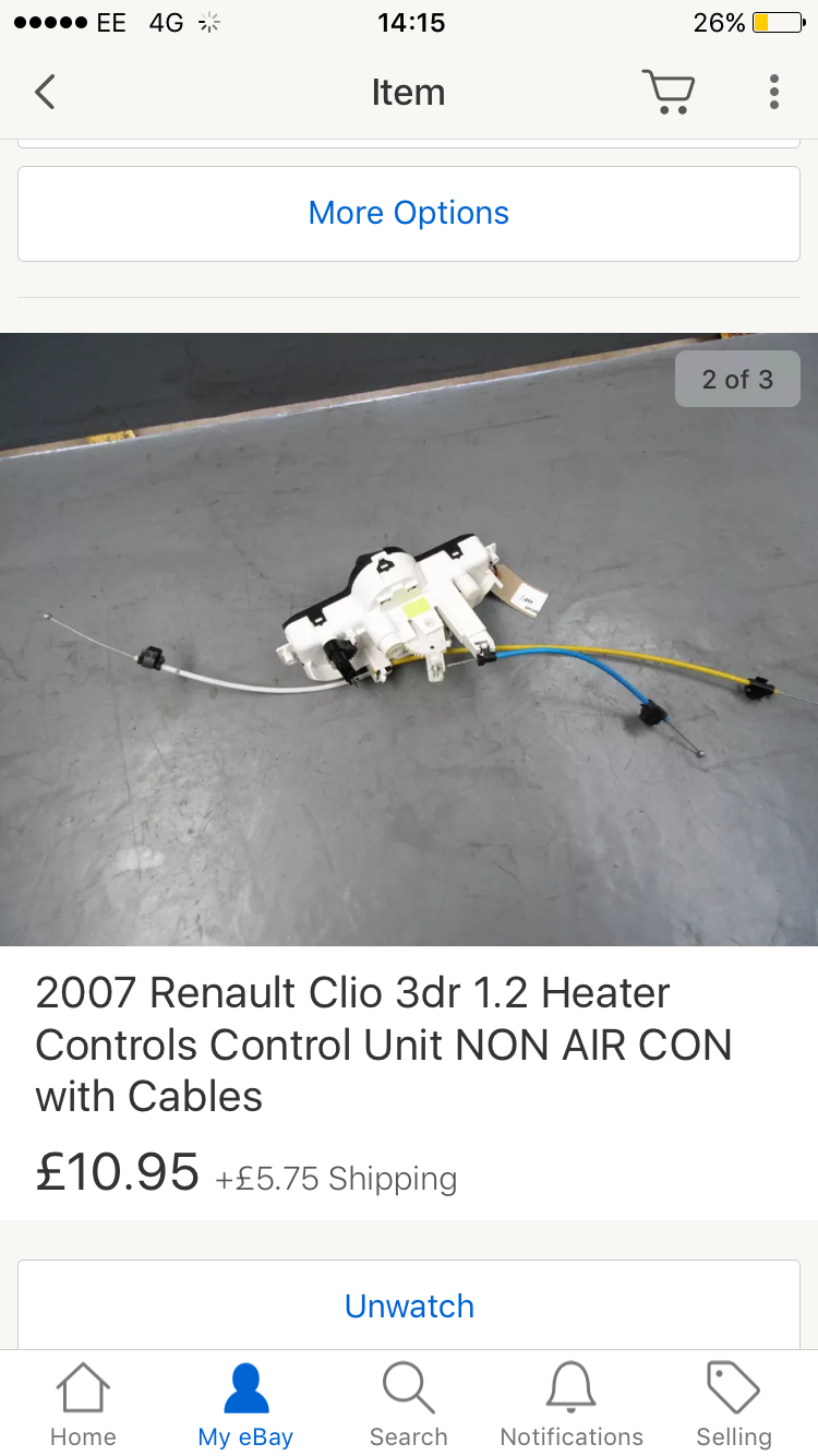

I've brought a new heater control, I believe I need a new resistor pack as well, does that sound right?
Here's the new one
Ah its not a 1#2 scrap mine lol

Yeah I brought the heater controls because the others get stuck on certain settings, only £15 not to sad about that
