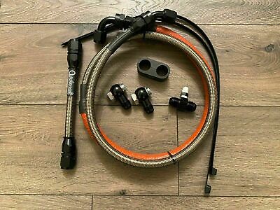

He has the 172 ph2 for 3 years, at first the car was ok, but soon after the steering became heavier and now it feels like it lacks power steering altogether.
He changed the power steering pump, the steering rack was refurbished 2 weeks ago, so the fluid is new but still no joy. The guys that did the rack refurb said that the only thing left that could cause this are the hoses.
These I guess :
Any other thoughts?
