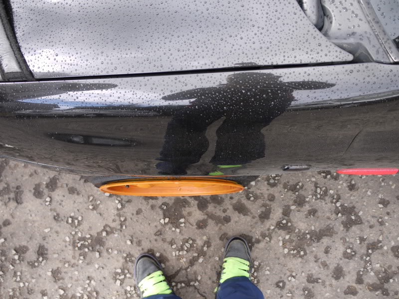

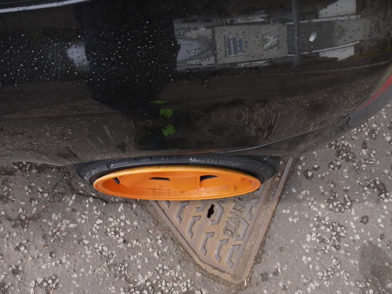

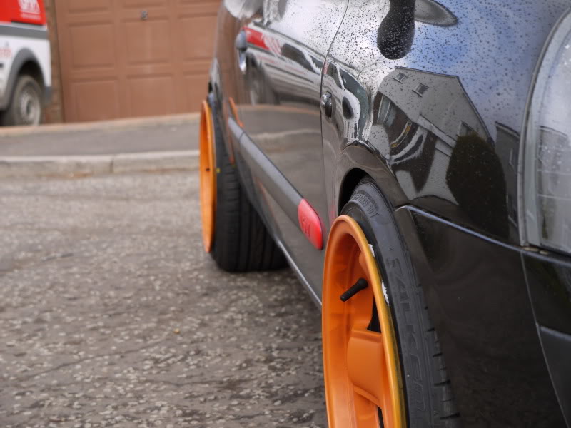

running wheels flush with arches with camber and low is no issue at all :D
Not a 182 though is it ;) geometry on the 182 is NOT the same as a 172 or a non RS Mk2
I'm not saying it's impossible just that getting a "hellaflush" level of fitment will be a lot of work and will compromise the handling/ride/practicality of the car.

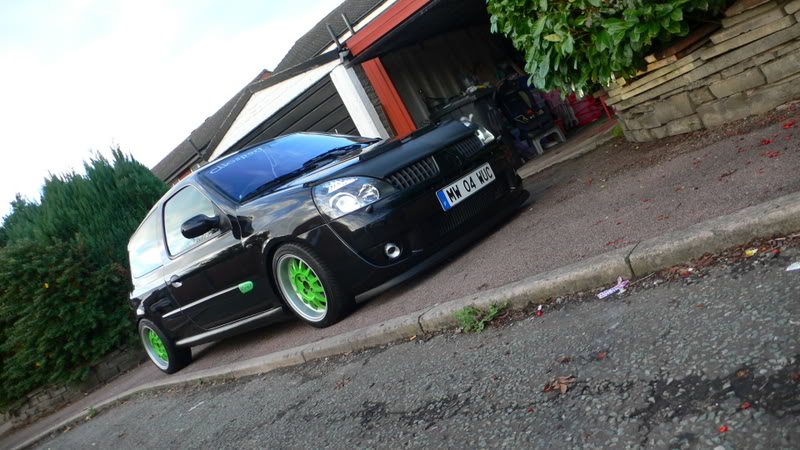

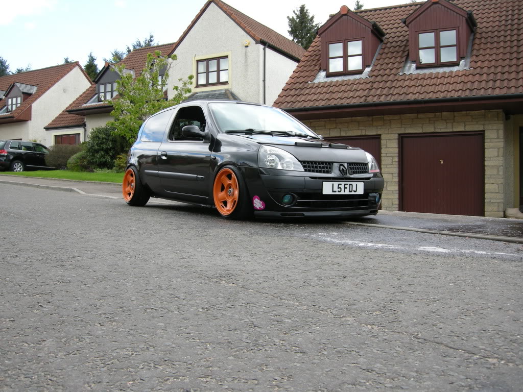

Neils 172 is a phase one which doesn't have the wing/bumper brackets that a phase 2 or 182 has. None of these other pics are of a 182 yet either....
As said, the front wing/bumper will take a lot of chopping to enable you to be flush, so to speak.

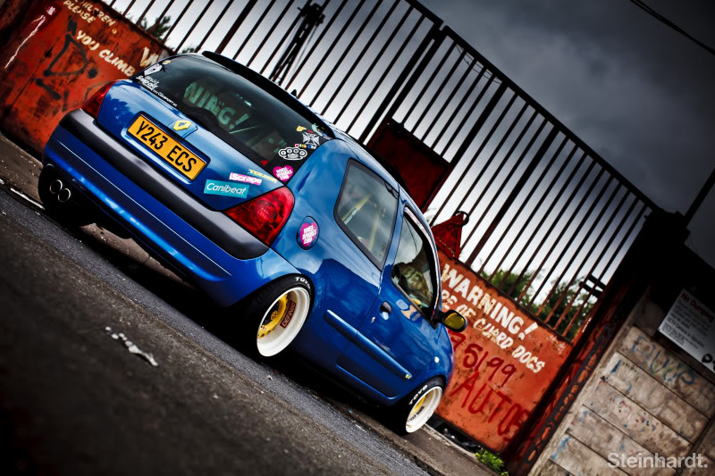

Really want to see it done well, though! The first picture posted by Alex is probably the best I've seen tbh.

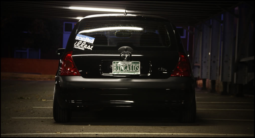

I'd agree on the non RS Alex posted being the closest, front looks better than the rear though, way too much offset for my taste at the back I'd prefer to see smaller diameter, less offset with more of a drop and a touch of camber.
