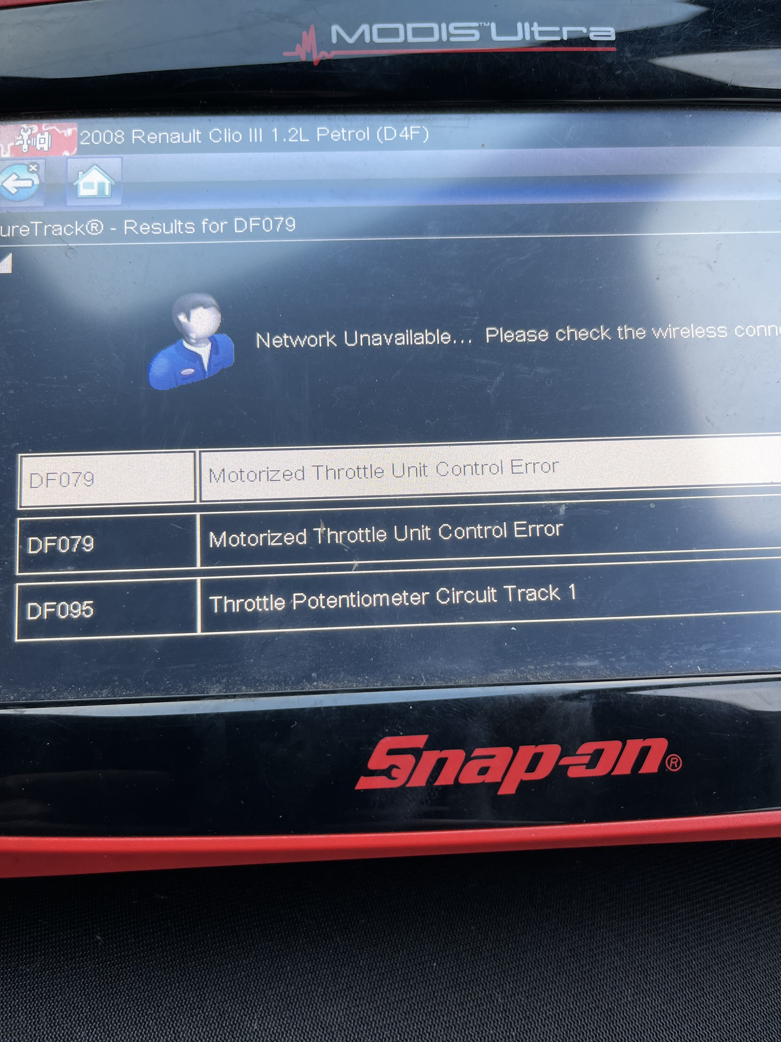

Development…….. mates snapon equip
Came up with …
So to conclude this post ,
The throttle pedal and position sensor fried because i used a smart charger and failed to disconnect the battery from the car
Not sure how this happened, combination of fragile Renault electronics and a battery charger that likes to up the voltage.
Make sure you’re charging with the neg lead disconnected at least .
