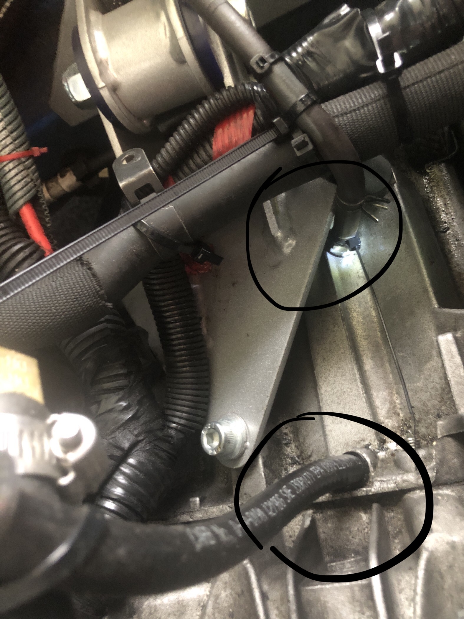

I was at the track today and lost some oil. The gearbox breather had popped out. (Unfortunately it binds a bit with the PMS mount).
After a bit of googling for issues it looks like all JC5 boxes have one breather…… but I have two…..surely not.
Anyone else seen this??

That doesn’t look factory to me.
The one on the left is the factory pipe, the one binding with the bracket has been drilled and tapped. Some people fit oil coolers to their gearboxes, so that’s probably what that’s for. @FrogJam Motorsport have just fitted one to theirs.
