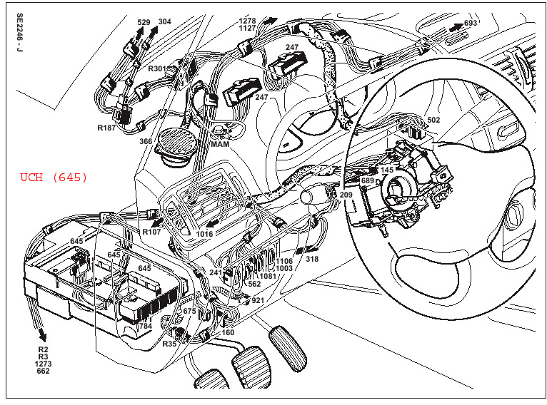

Dont ever jump start 172's - my guess is a blown fuse / relay are worst case scenario the UCH control unit
  RenaultSport clio 172 mk2
thanks matt..
've check the UCH fuse in the passager side already,
there're no blownfuse, is there other place for relay and fuse?
i cant find it in owner's manual...
  MERCEDES CLS AMG

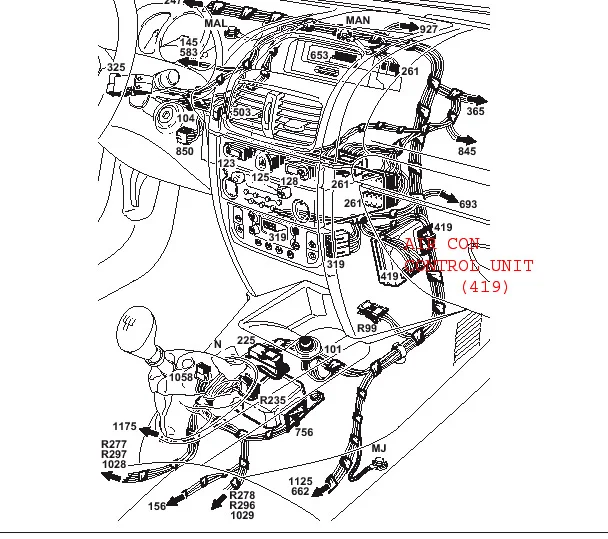

its actually built into the UCH - you have to replace the complete unit. Have you checked to see if there is a live feed from the wire connecting to the air con control ? does the control unit work ?
the control unit work.. btw what's DCH?

The noise will be coming from the UCH or the Air con control unit, The UCH is an all in one system and designed to be replaced as a whole if any of its circuity gets damaged

finally got mine fixed today!
Air con control unit's not working probably, i got this parts for around 100pound included nabour in HK.
