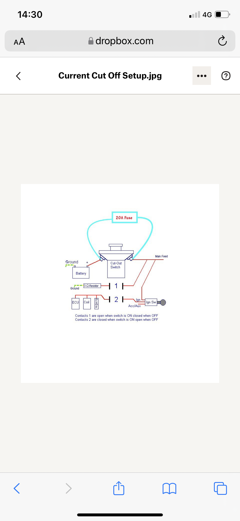

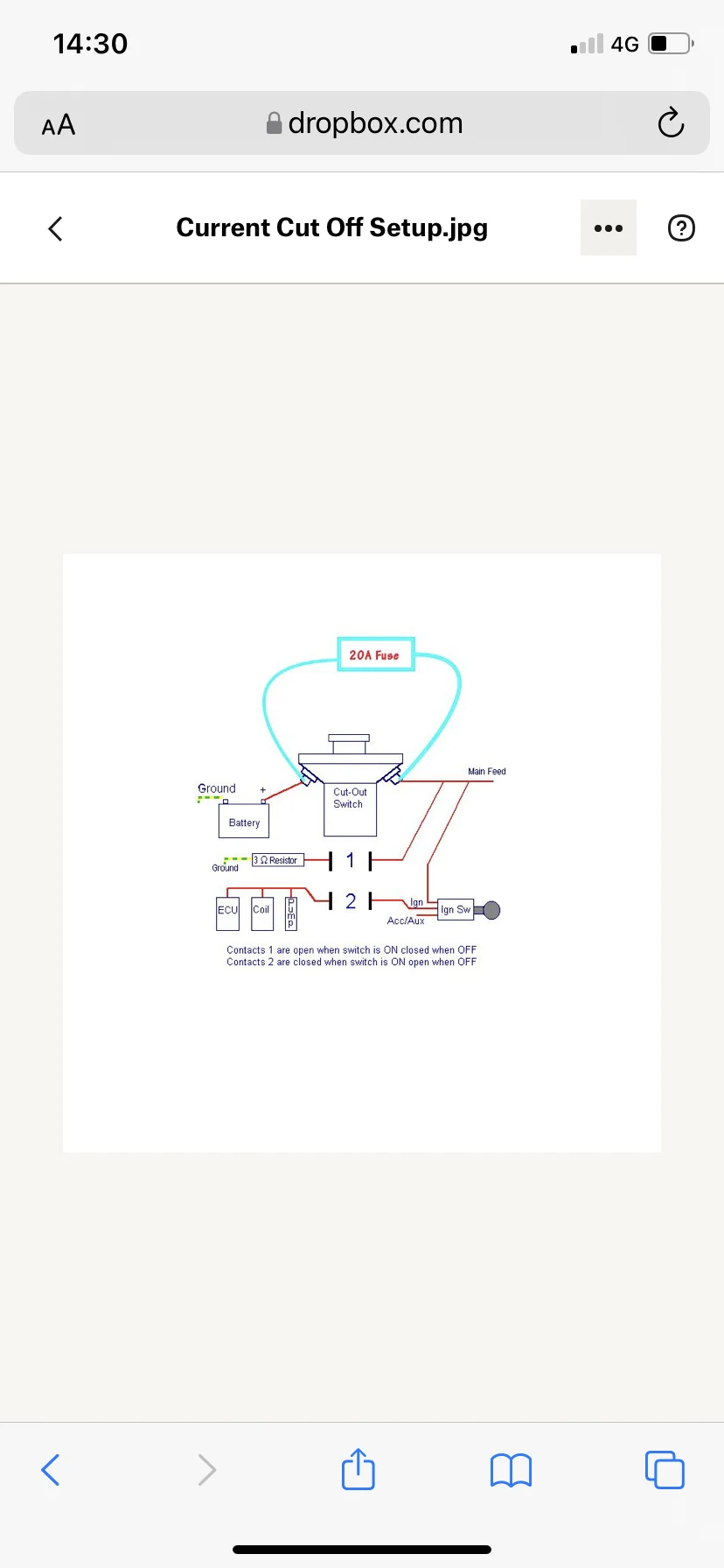

So unfortunately my 172 Turbo died yesterday and at present I’m stumped as to why it won’t restart. I’ll start with the story that got me to this point!
So yesterday I took the car to the Sunday scramble, drove there in the morning no issues at all. When I got there I turned off the car then disconnected the kill switch and all was good.
When I came back to the car, when switching the kill switch back on it cracked in half, meaning the key wouldn’t stay in it to be able to keep the ignition on. I managed to rig something with cable ties to keep the ignition on.
Now at this point is where my troubles began, ignition on and the light keeps flashing on the dash indicating it can’t see the key. Managed to reset that but now the light stays solid and still no start. I have checked and cleaned up the connections in the engine bay fuse box still with no start.
It’s also worth noting that the central locking doesn’t work off the key it worked once or twice but now even with a new battery in the key the little led doesn’t light up. Also today while checking it out the electrical fault light has come on too.
If I’m right a solid light indicates a power/earth or canbus issue. My next course of action is the check the wires and in and out of the ecu to make sure they’re all okay.
Am I going down the right route? Or anything else I should be checking?
