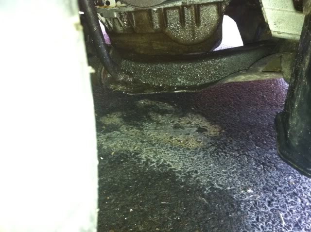

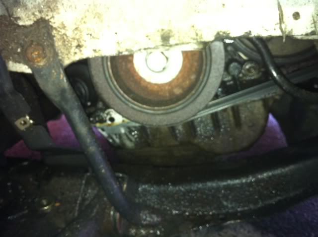

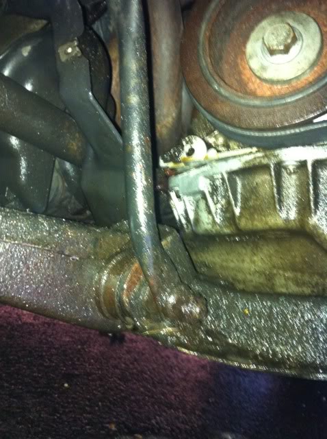

Any ideas? (Ph1 172)
Thanks,
Dan.
a mate of mine said if im ever leaking creamy oil ( like what you have ) you have mositure in your oil. meaning teres a chance headgasket , not good news really
Nothing to do with the fact that its leaking oil and its raining/wet roads?
I would say sump gasket. gasket is cheap but taking the subframe off to change it isn't.:eek:
best to get it in a dry place, clean it all up underneath and let the car run.
you should see where the leak is coming from then.
sump gasket, crank seals perhaps?
Needs further investigation, clean it all up and it will give you a better idea where the leak is coming from.
You need to go from the highest point, you checked under the upper inlet? As the bolts that hold the rocker/cams in leak, I did these, cam seal and sump gasket to cure mine, as said it's creamy because if the wet road
dude what colour is the oil hard to tell, black engine, red power steering, it really depends how high up the oil is see where the highest point there is oil check levels and see which ones drop.
