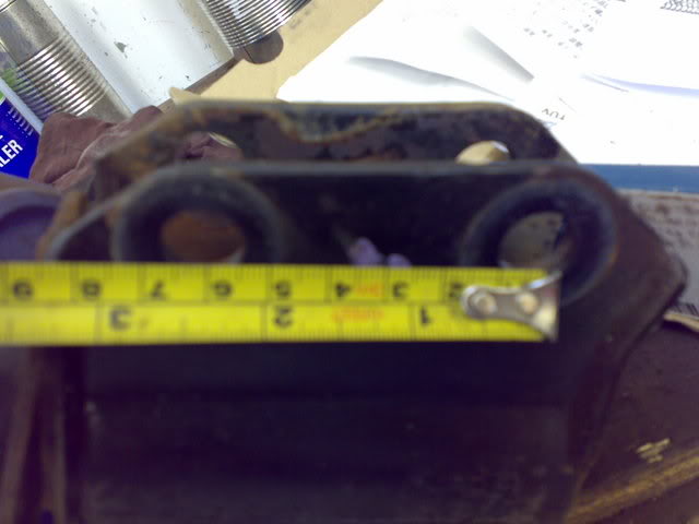

joshread Aug 16, 2008 #1 im looking at buying a set but not sure which size hole spacing i need. do i just need to jack up the car, take off a wheel and measure somethihng?
Gaz_ ClioSport Club Member Car Extreme mode Aug 16, 2008 #2 Yep, here. This is a 182 strut (cup packed measure 60mm)
B bmh.01 Car BMW M135i Aug 16, 2008 #3 Will most probably be 58mm but you need to check as they could be 52mm.
