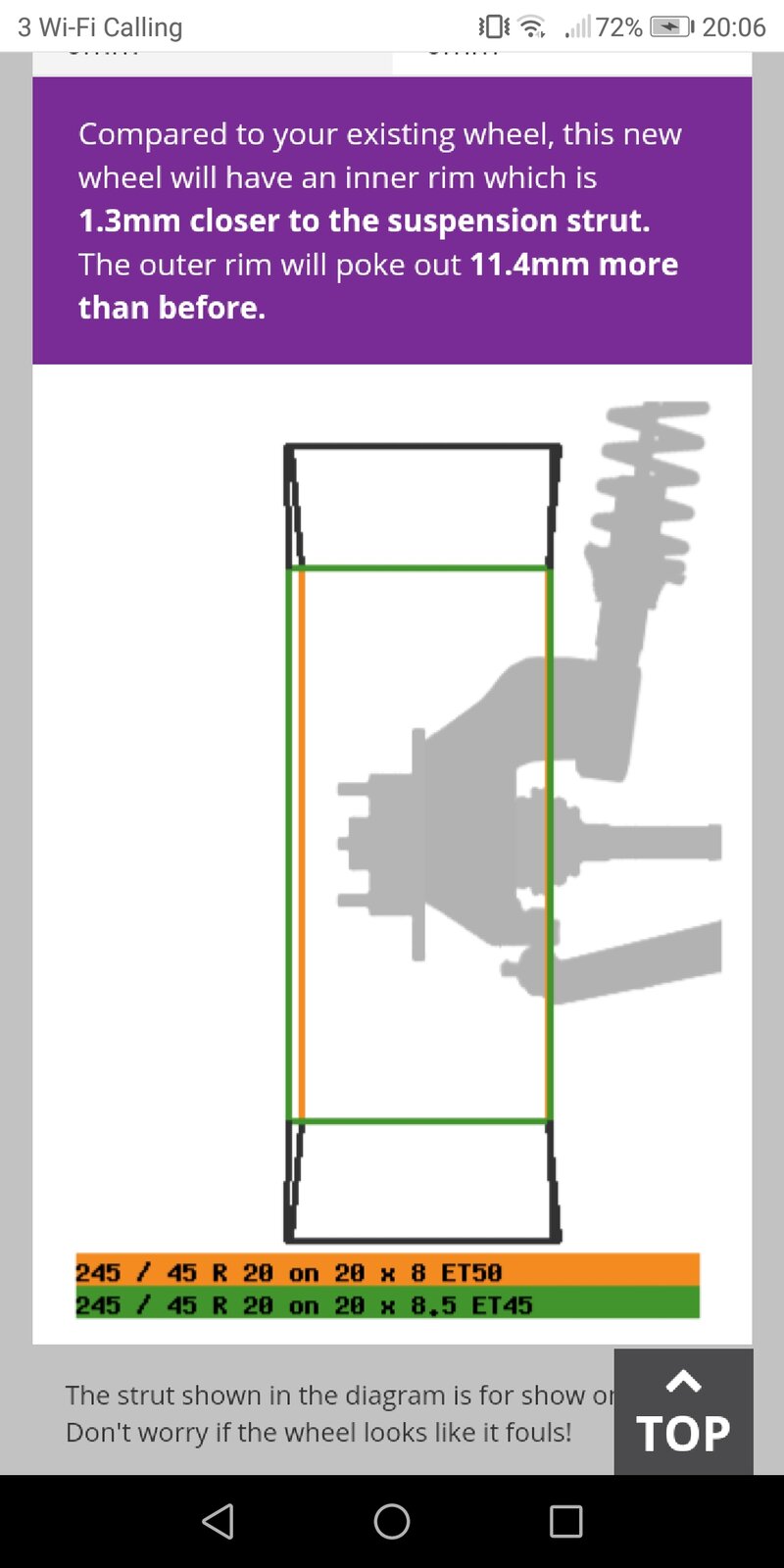

Hi everyone, so I ordered and fitted some aftermarket winter alloys and tyres to my old chaps Volvo Xc40... We ordered the same 20 inch - 245 45 20 alloys/tyres as fitted as standard to not disturb the geometry etc...
When I fitted the wheels I noticed they stick out more than the standard wheels therefore a wider track... After research it turns out the new alloys are 8.5j 20 inch rims and the Volvo ones are 8j 20 inch.. I've typed in the offsets and measurements into a calculator and it came up with this info... Is this setup likely to cause any issues regarding scrub radius etc? It drives perfectly fine and looks quite bad ass so alls well if the experts here can clarify the changes are negligible...

The -45 offset of the new wheels is lower than the -50 offset of the original wheels, meaning the wheels will sit slightly further out - and with the half-inch of extra width on the new wheels, this means you've only got 1.3mm of the extra width on the inner side of the wheels, so you won't have any clearance issues, and the extra width is therefore instead sitting on the outside of the wheels, so will fill the arches better (as you've noticed).
Things changing might all depend on if you've fitted wider tyres to the wheels, though. - you've said they are the same width as standard, so they might have sidewalls that are a bit more level with the rim of the wheel itself (rather than ballooning out past it a little) due to a touch of 'stretch', so beware kerbs ;)
TL;DR - you'll be fine, the differences are minimal.

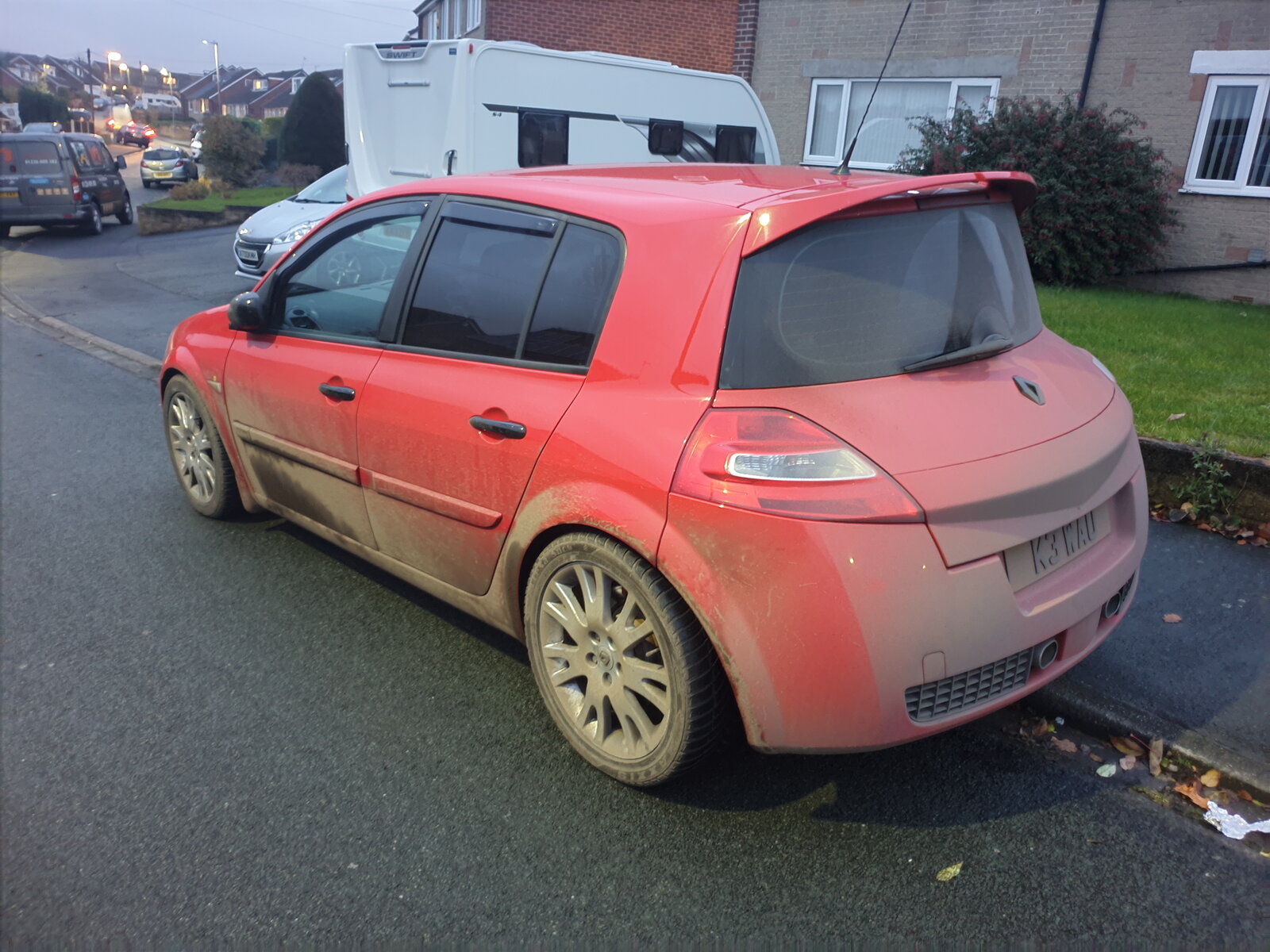

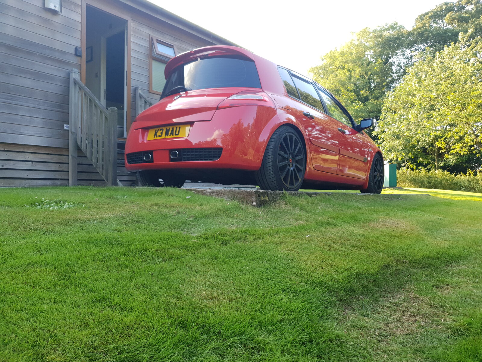

Mine seems to drive loads better on Laguna wheels which are way lower offset, 1" smaller and .5J smaller
Before
After
