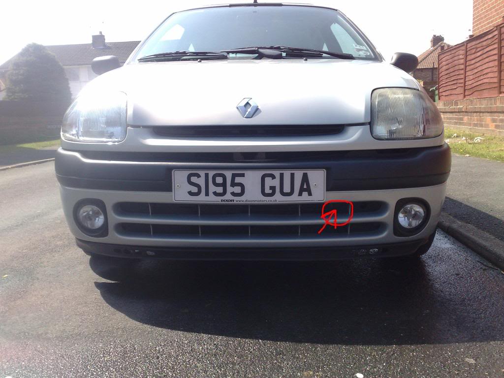

excellent - she's off to look in the boot. do you know which side of the car that it would screw to at the front and where? all other pics of the sports variants I can see on here seem to be at the passenger side just off from the front fogs - I'm assuming it must be around the same area that it screws into?

If its the same as the Ph1
Then its just behind the 1st opening on the bumper.

she managed to find it, though the threads have all rusted behind the bumper so it won't work anyway :(
