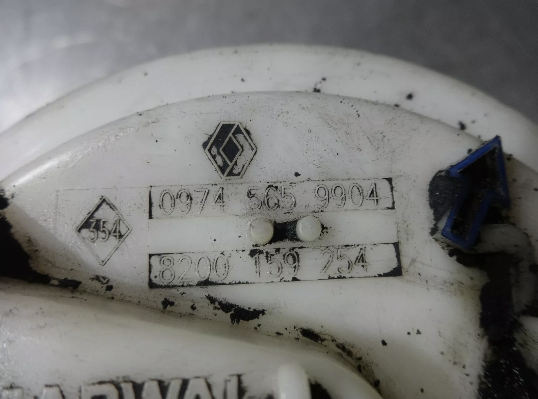

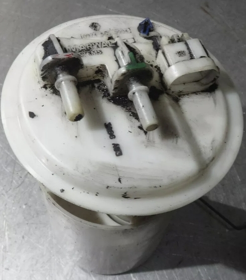

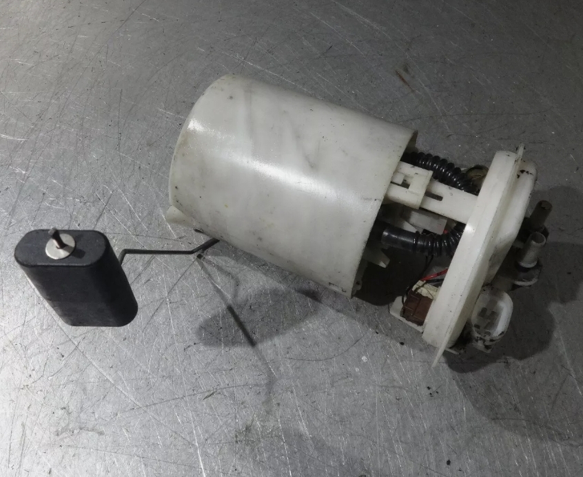

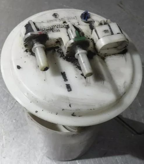

I've been after a mk1 172 fuel pump assembly for my turbo conversion and think I may have found one but hoping someone can confirm, as the ad is a bit generic:
Renault Clio Sport 172/182 2001-2006 Fuel Pump 8200159254
Here's the pics. This looks like a feed and return to me.
TIA 😁

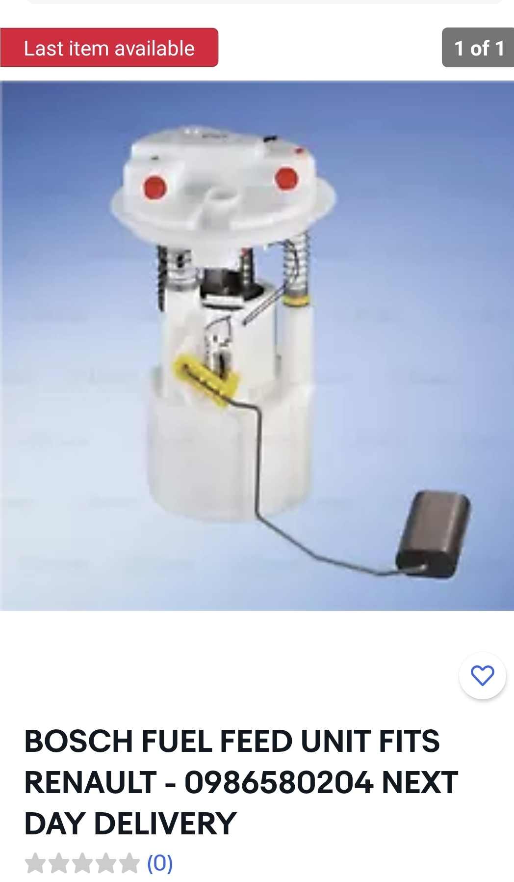

Quick update - So I did a conversion on my existing pump and fitted a return feed. Never fully sealed and would get a whiff of fuel if I filled up the tank, then the motor started to intermittently fail.
I've replaced it with a Bosch pump assembly that replicates the phase 1 assy with built in return.
Direct bolt in and working lovely!
For anyone interested the Bosch part number is: 0986580204
(And yes the 172 is on the fitment list 😁)
I got a new old stock one for £47 delivered next day.
Happy with that little find!
