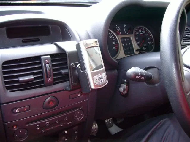

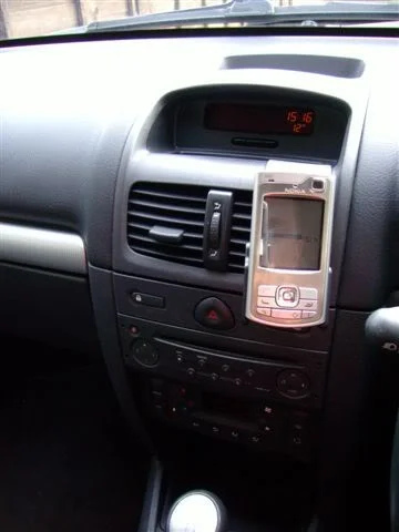

Pics coming up soon. I've recently bought a Brodit proclip with an N80 holder too.

That's a Brodit proclip for a Clio dashboard vent mount a N80 passive tilt & swivel holder by the way.
  BMW M135i

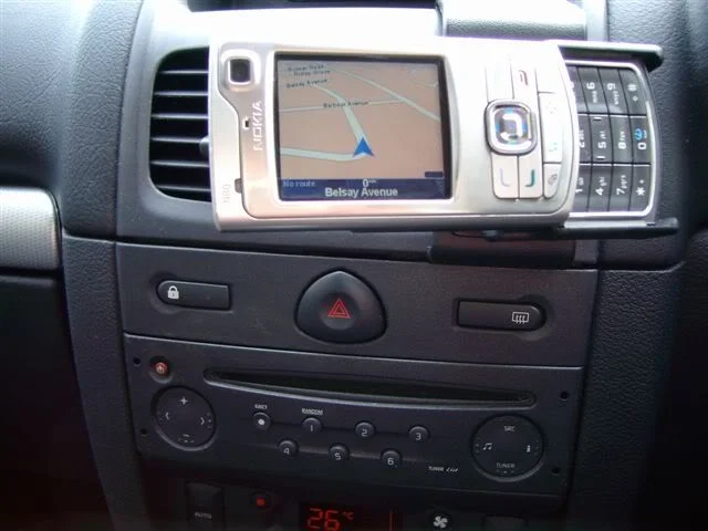

How'd you turn tomtom on its side like that?

bmh01... it's not so much that tomtom is on it's side, it's an app I have for the N80 which allows you to turn the screen to landscape, it's called 'rotateMe'. It's a pain to get working but is good when you do. On 50% zoom, in landscape, you can see pretty much a whole webpage only scrolling up and down rather than left and right too. So useful.
http://www.cliosport.net/forum/showthread.php?t=203954&highlight=rotate+n80
I actually prefer tomtom in portrait though.
