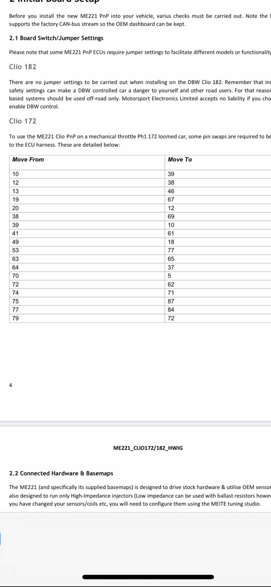

The pins need to be swapped around for the ph1 (which mine is) due to the cable throttle not fbw
It's in the guide attached :)
I've got the list of pins that need the be swapped, assuming this is on the stock plug as I don't have any wiring with the ME221. Is this right?
yes you'll need to repin the plug going into the ecu
i ran the bike injectors on my own car - albeit not a clio. It's pretty easy to change the injector size in MEITE.
Okay yeah, I never got that guide (turns out I was one of the OG's before the guide came out)
I had to do the same thing as I went from fbw to cable throttle as was using the ph1 tb.
The pins in the stock harness connector had to be altered. Nothing had to be done to the me221 ecu itself, at all.

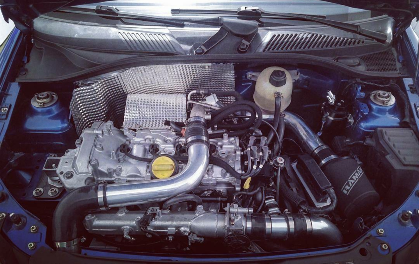

Fair, yeah makes sense :) thanks! Do you have a photo of the ECU mounted at all please? Apparently it fits in the stock ECU housing? Assuming the OE ECU needs to be removed for that. I was led to believe this was a piggyback application but not a big deal as long as everything runs as it should
Mine was a different layout and a very old design so I doubt it would be applicable to you mate. Think the newer one actually looks like an ecu, mine was a tin box basically. Will see if I can find a pic
Just to the left of the air filter
This is what I have:
Interesting, thanks for that. Did you have to custom fabricate the brackets to mount it there?
& what's the black reservoir pot for (where the ECU/power steering is usually positioned)
Sorry for 20 questions
No worries, that was an oil catch can
I got some brackets with the ecu or actually I asked for them from a guy called chip who was part running the group buybwith Dan Potter.they are literally just crappy L brackets that slide in the me221 rails. Mine was the same as yours by the looks of it .i then mounted it to the top of the gearbox mount where the battery used to go.
