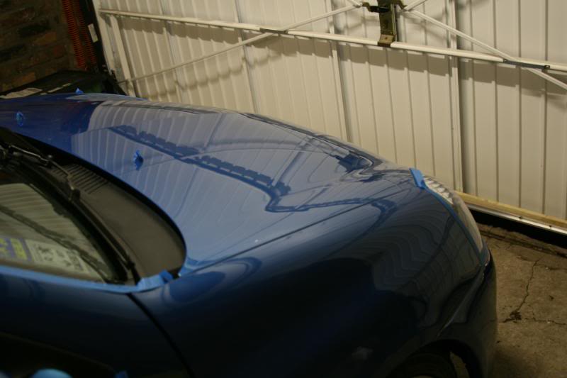

This was the shine on my car with tough coat and nattys over the top.
Looks great that, can't argue one bit for 15 quid, willing to give it a try! Seems I would be best going for the White paste for racing blue as it seems that the blue paste is suited more to darker colours, although again I have absolutely no idea how much difference this would really make haha.

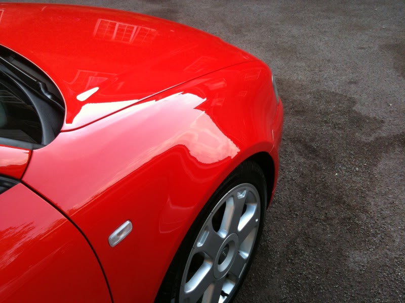

I would point you to something spray and wipe @JPJ89 - something like C2V3 by GTechniq, AF ToughCoat or CarPro Reload.
My old car with AF Triple topped with C2V3.
