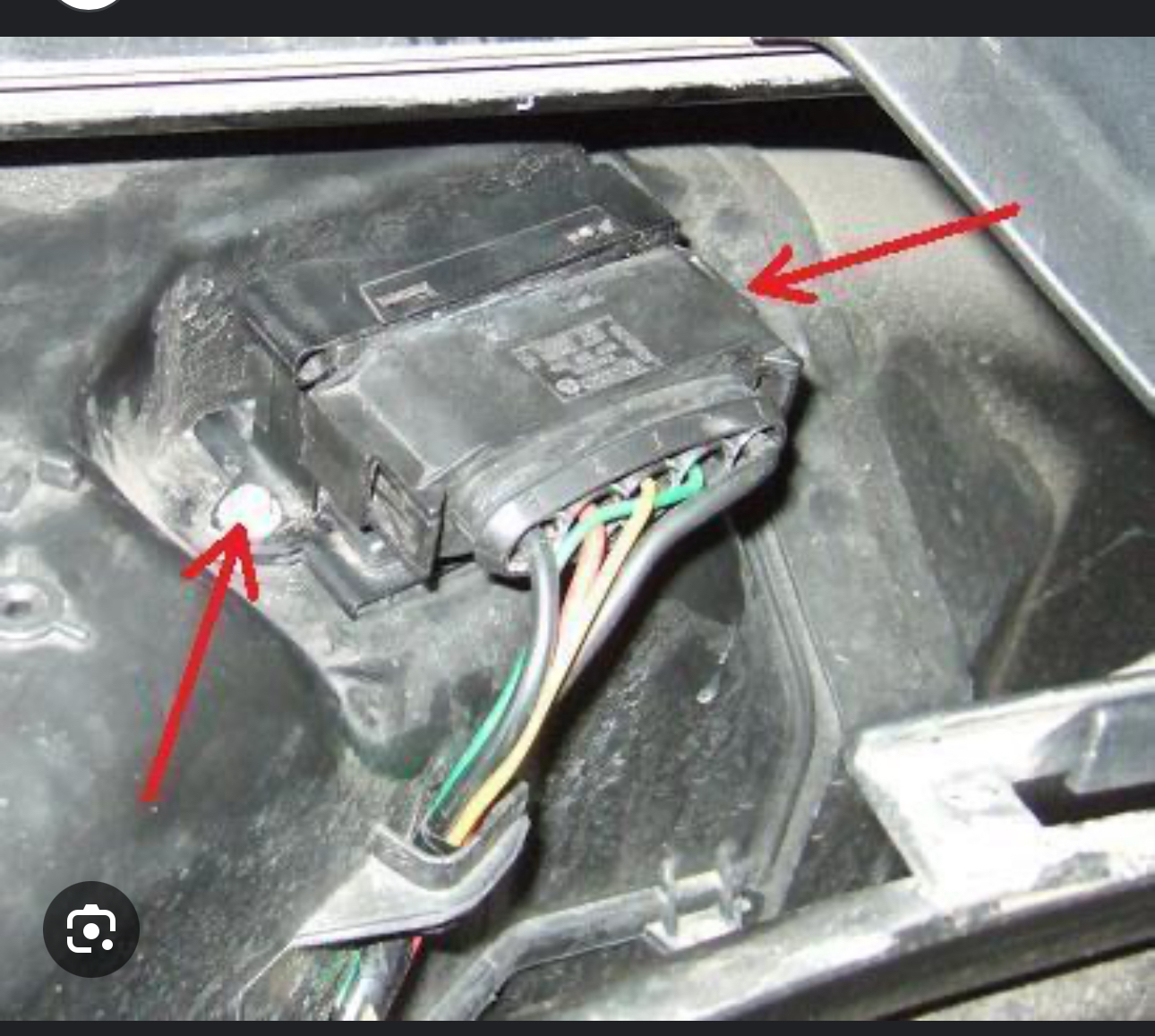

Matt Cup
  Iceberg 172 Cup
This is the resistor location.

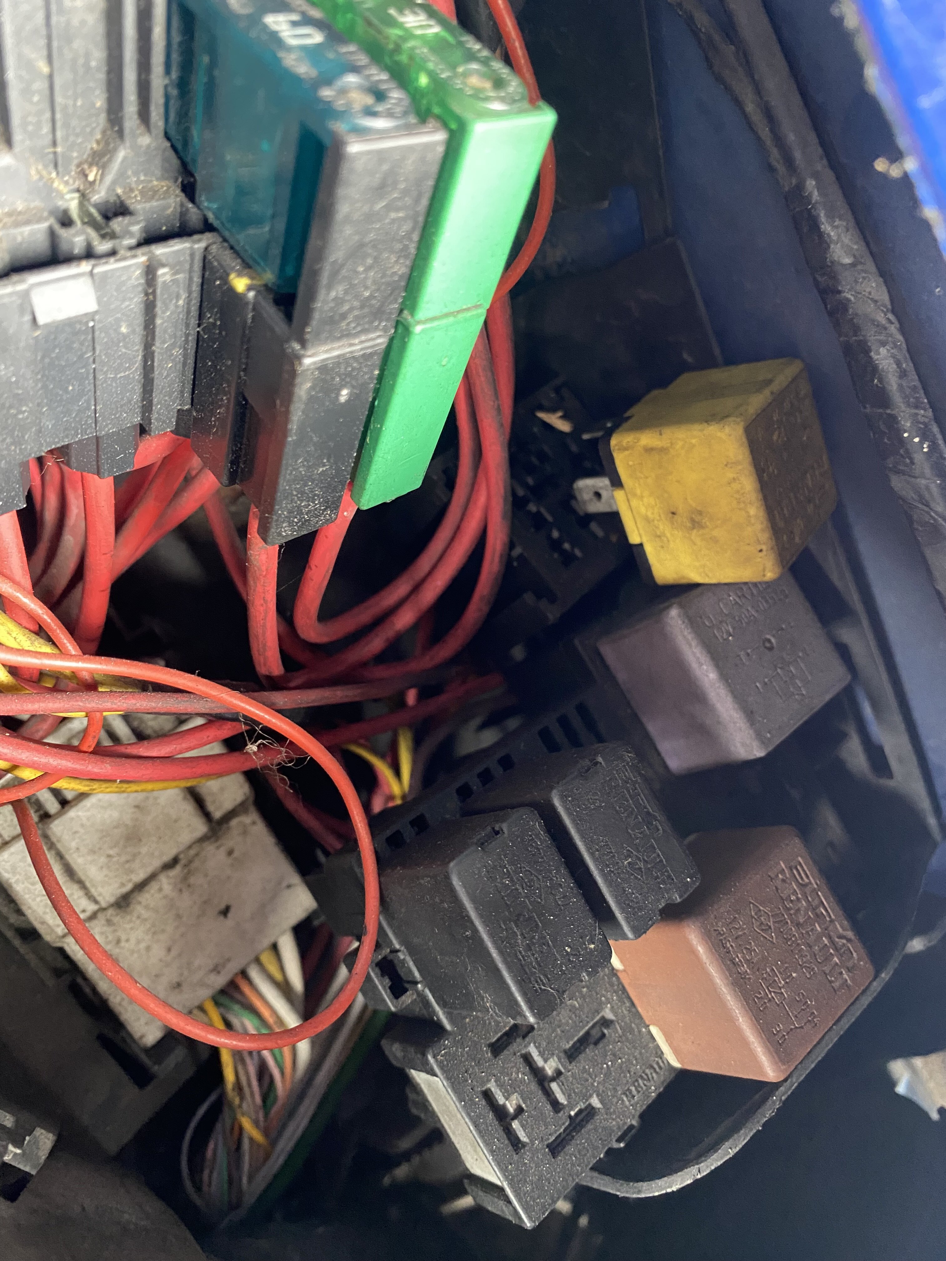

ex-Chinese Dave
All I can say is “FFS!”
Took the cover off the fuse box and checked all the fuses. Then I noticed this little friend sat as it is in the photo. I plugged it in and guess what?
ex-Chinese Dave
Why would that yellow plug be sat like that? Was the original fan dead and the previous chap has unplugged this ready for the new fan to be fitted?
