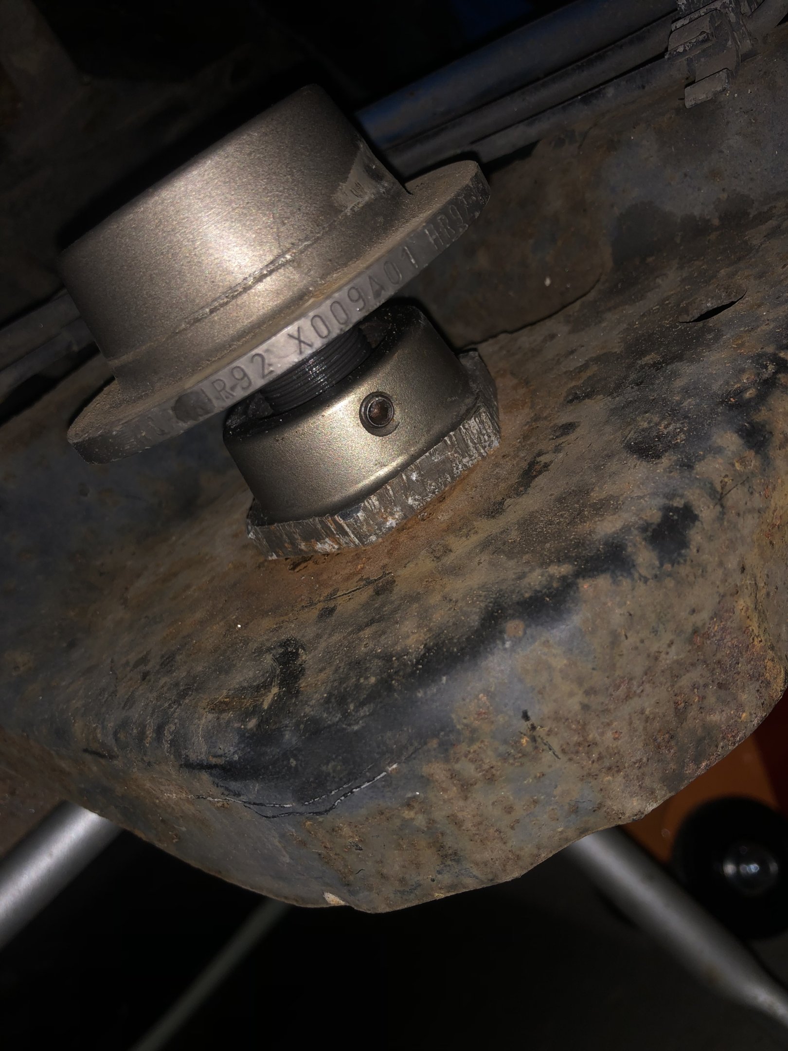

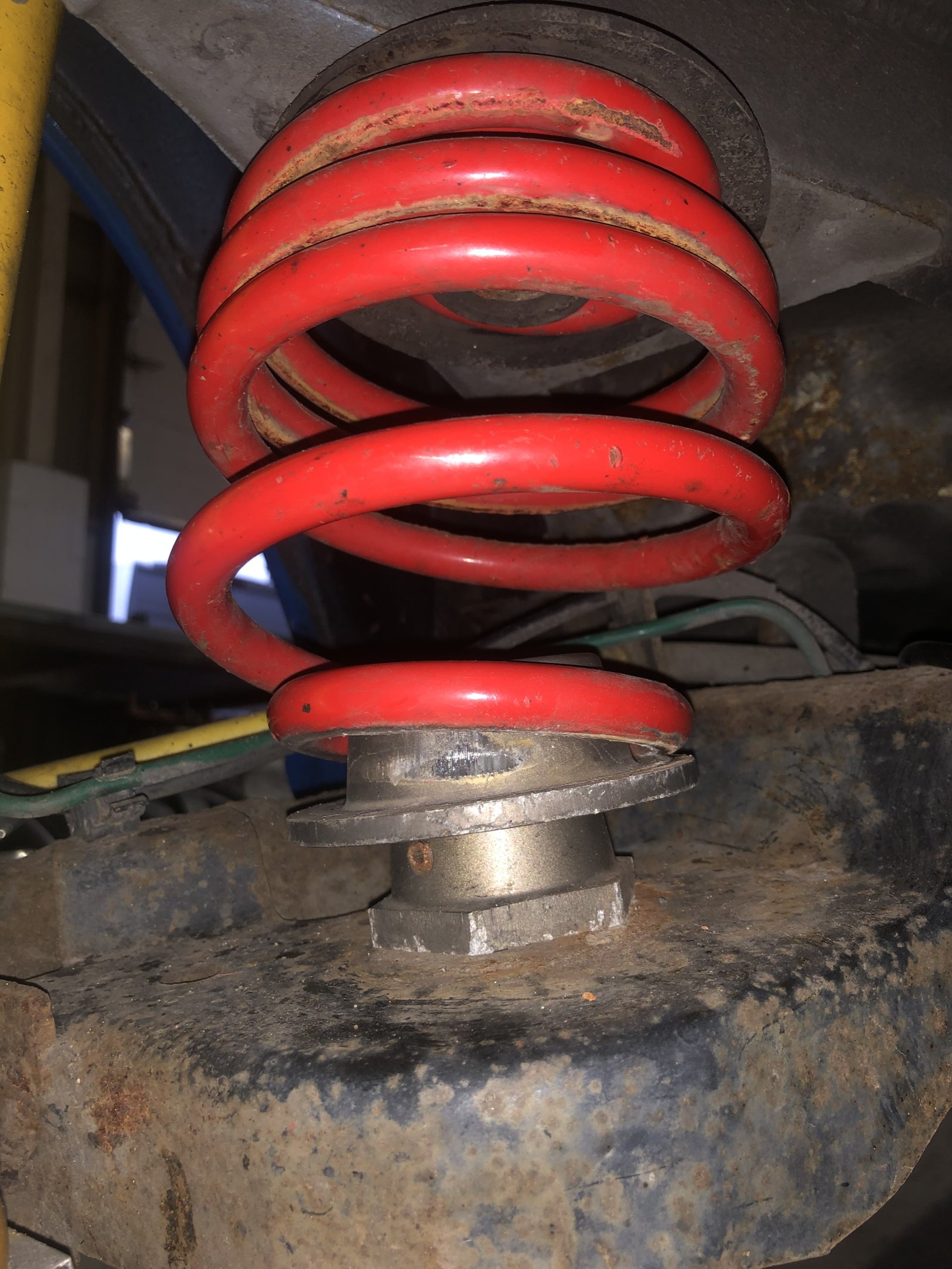

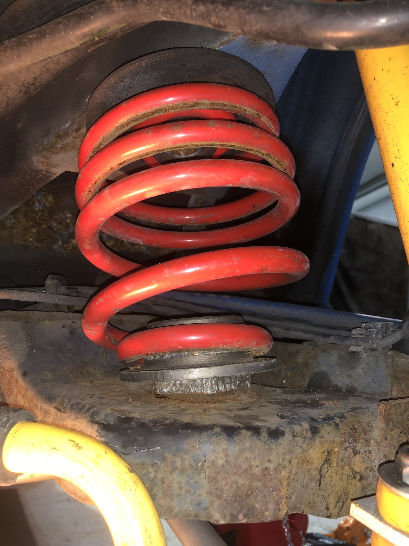

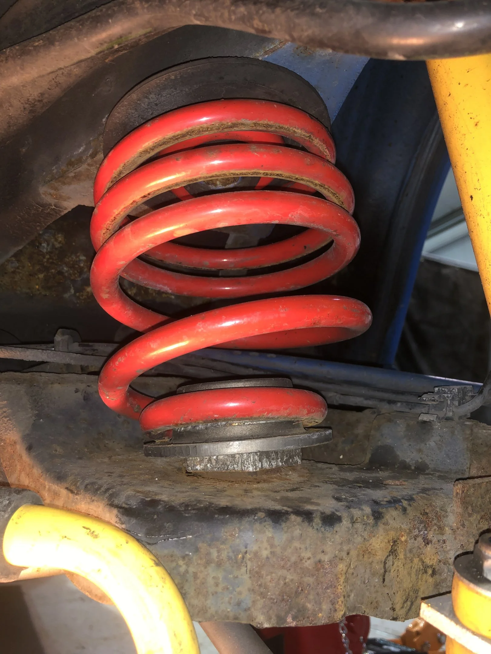

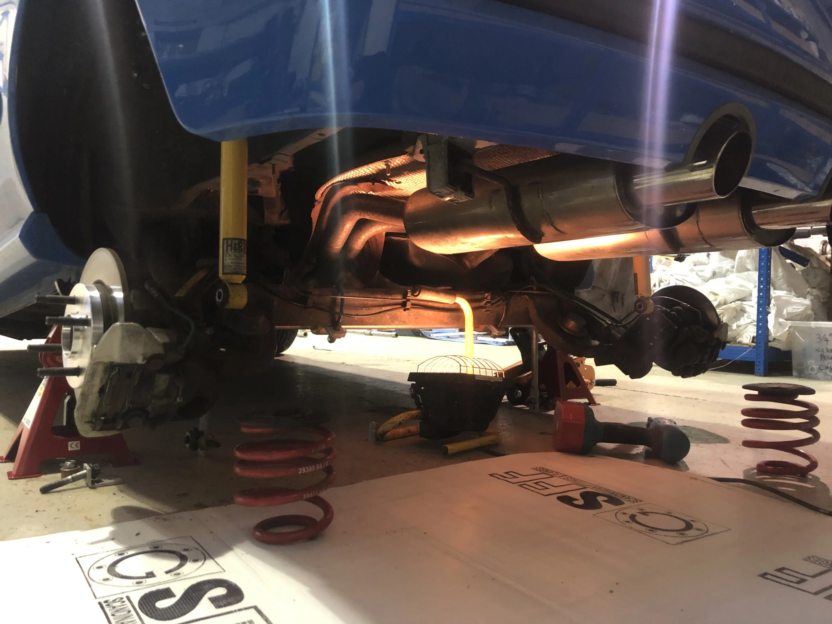

The right side lower spring perch needs tightening, hold the big nut on top and there should be a lower nut under the rear beam to tighten.
You adjust the height on these simply by turning the round top hat clockwise or anti-clockwise.
But then how do adjust?

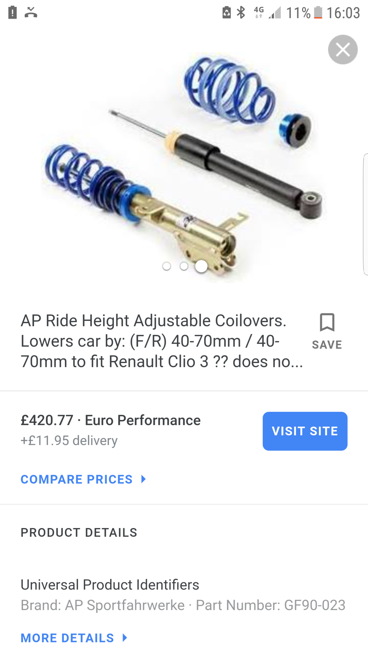

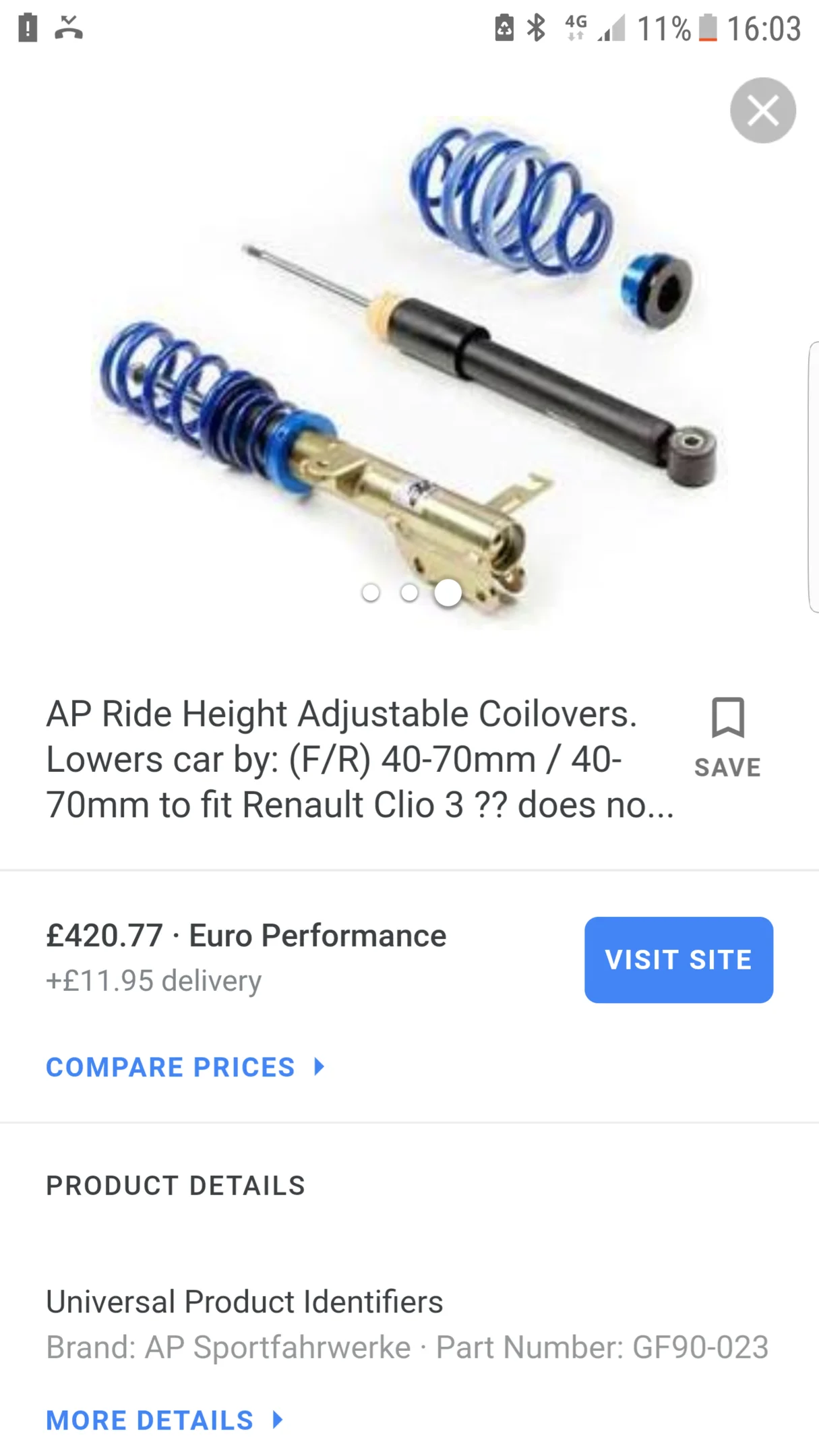

Are these just the springs or a brand new coilover setup because they should be a adjusters that sit in the top of the spring I've removed mine to make it lower but fails MOT for being to low haha and no worries
Look at the spring on the far right it has a blue adjuster cup on which adjusts ride hight that's ok my coilovers anyways not sure if yours are the same

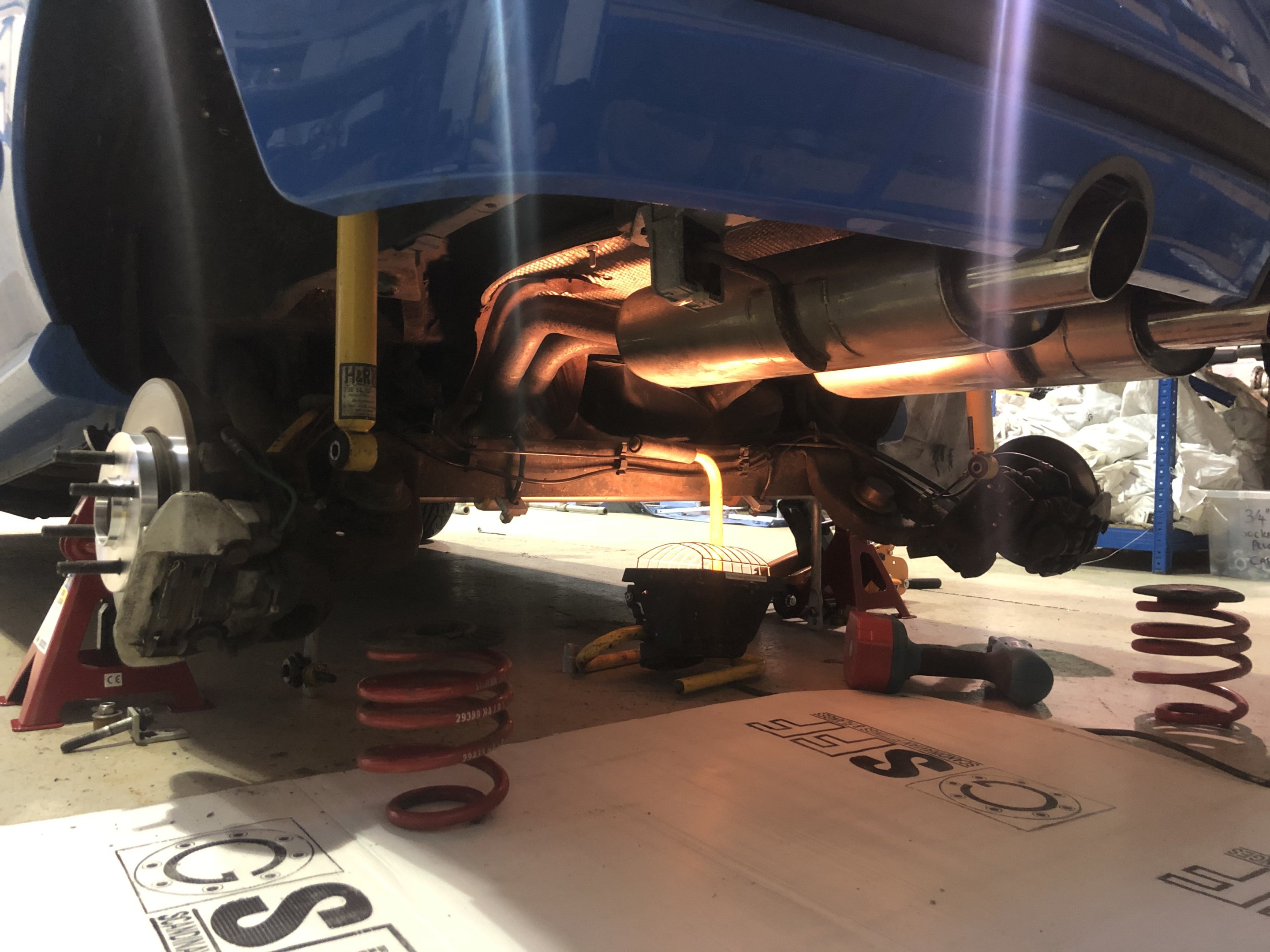

I’ve got the ump n dropped the whole rear to start again lol

I’ve dropped beam, I will show you what I have

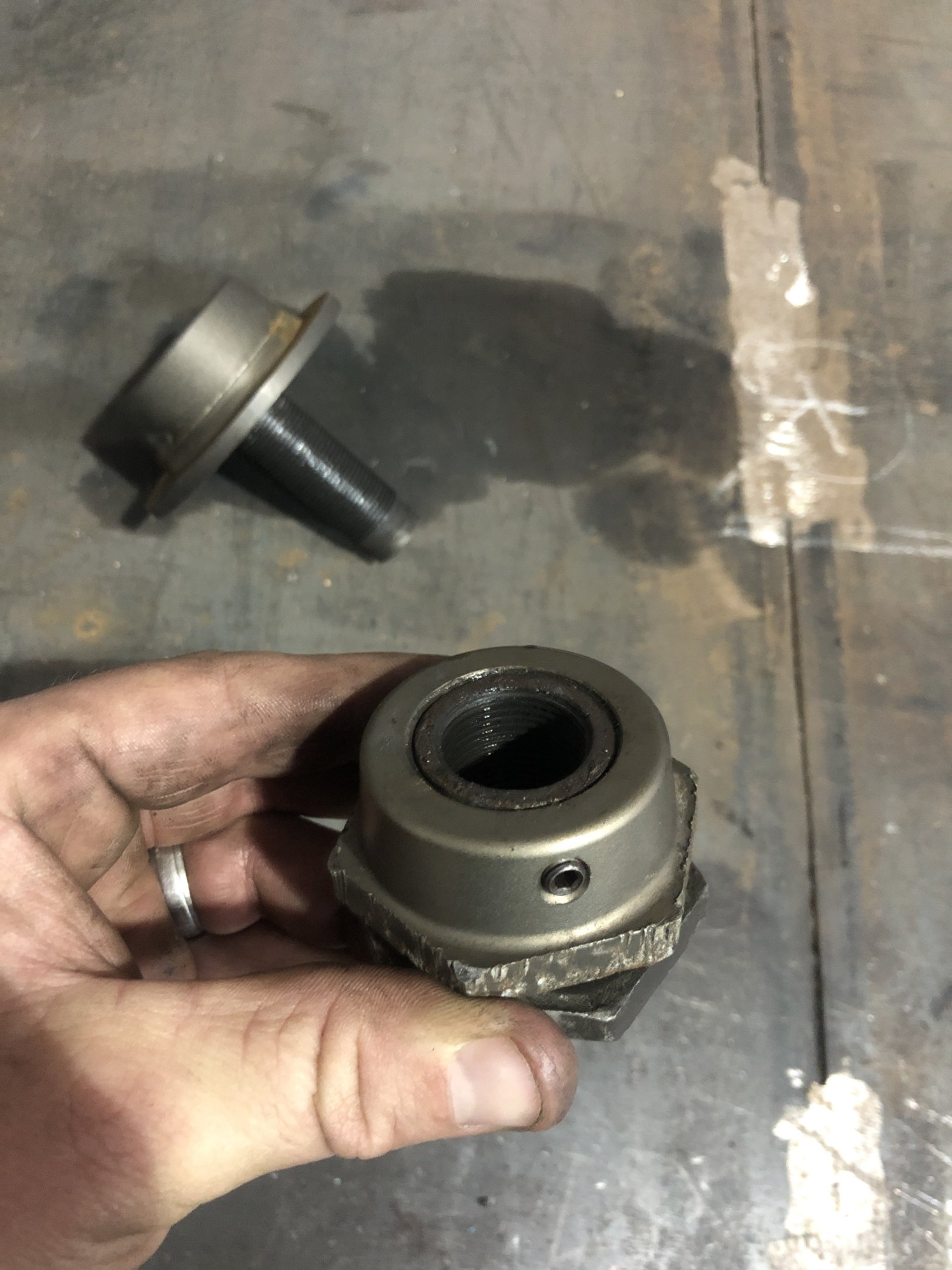

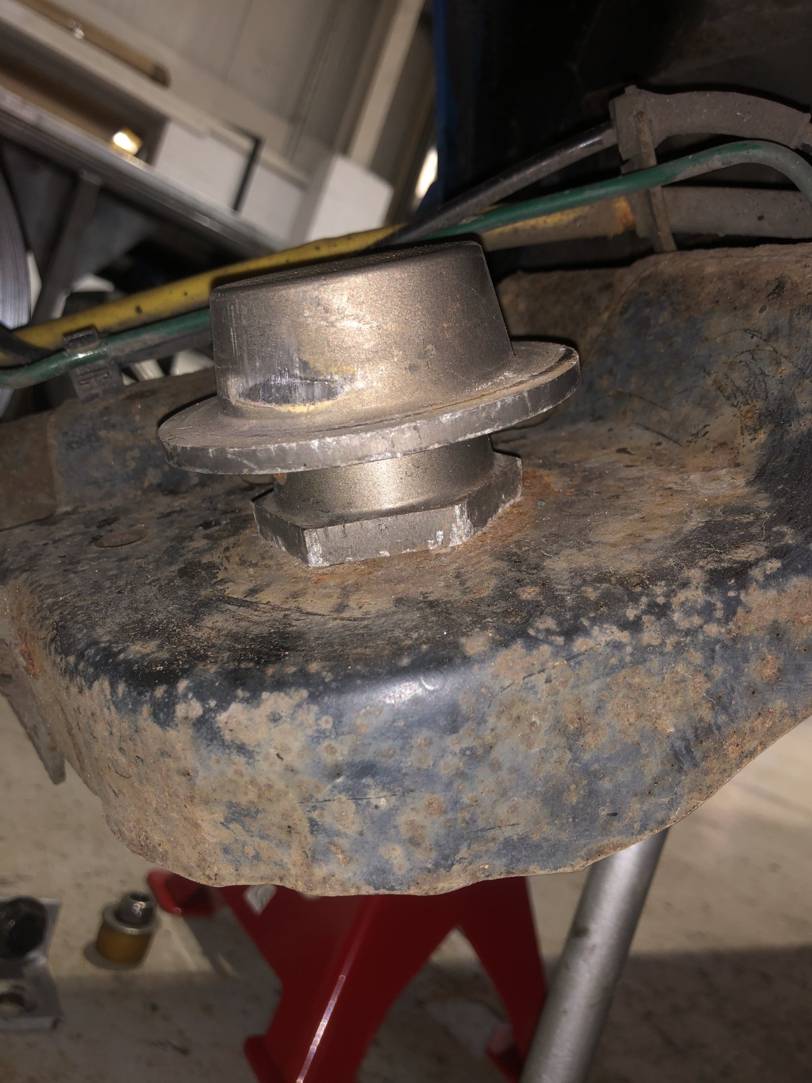

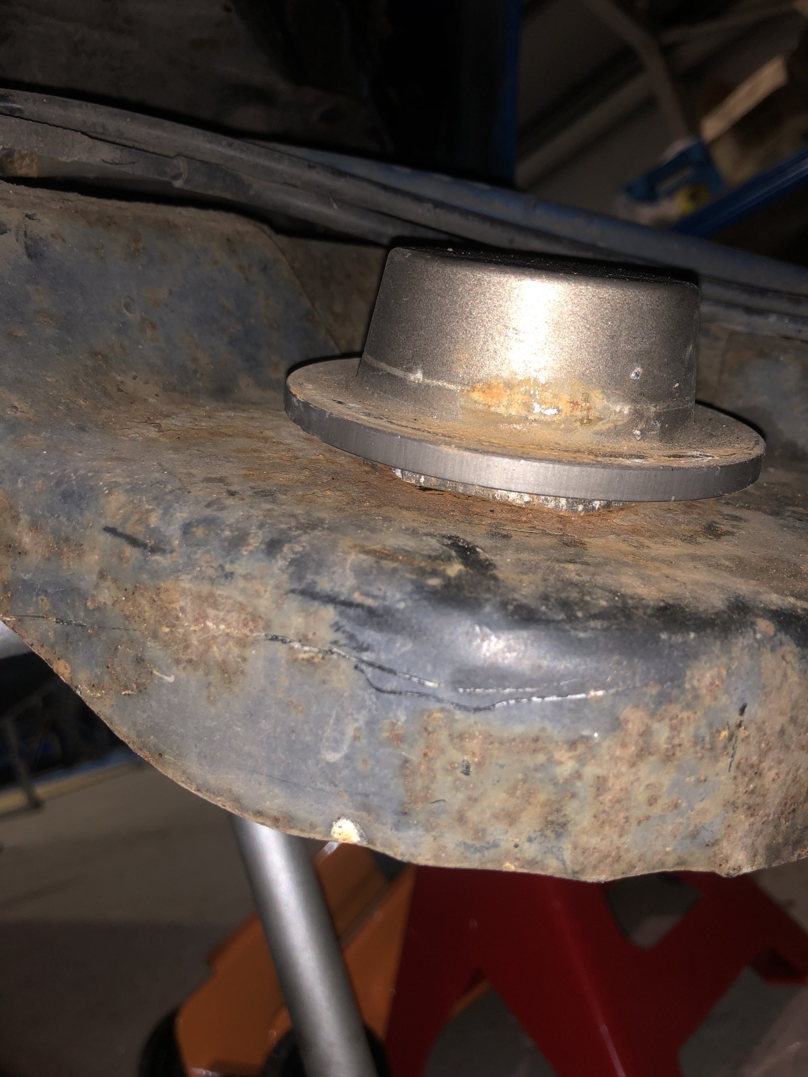

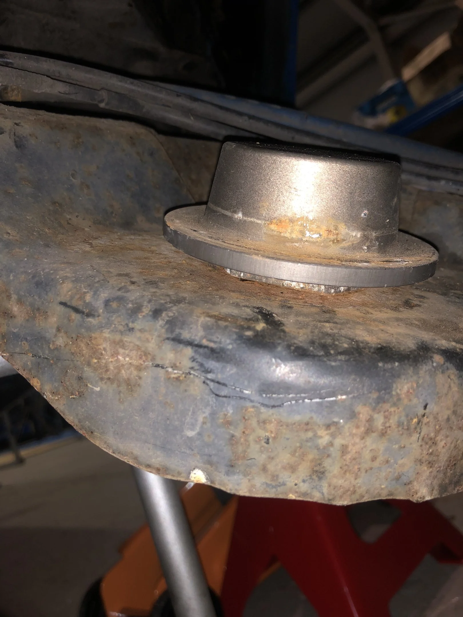

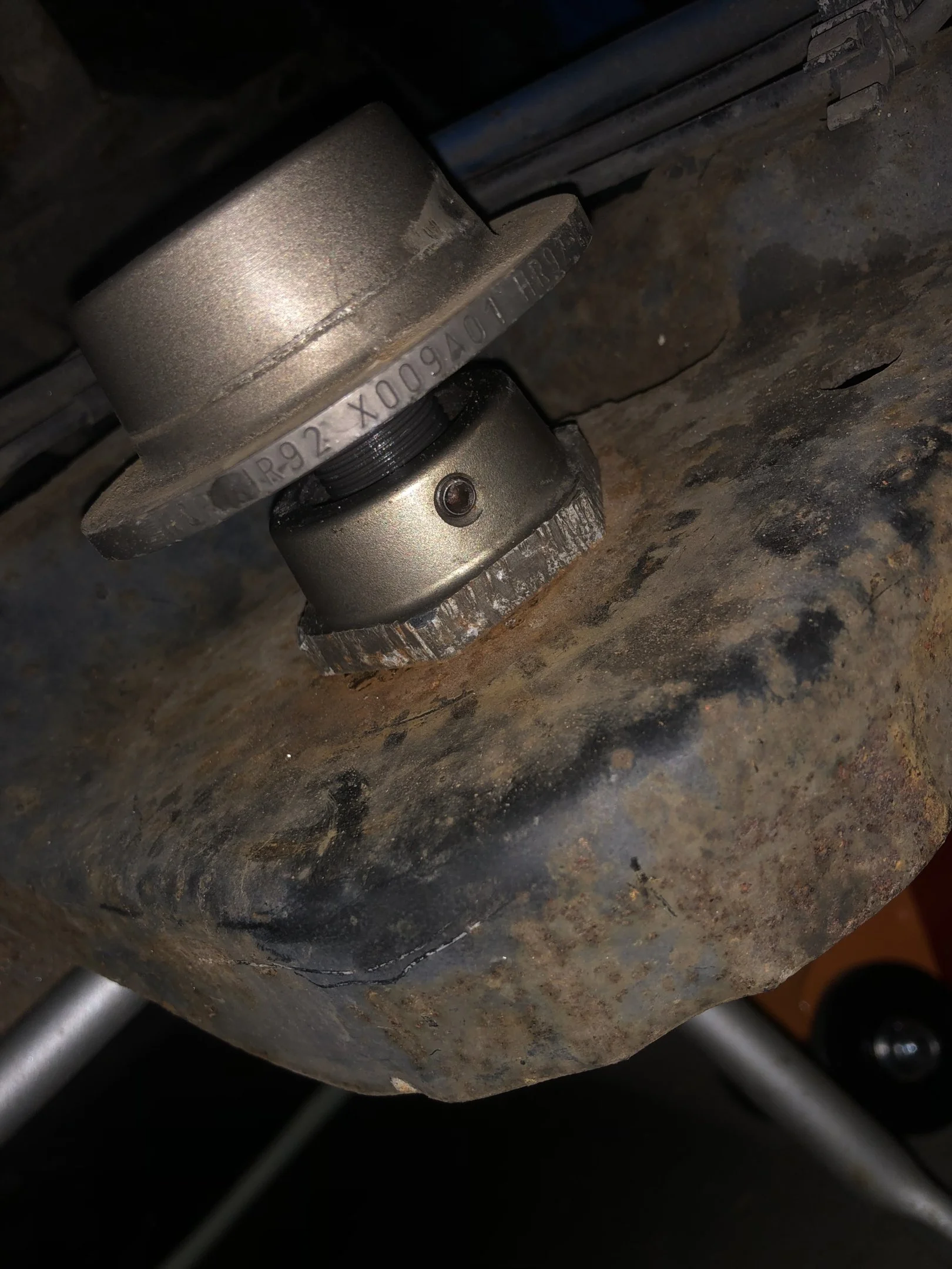

First pic is left which you said was ok
Next 2 pics are of how it was then I spun top hat
YOU THINK ITS COZ ALLEN KEY WERNT DONE UP???

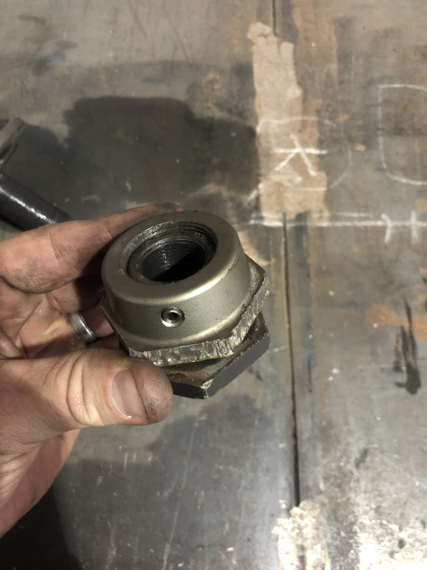

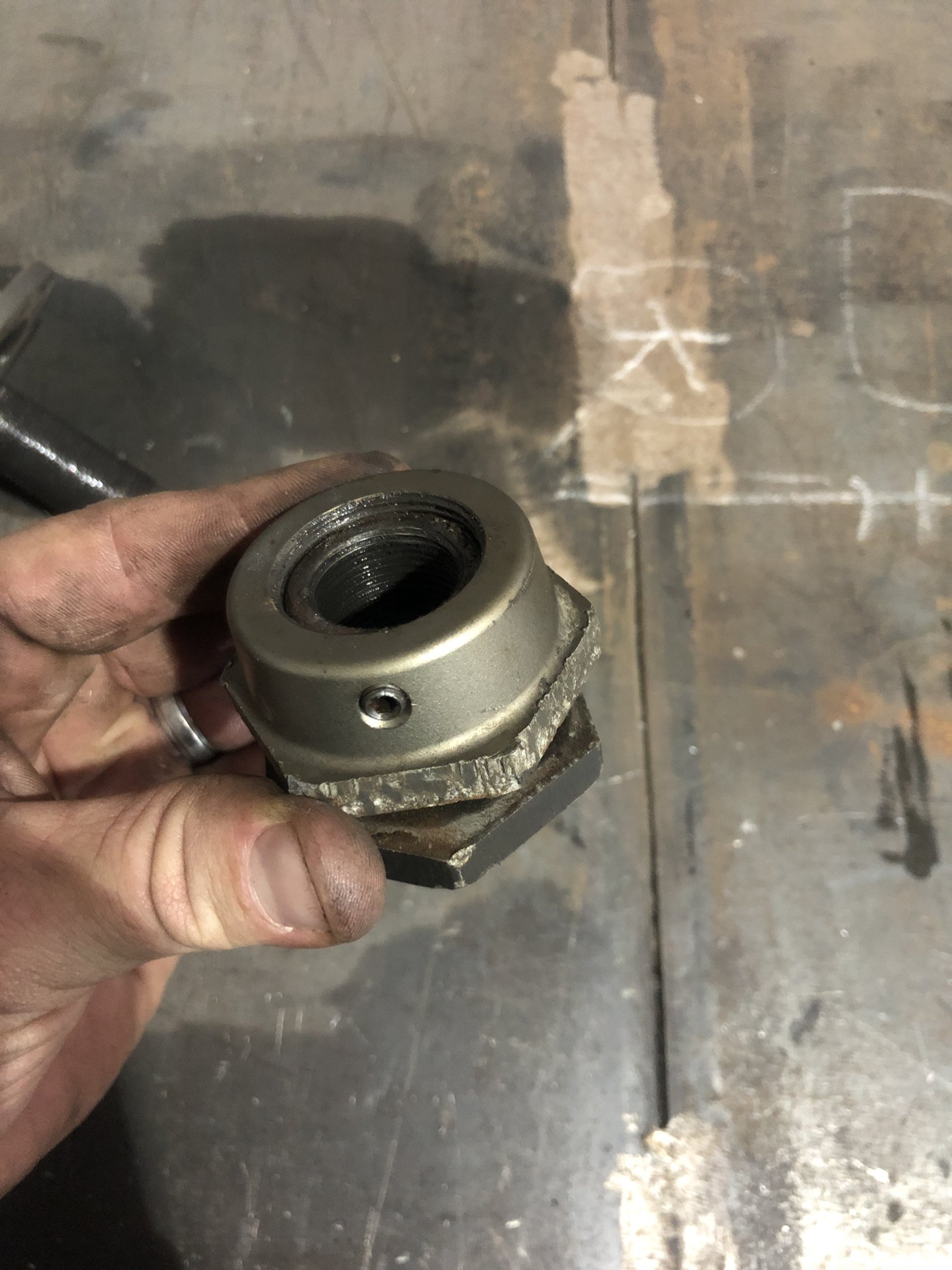

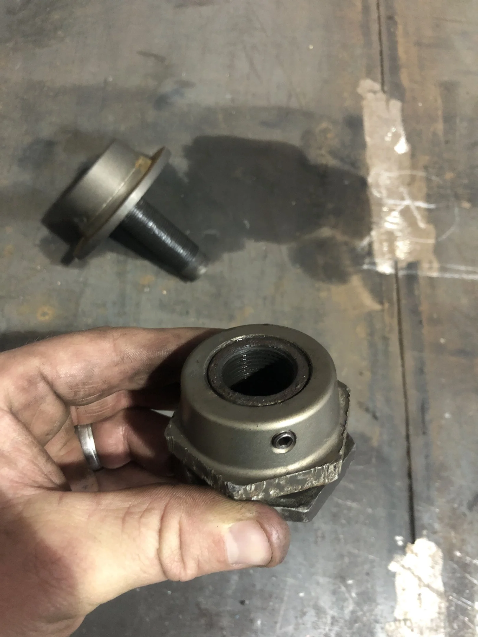

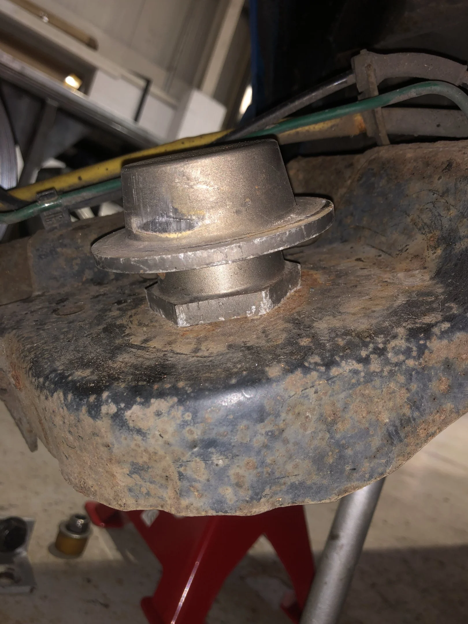

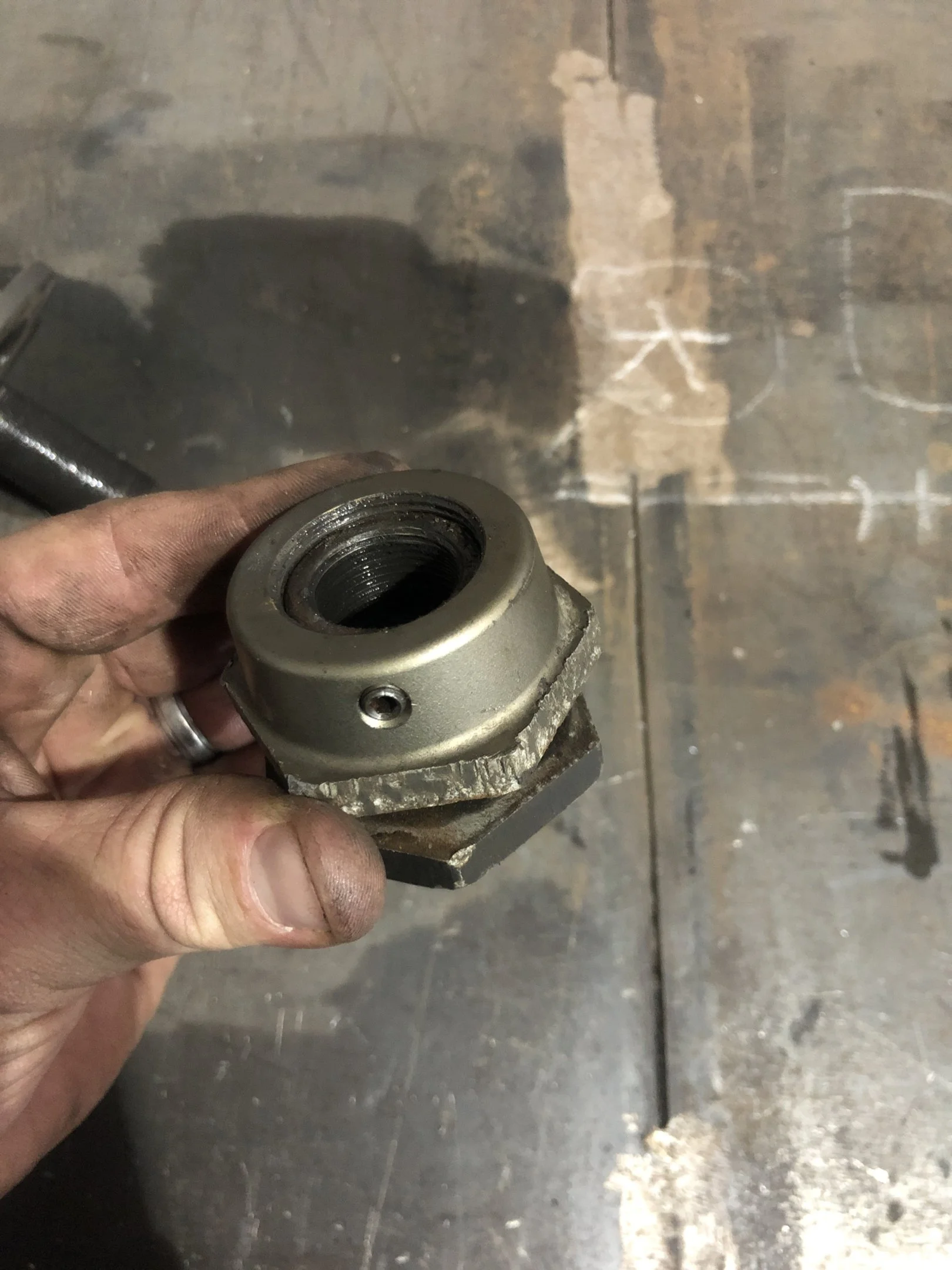

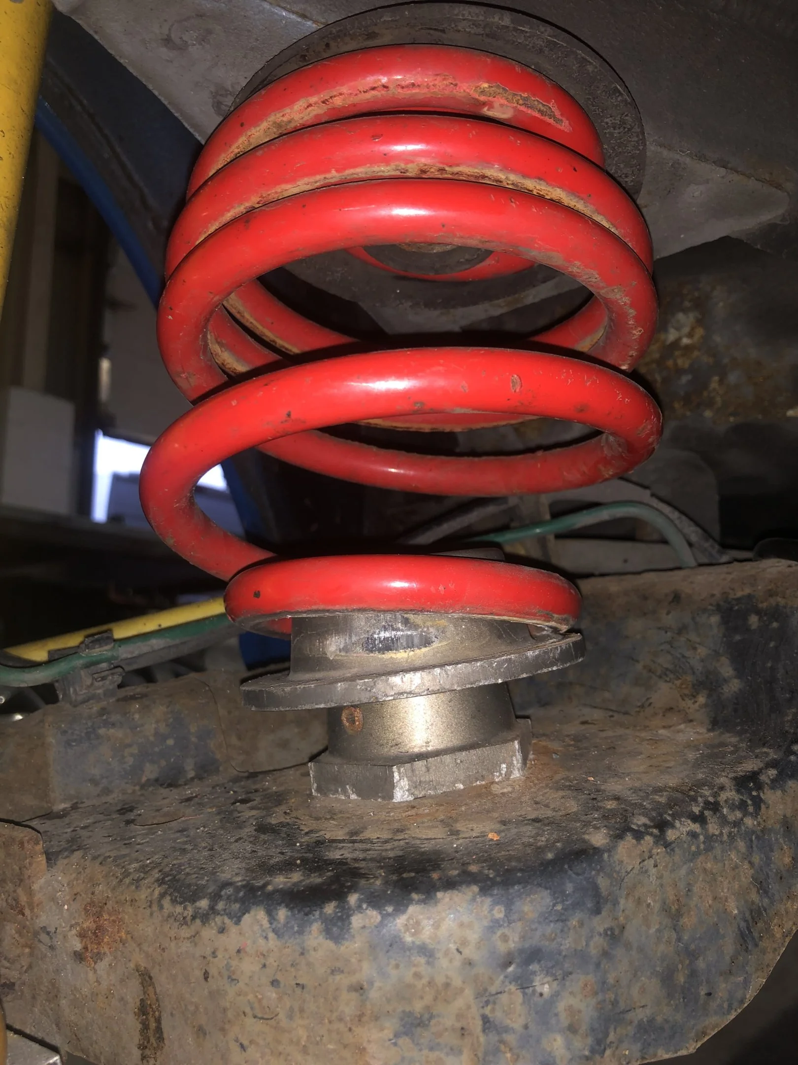

IT WAS FITTED INCORRECT
SO FIRST PIC IS HOW IT WAS
N THEN NOW HOW IT SHOULD BE
AGREEDED?

Yeah the bit that sits underneath the beam needed tightening up so that either side clamp to the beam.
It’s hitting the weld on the beam so not sitting square that’s why
