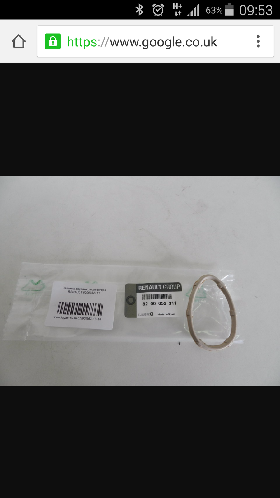

I had to investigate a similar fault for a mate a while back, turned out the egg shaped gasket between the upper inlet and the breather plate was missing, looks like this
Thanks guys, I have replaced the gasket, but I'm guessing the plenum isn't fitting flush to the oil breather plate! Can the idle control valve not be swapped between inlet plenums? Thanks

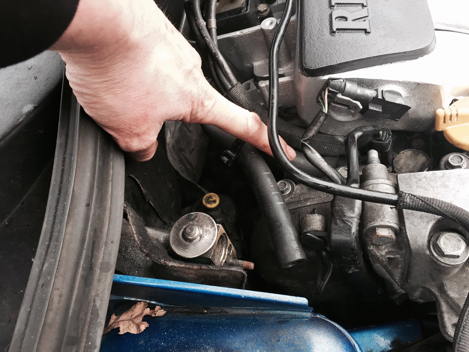

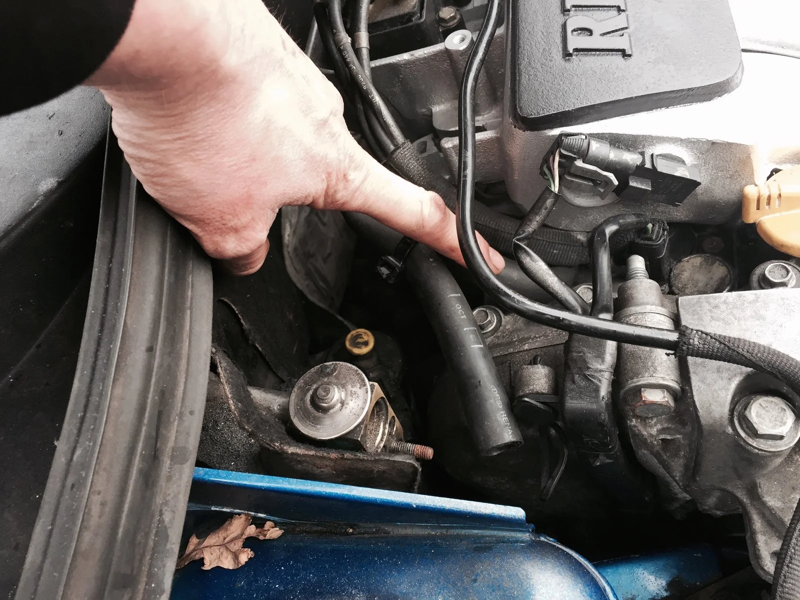

Hi all I have blanked off the breather on the oil breather plate as pictured below as this is a phase 1 172 breather plate which Ihave fitted to my phase 1 172 head on my 182, can someone tell me where this is suppoed be piped up too on a phase 1 172, many thanks
