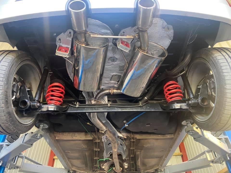

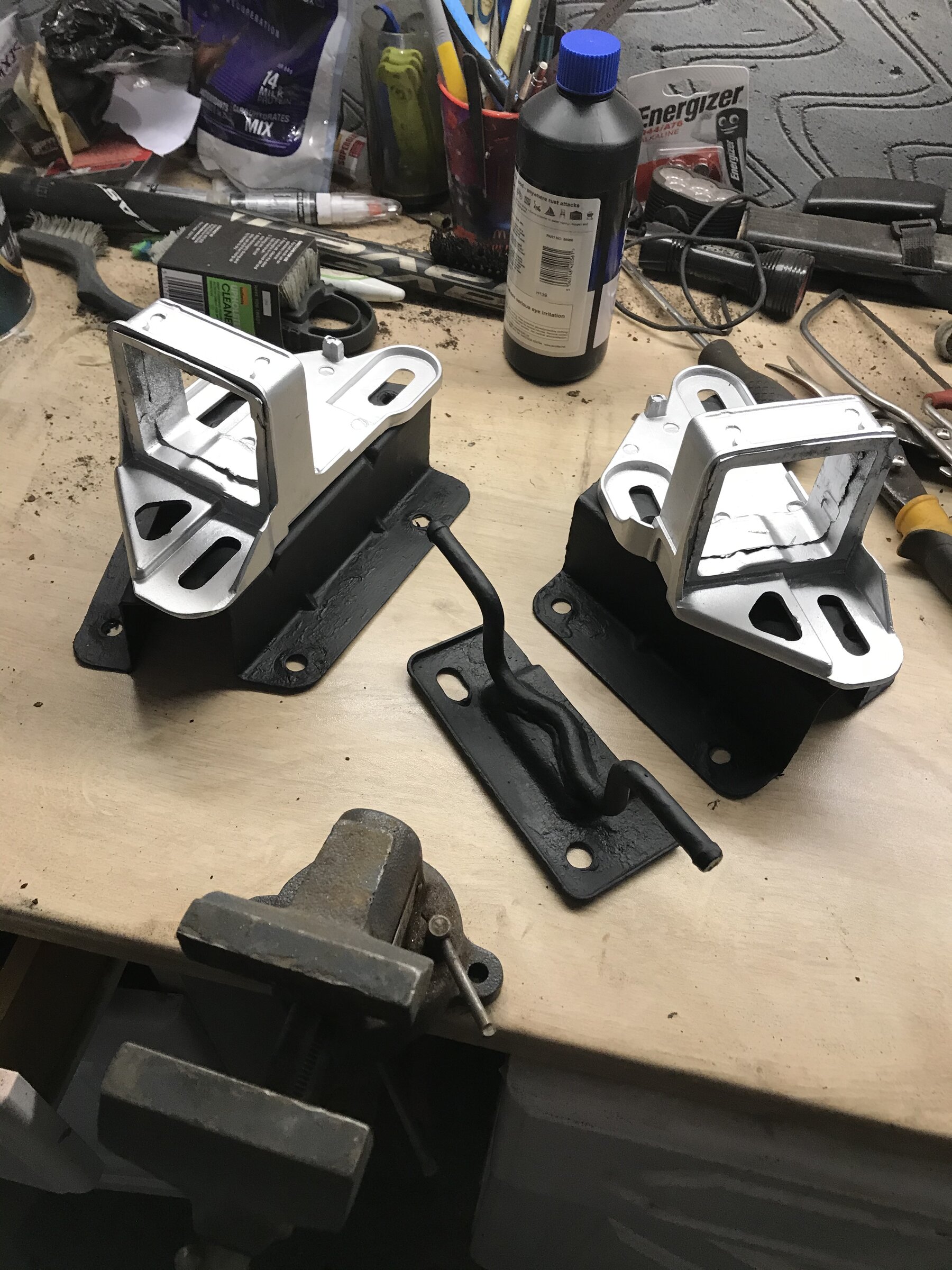

Which bits are you missing out of the above? There should be two brackets which bolt to boot floor, the 182 exhaust brackets then bolt to this. If you are missing the brackets that bolt to boot floor the Proam racing do some beautiful stainless versions which will be much better than the pig iron Renault ones
  BMW 120D M Sport
Thanks for your reply!
its the 2 brackets that mount to the boot floor that im missing, Annoying as trying to get alot done to the car today and didn’t realise these were missing as the exhaust that come on the car had done away with these 😤

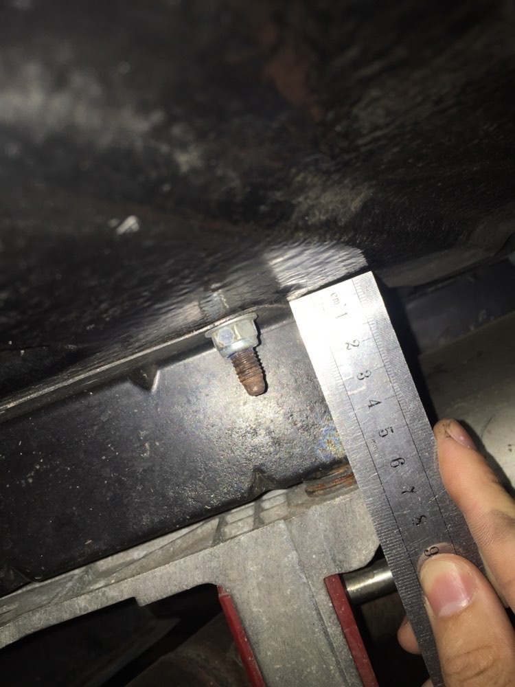

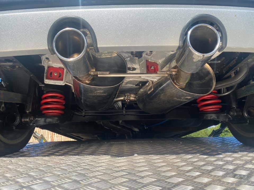

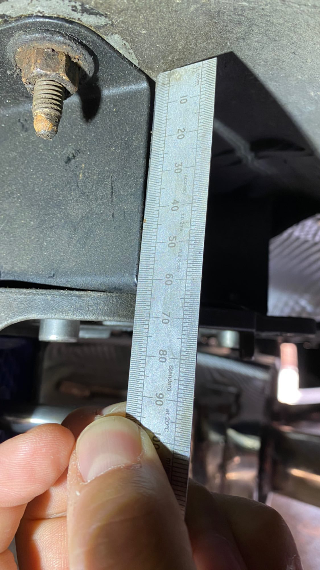

There was an Unknown change over of the exhaust brackets on the later 182s. Not sure exactly when or why this was but some 182s have brackets that are 54mm deep, others are 64mm deep. The Pro Ams are modelled on the shallow 54mm design and is why on some cars it can raise the exhaust by 10mm.
My car originally wore the 64s and now the ProAm 54s to tuck the exhaust up tight.
