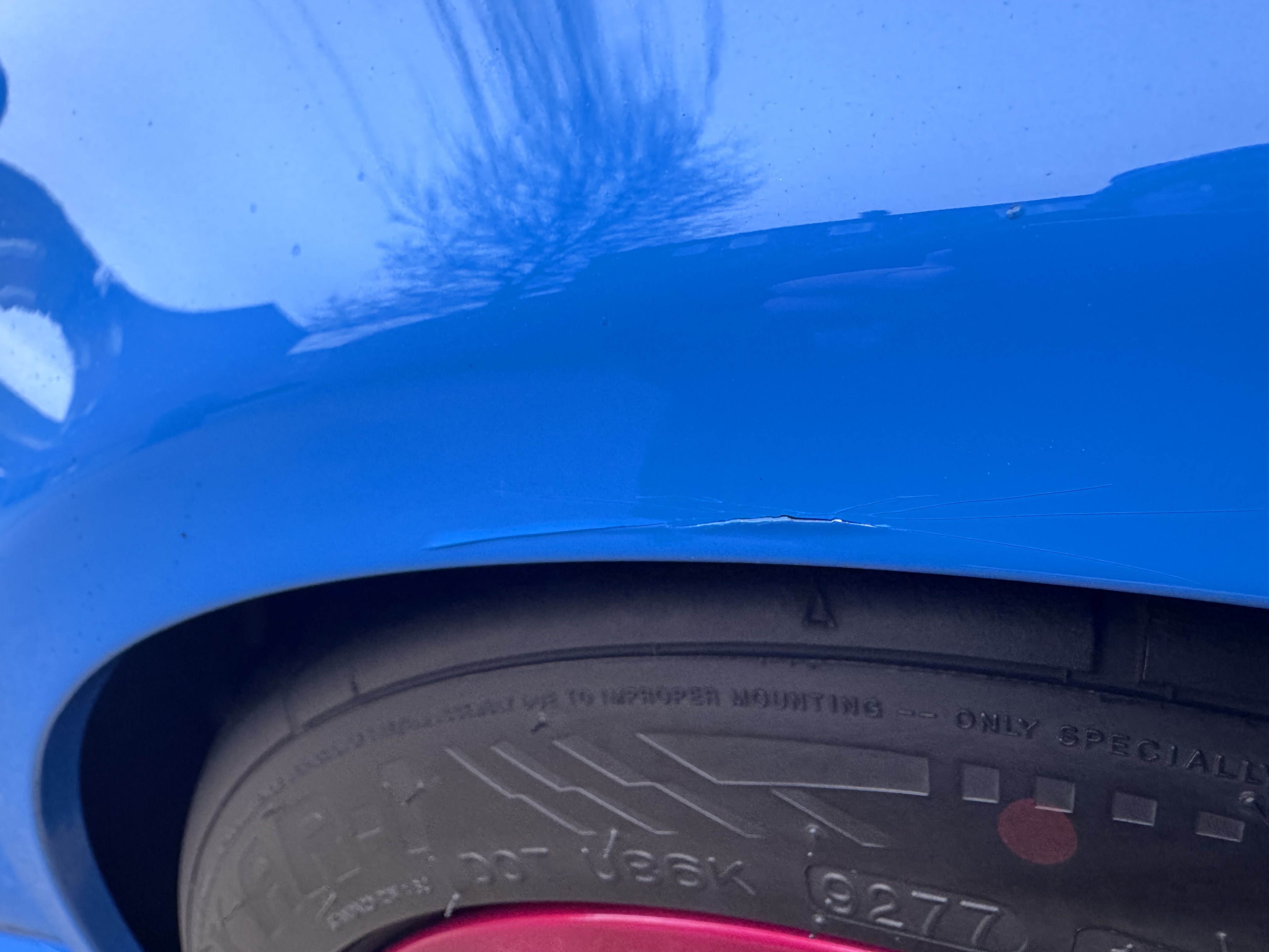

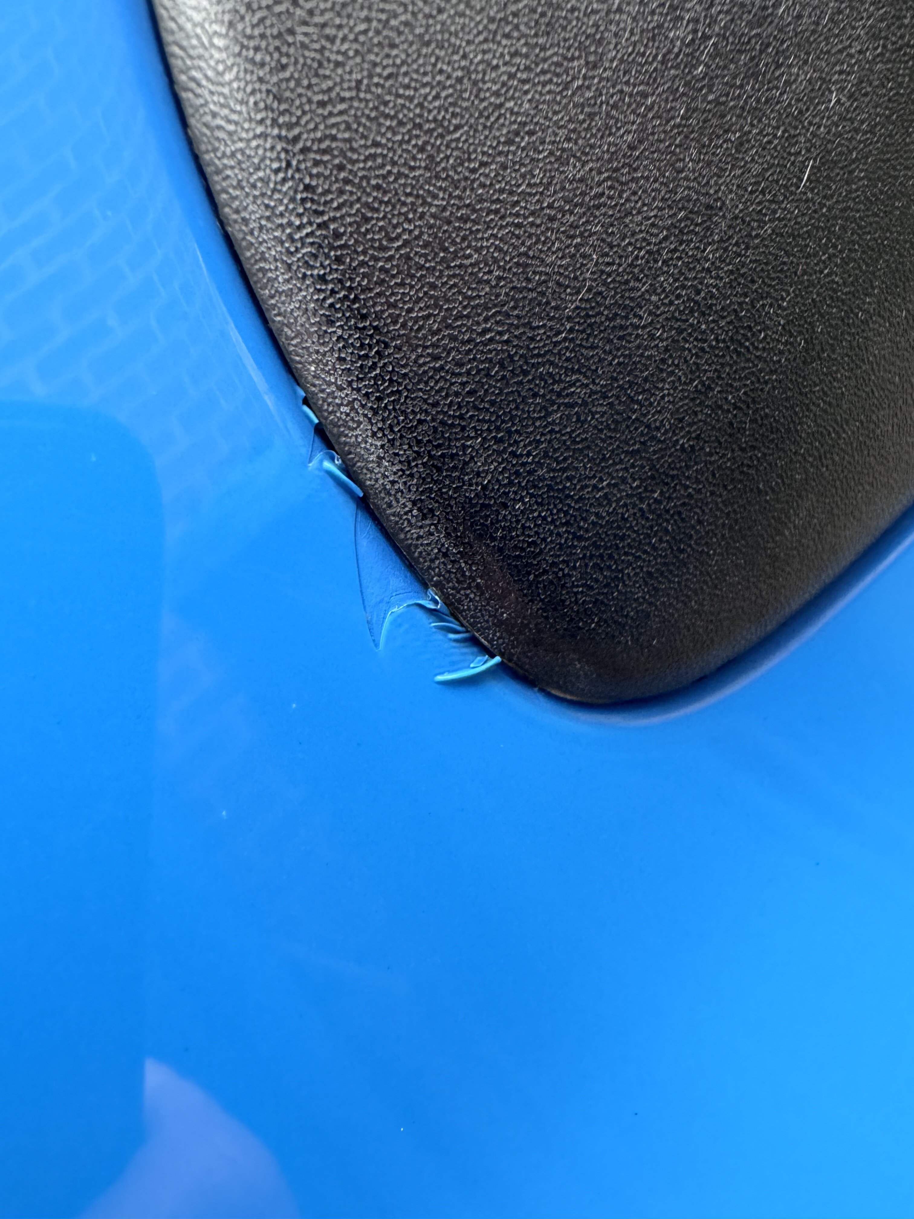

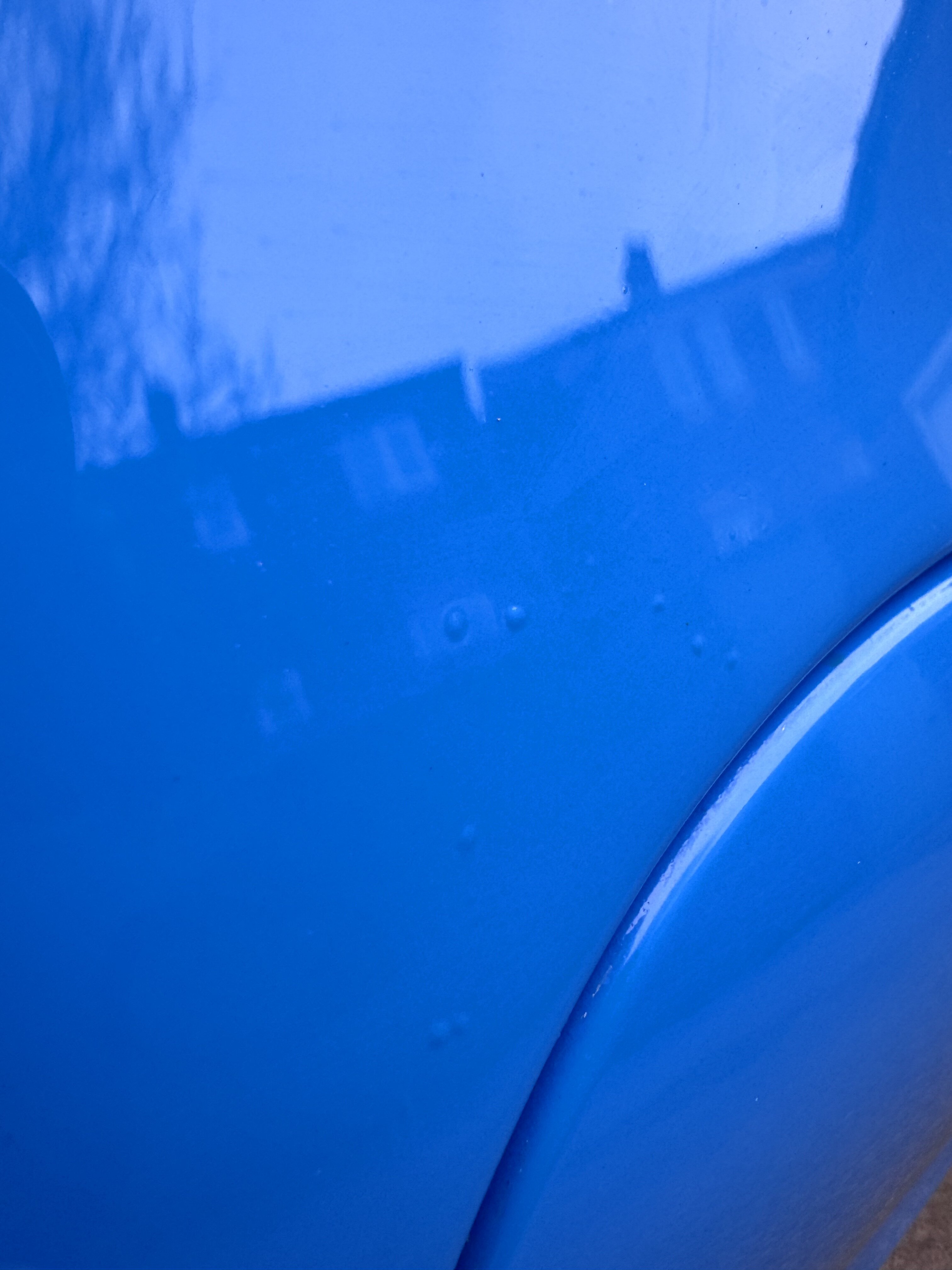

Now the bad bits. Either I didn’t spot this or I’ve been very unlucky on the drive home
The paint is not that good and I think that’s why I’m a bit annoyed. I expected it to be pretty much factory finish having a 6k paint job 3 years ago. There’s a lot of raised dots on the boot lid, roof and rear quarter.
Tom said he’s not noticed them before but knowing the attention to detail in the other thread I’m not sure how he didn’t
MAXRUNDOWN
Overall the car is really nice, I'd be more than a bit annoyed if the seller has misrepresented it, especially if you've specifically asked for pics/info of 'the bad bits' , I'm not taking the piss here, but did you collect it in the dark?
Blisters in the paint looks like solvent pop, which is likely seeing how thick the peeled back paint around the black trim is.. that plus the cracked filler in the rear arch isn't going to be cheap to put right. Can you live with it?

Front wing will be easy enough switched out and the peeling paint could be built up and pretty much hidden. Is the bubbling limited to 1 area ?
Clart
The peeling paint actually looks a lot worse than it is. It’s a very small area.
The bubbling is 3 areas that I can see. I might get a quote to sort it out.

Is that paint or has it been wrapped? Not seen paint rip/tear like that before. If it’s paint I’m assuming it was put on while still to wet but would have thought it would have keyed to the surface better underneath. Also the bit with the bubbles is that all paint? Have seen paint react with filler before and cause bubbles, too much moisture or the dreaded r word.

Lovely motor. My understanding of the car is that it was used on track? I’d have expected worse than that, to be honest. Looks like the tyres bounced off a kerb and hit the arch. Fairly soft spring setup, so quite possible that’s what’s happened. My track cars were rough bodywork-wise but the fundamentals were always sound, which is what counts. If you’re tracking the car, just leave it as it is. Otherwise, get it tidied up. Nice purchase.
Clart
The wheel incident was before the rebuild , I think that’s what prompted it.
