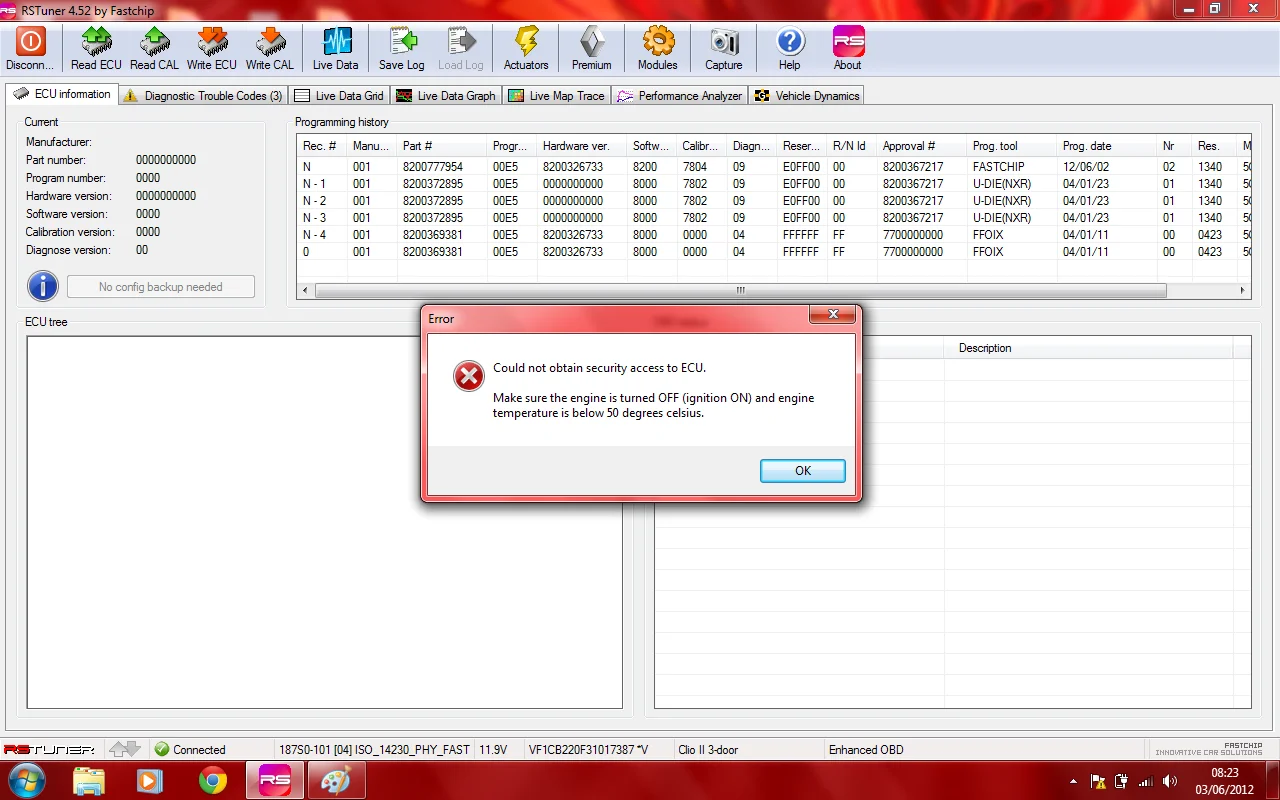

hey all , have a big problem , i have an rs tuner just tried using it for the first time on my 182, i have unlocked it etc,
so i read my ecu 8000 and cal files and saved them , then i clicked write ecu and picked the update file 8200 that was all fine everything worked ,
i then tried to load the cal overrun file which was sent to me by a richo a cs member , it came up with an error saying it did not write , now evrything under the ecu information is at 00000 value , car wont start , and when i try and write my original files or the 8200 file , i get acquiring security access to ecu , then it says ERROR , could not obtain security access to ecu, make sure the engine is switched off (ignition on ) and the vehicle temp is below 50 which it is ,
someone please help :(

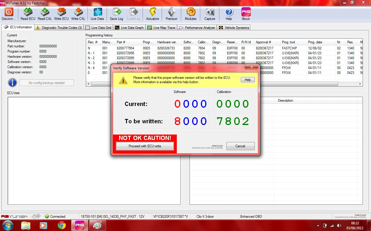

yes mate he kinda has the same problem but he doesnt have the security error problem , which is my problem i can't do nothing at all write or read ecu as it jus wont go past the security bit fails everytime , not sure whats up with it , dont know wether the overrun files i got of richo (which i actually paid him for ) are dodgy (not his fault im sure ) , all i get is when i try to put my originals back on , on the verify software bit is
0000-0000
8000-7204
NOT OK CAUTION
and then fails the security

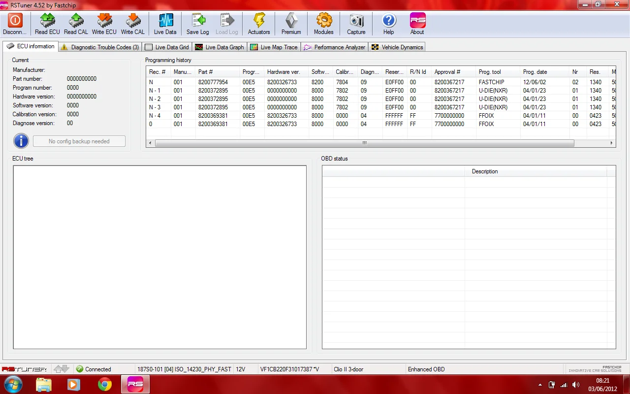

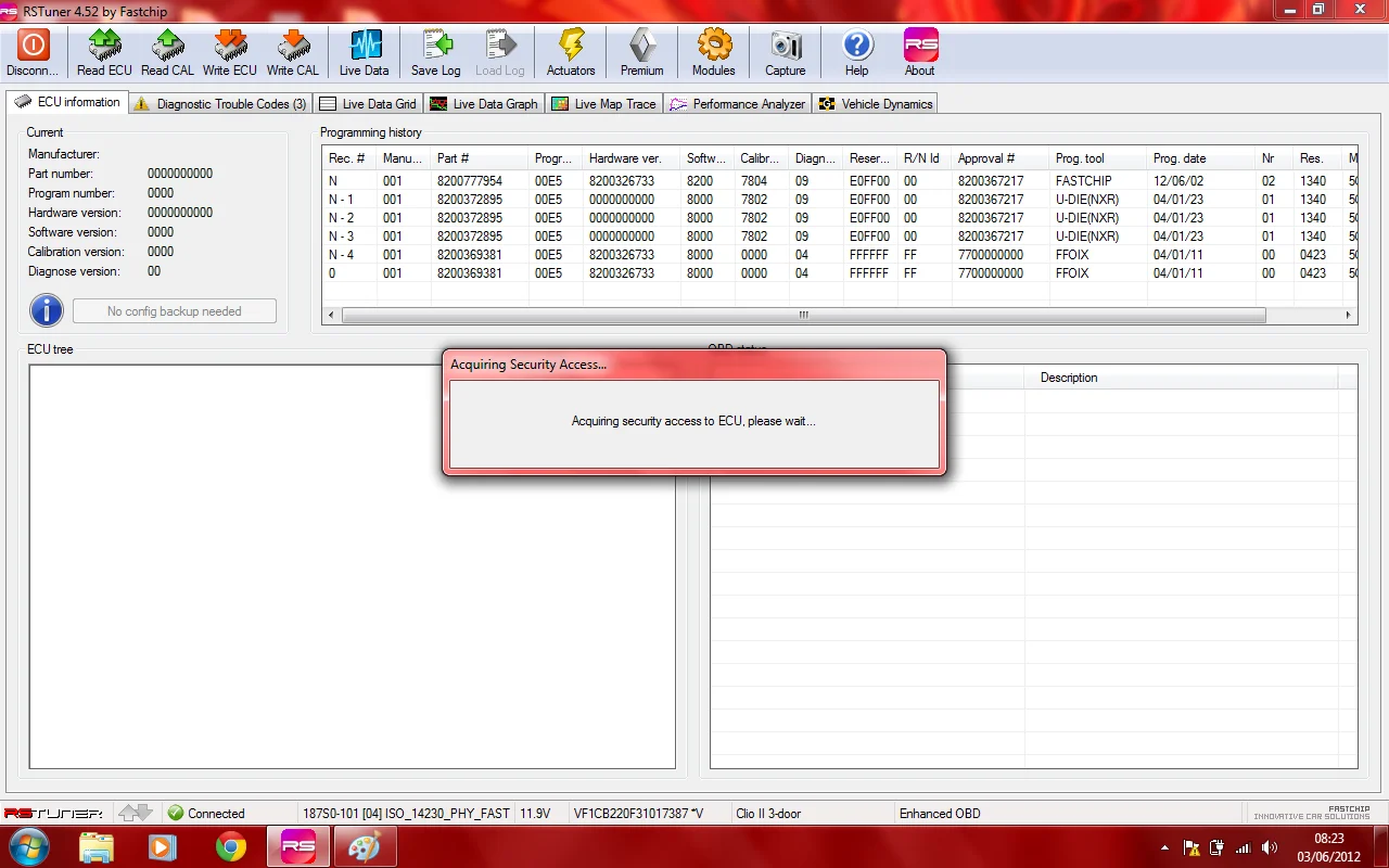

A few screenshots that i sent to henk :

I dont understand from your screenshots why it hasnt registered the update to the 8200 file :s.
Does this error message happen when you try to write a new rst. File?
yes mate happens when i try writing rst or cal or even readin rst or cal (even though there is nothing to read lol ), If you look in the programming history part on screenshot 1 , you can see that it did register the 8200 rst , but then on tryin to put the cal file on , right near the end of the progress bar it came up WRITE VERIFICATION FAILED and then it all jus went wrong and did everything shown in the screenshots
