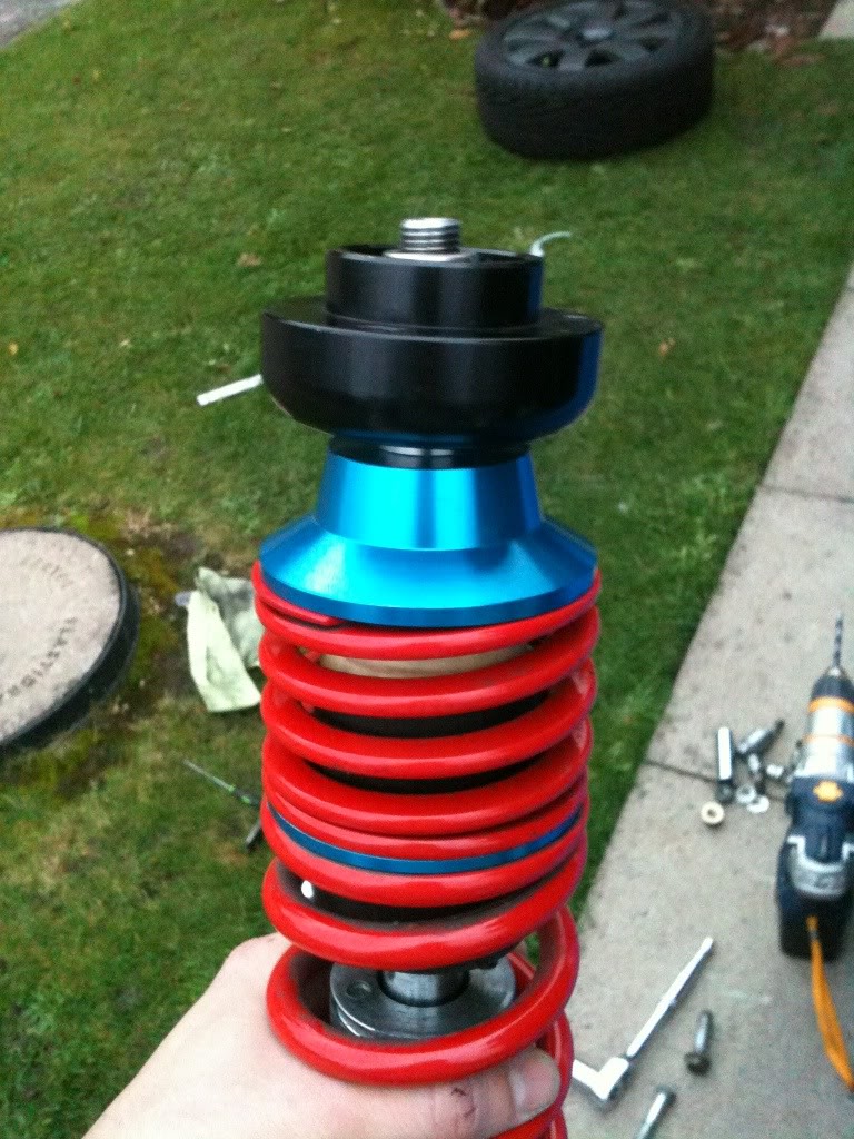

Hi there!
Time ago i’ve bought K-Tec Racing solid top mounts kit for my clio sport ph2. Since I assemble the kit in my car I’m experiencing some creaking noise from the front. It seems like if a part its missing because I see a little bit of play between the mount and the “top mount bearing”. I attach you a picture from my coilover suspension kit, with the k-tec mount. It’s possible to solve this issue? Is it wrong assembled?
Thanks!
  182 cup
1st thing that strikes me: why have you got the oem bearing in there? The K-tec mount has got a spherica bearing to replace it.
2nd need a better pic of the mount to check thet you've got the k-tet spacer and nut in.
  182 cup RB
You need the silver spacer bit between the blue bit and the top mount! The noise will be the top mount moving on the old bearing
