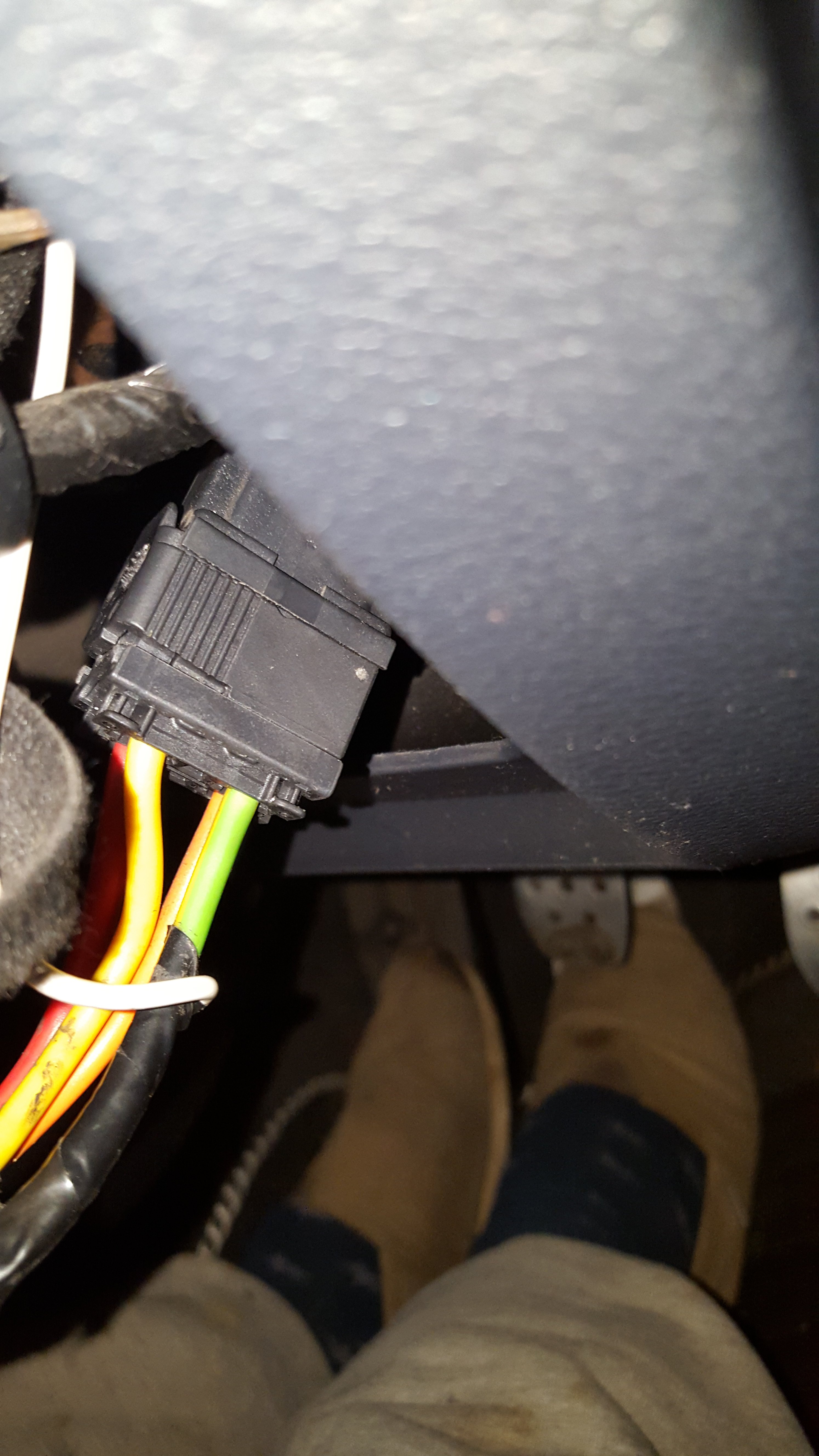

help undoing this connector
cs_dave
West Midlands
I cant get this undone am i missing somthing?
  Clio 172 Merc ML55
Slides out to the left as you're looking at it, they are tight but if you pull where the ridges are it will come apart, as it loosens the plug will start to drop as it's got a groove inside to make sure the pins align properly

Sorted thanks
