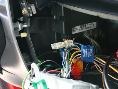

The metal tube your on about sounds like the female part of a bullet connector. Crimp a male bullet connector onto your amp cable then push it inside the headunit cable. Wrap some insulation tape around it while your there too.
Not the best pic, I just took this off google. Basically a blue / blue and white wire with a metal connector on the end with rubber around it.
ive got a song xplod, there should be a wire with amp written on it, its definitely blue might have a yellow stripe down it though. Thats where you remote cable (the small blue one) attatches. simples
