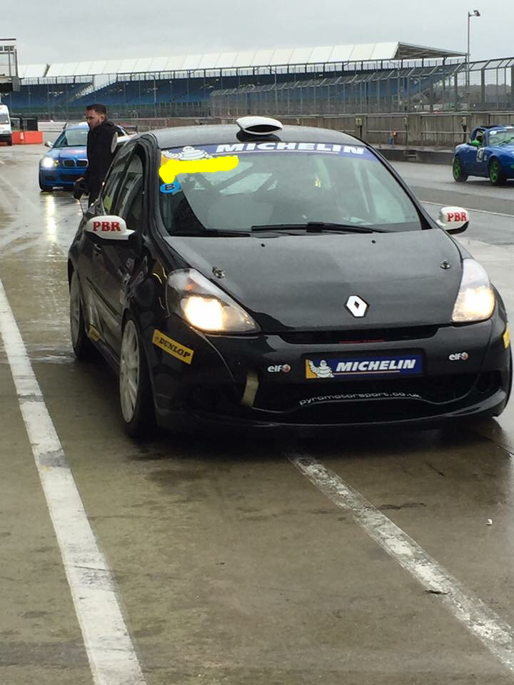

Right car guys need some help / advice on Clio Cup Race Car, need to get more power from it, people have said you can tune it others say you can't, it's a fully race spec car thats used in the support races with a Sedev sequential gear box just need some solid proof of anything can be done. The race series allows 260bhp per ton we are at 206bhp we are currently up against Ford Festas STs which are running close to 260bhp, we can keep up fine on the corners etc but soon as we are on the straights they pull away and we run out of puff, anyone got any suggestions?
Many thanks
